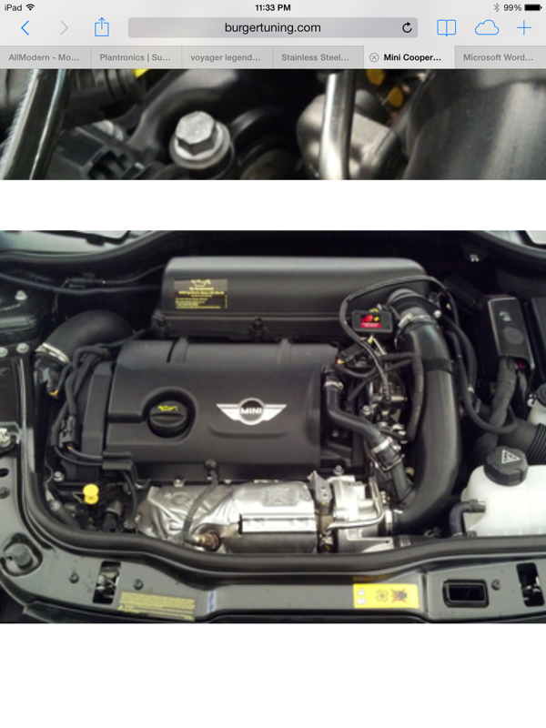

Hey guys,
I'm just about to install the JB+ on my '13 JCW Hatch, but just wanted to confirm that the sensor I found is the right one. Is it on the left (passenger) side sitting right on the top of a pipe that leads from the intake?

Hey guys, I'm just about to install the JB+ on my '13 JCW Hatch, but just wanted to confirm that the sensor I found is the right one. Is it on the left (passenger) side sitting right on the top of a pipe that leads from the intake?
Should be closer to the drivers side. See photo.

Found, got it on. Thanks for the pic, it really helped.
Bugger to get off though. But once I used a jewellers screwdriver to lift from the back side of the clip it popped right off.
Gunna go try to start it now. Fingers crossed.
