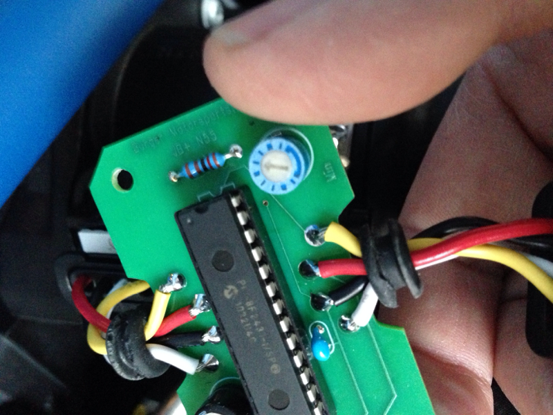

Stupid question alert! How do we adjust the jb+? I didn't fiddle with it when I got it. I just popped it in.
And so a 30%e85 mix with 91 octane will allow for a higher bump in the jb+?
Thanks for any info.

Open the box there is a dial:
I have it set at 1 o'clock or the 6 position. The default is noon or 5.

Just a note ClubmanRob! Do NOT try twisting the actual capacitor thing-y. It's only the dial inside that moves.

Ok cool. Just open the module and adjust. Got it. Much appreciated.

Exactly, use a flat head screwdriver inside the little arrow.
