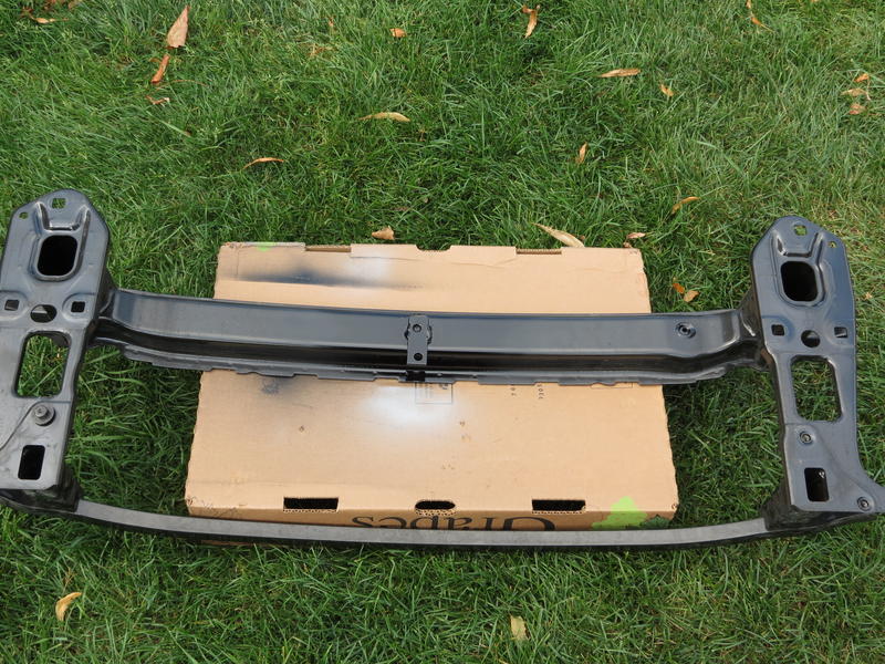

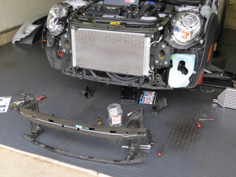

2013 Crash Bar Pics
Originally Posted by Go-Cart
Yes i have a 2013 jcw. I did hear about the new crash bar but have not seen it yet. Im assuming it can just be cut or modified to fit larger intercooler. I dont mind doing that if it just means cutting some pieces out of it. Was yours difficult? Any pics?
You can find some pics of my install here:
https://www.northamericanmotoring.co...-graphs-2.html
The Forge did not require any alterations other than I welded a mounting tab to the back of the upper crash bar to bolt the FMIC top mount to. The top mount probably isn't crucial and you could just as easily use self tapping screws or stainless steel pop rivets rather than welding. The job took me about 4 hours with a lunch break.

Crash Bar
Here's a couple pics of the crash bar removed. It must be removed for the install. Requires removal of about 12 bolts.
Attached Thumbnails Burger Motorsports (BMS) Tune(s)-img_1934.jpg   Burger Motorsports (BMS) Tune(s)-img_1929.jpg
