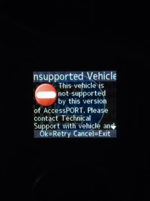

I got the used AccessPORT today. I downloaded the newest firware into it and took it out to my 2011 JCW. When I hook it up it says my car is not suported.
What now?

In the AP Manager, go to the options tab, and select 'check for beta firmware'. This is the first reply that you will get back from Alta, I have seen it 5 or 6 times in this thread, and it was the reply that I got this week when I had a concern or two with my AP. My AP was new and 'up to date', but when I checked the beta box there was a fairly large update.
Considering that they are likely closed until Tuesday, why don't you try that and then see if that helps. It will just cost you a 1/2 hour, maybe it will do the trick.

You are awesome!!! That was it. Now I must wait till tomorrow to try out the tune. Thanks

As the other guy said, beta update is the way to go for situations like this. We have a few more ECUs in there that will be in the normal update soon, and it sounds like it works, so that's good to hear.
