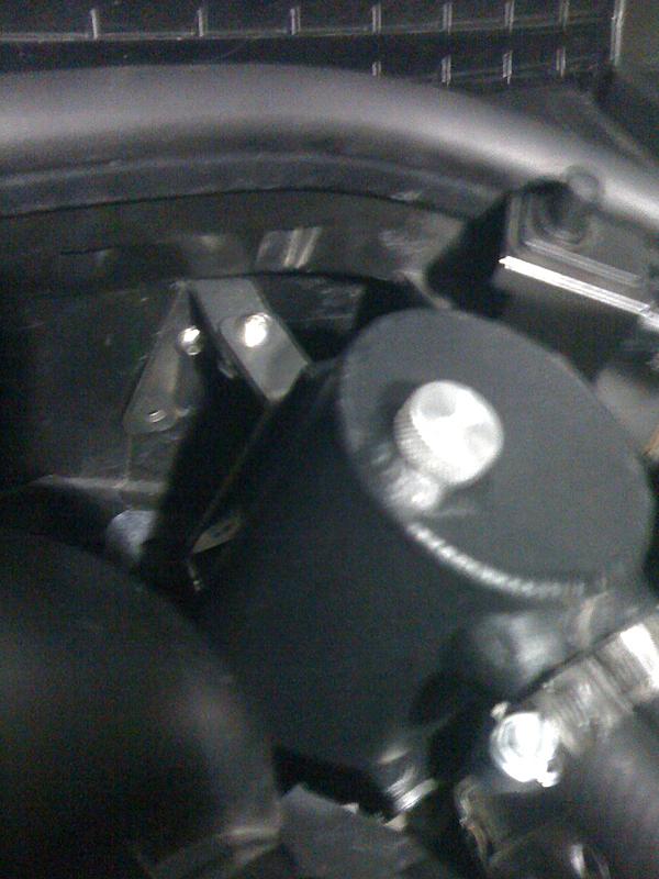

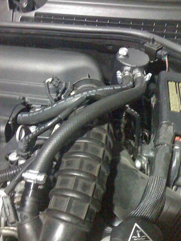

So with some help from one of my car club friends, I was able to install the BSH OCC (even though I have the factory alarm which takes the mounting spot for the OCC)by drilling into the bulkhead where the DOS intake would normally go. Luckily, I did not have to completely remove the bulkhead because I just loosened the screws to get my hand behind there. Besides the mounting problem it was a pretty clean install. I would suggest that anyone that uses an OCC to buy some hoses clamps for peace of mind and to prevent boost leak.

Nice, glad you found a solution.
Nice NM strut bar, I have the black one
