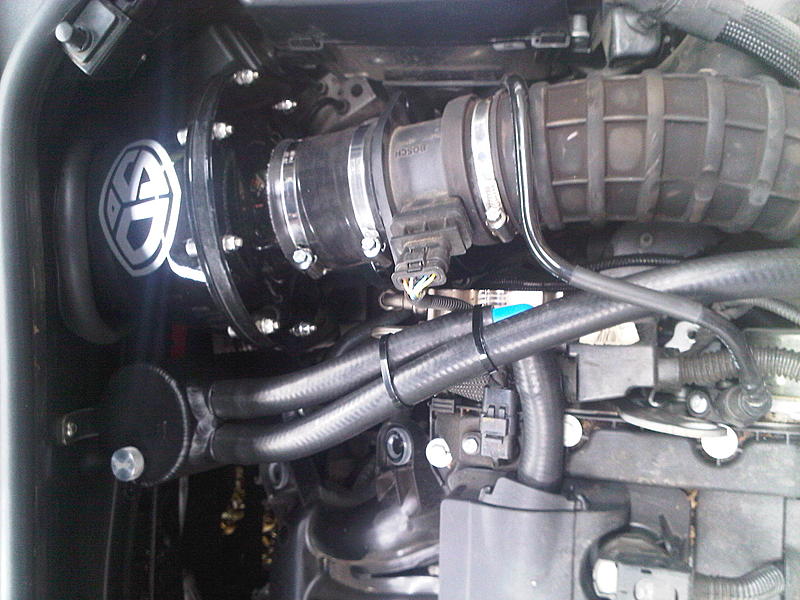

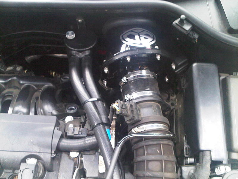

Catch Can, Dual Boost Tap and DOS intake!
Just got my Catch Can, Dual boost tap, and DoS intake installed, attached a few pics as I have opted for a different install location so the hoses do not stretch all the way across the engine bay. I just made up a quick new bracket for the install and picked up a 90 deg joint for the hose. Cant wait to see what will be inside after some drivin!
LMAO! One of us is a mind reader. I did the exact same thing when I put on my DoS CAI. Only difference is I used the 42 Draft Design can instead of the BSH. Sure makes it easy to get at, don't it? BTW, when I changed my IC I checked all the turbo pluming down stream from the can. After 5K it was bone dry and the OEM IC had oil in the bottom of it.
Did you thermal wrap the lower intake hose? Thats blingy
Did indeed, but definitely not for looks. It's to reflect radiant heat from the turbo & engine and give some insulation from the hot air blasting through the engine bay. I'm not into "bling", just performance.
