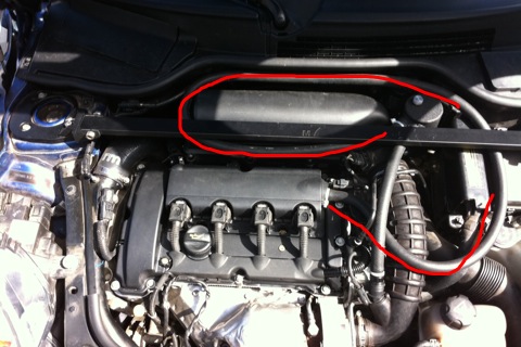

I installed my new CC and BPT last night, I did the normal instalation with a very short tube going to the Catch Can. However I thought about what Tintman said about using a longer tube in order to increase the amount of condensation, so I made some changes today.
It doesnt look as good, but I think it may work better, what do you all think?

Seems a bit excessive to me.
I'd just go with the normal length of hose, then disconnect the 'out' hose from the catch can after a couple weeks and make sure it's dry.

If you think that is excessive you should look at Tintmans install, he has like 14 feet of hose going all around his engine bay. I was concerned about what 09mellow said about how his hotside hose had oil in it even after the CC instal, and I had mine installed just like his. So it seems that the short hose method doesnt work.

My can only has about a foot of hose between it and the valve cover, and the outlet hose is perfectly dry (the inlet hose definitely is not). Then again, I am using the 42dd can and I have it on the passenger side hose path… so, not quite apples-to-apples.
I'd still say try a normal length of hose first and see what your results are. No sense creating hose intestines just because one guy on the internet says his was oily once.
