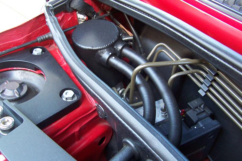

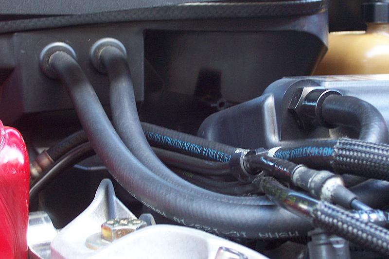

OK, so I finally got around to posting some pics of my BSH CC install. I used the available OEM threaded lug to mount the can as shown. Everything mounted rather easily and I fitted the hoses through the plastic to make for a clean install.
The only drawback to mounting the can back in the corner, is there is no way to get to the drain plug with it mounted in this location. No biggie though... I'd rather it was mounted here than anywhere else because it's the cleanest location and it looks like the factory would have put it there. It hasn't been on long enough to bother draining it. But, when I have to, I'll use a suction gun and go through one of the hose connections on the top.
It was nice to see BSH has added a third port to the top of their new cans and put in a dip stick. Of course that refinement came after my investment and install... Regardless, that port will surely make for easier clean-out of the can.
Anybody that wants to see any additional pics or needs the details of an install, drop me a note and I'll send ya an email.

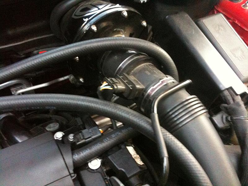

I have a RHD JCW with a DoS CAI, so mounting the BSH OCC wasn't easy, and I ended up using a hold that was free (stock intake uses it). I installed the BSH OCC and dual boost port as shown in the pictures. Now, I don't quite see how this eliminates the need for two catch cans, as the left hand side PCV line hasn't been blocked off in any way, so what have I done wrong?
Attached Thumbnails BSH catch can and dual boost port install-bsh-001.jpg   BSH catch can and dual boost port install-bsh-002.jpg   BSH catch can and dual boost port install-bsh-003.jpg
