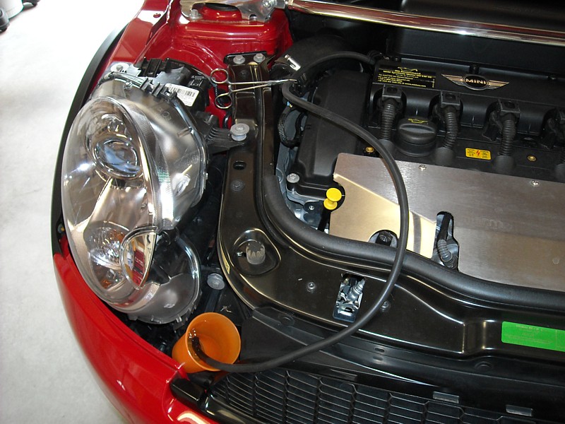

Originally Posted by D Unit
Anyone using the dual boost port "just" for an easy way for seafoam treatments? Can someone share a pic of what they came up with?
These pics are with the use of a hemostat to control ingestion. I have since picked up a small "air" valve that's used on aquariums.
Attached Thumbnails BSH catch can and dual boost port install-seafoam1.jpg   BSH catch can and dual boost port install-seafoam3.jpg   BSH catch can and dual boost port install-seafoam4.jpg
