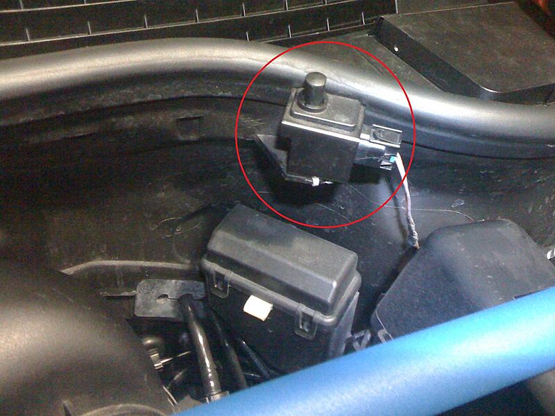

BSH OCC placement problem
Well I tried to install my BSH occ and found out the hard way that it would not fit. after I followed the instructions and was about to connect the occ to the Mini I realized that because I have the factory alarm installed on my Mini I cannot put the occ where BSH recommended. This is because the hood pressure switch that the alarm uses is in place of where the occ would go. Since I still have the stock intake I cannot put it in the other place either. So basically I have no idea where to put. It could possibly fit in the place with the alarm pressure switch, but I would need to find some kind of bracket that would put the occ to the left of the alarm switch. Other than that I am currently stuck. Any suggestions anyone? I have included a picture so you can see the problem.

Old Apr 9, 2010 | 09:38 AM
  #98

From: North Tonawanda NY
Can'yyou move the switch?

From: Texas
I could move the switch, but I would have no idea where to put it. Also if the switch is not depressed I think it would mess with my alarm when I tried to lock my car. I could tape the switch down, but that kinda deletes the point of the alarm. Plus I cannot freaking find out how to unscrew the switch because once you unplug it there is a plastic connector in the way that blocks the screw.
You have run into a tricky situation! This is why we offer two different mounting locations, however you have a car/setup that doesn't have either available! We are currently working on an "upgrade" kit for a third mounting location, which tentatively will include an additional bracket and hardware so that it will be easier to mount to the plastic firewall at the back of the engine bay. Look for updates with DoS for this process as well If you get anxious, give a call into the shop and I we'll send you another bracket
