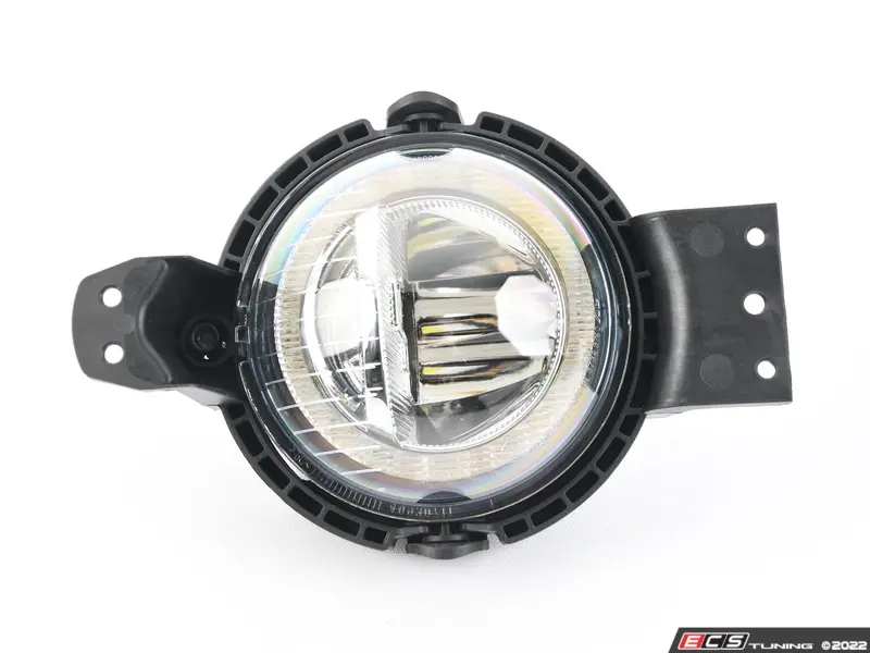

I dont know if they will work. Here are the part numbers. My guess is it can be flashed with an NCS expert or if someone know the codding for the updated 2015+ DRL in fog parking light set up.
Plug is a three prong. So it looks like it will not work as an upgrade without doing some rewiring.
https://www.ecstuning.com/b-genuine-...r/63179812537/ Fog LED/ Parking light/ DRL halo 2015+
https://www.ecstuning.com/Search/Sit...h/63179811755/ 2015+
Looks to be just a position light and drl light on the bottom. Cant tell is the bottom bulb is led, looks like its not.

My 2016 uses like half (Like a semicircle) of the LED fog light for DRL, then when you turn on fogs it turns on the rest.
Old Feb 7, 2023 | 09:09 AM
Posts: 36,758
Likes: 2,548
Yep thats the Genuine MINI Factory DRL upgrade kit that does that when its DRL, and then in position light ( one click on the stalk its the half circle), fog light the full thing and light itself.
