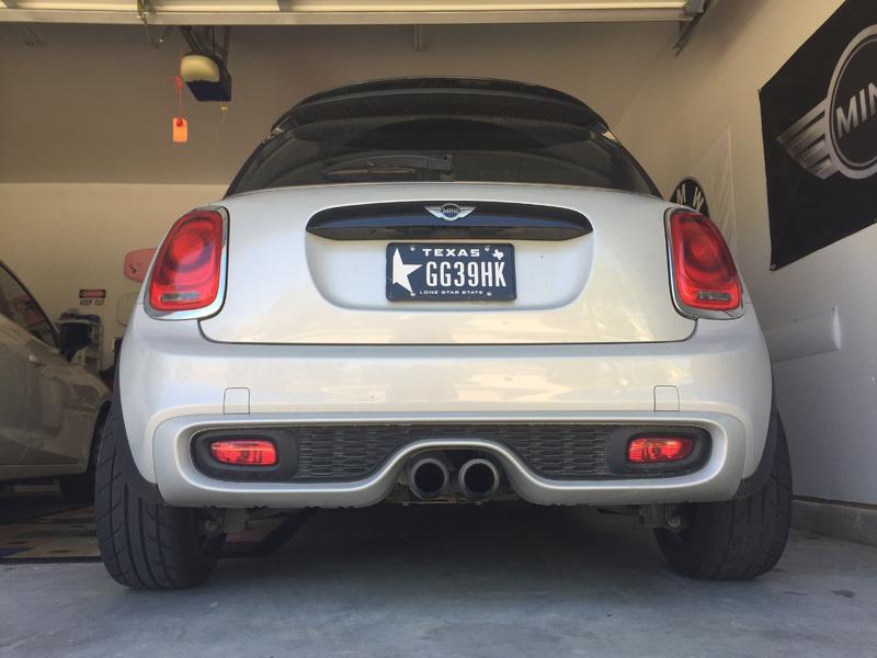

Sorry, i know it's filthy right now. Lot of rain lately

I wouldn't abandon hope. I'm confident you can make it work if you don't mind a little spacer. If you don't want spacers anywhere around et40 will get pretty flush without spacers. The pic at the top of this page shows an aggressive et30 on the rear.

this is a better view of how the et35 front et30 rear looks

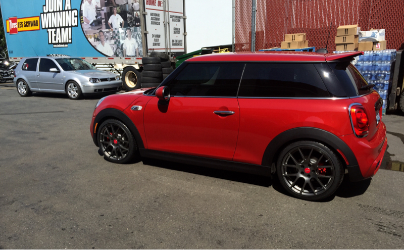

Complete 😊 "for now" Maybe black Viper stripes next
Rse12 18 x 7.5 ET45
Michelin Pilot Sport AS3 P205/40R18
H&R Sport Springs
18% Tint
Attached Thumbnails Official F56 Wheel Fitment Thread-image-42150448.jpg   Official F56 Wheel Fitment Thread-image-1737637528.jpg   Official F56 Wheel Fitment Thread-image-3698307970.jpg   Official F56 Wheel Fitment Thread-image-2469924.jpg

Looks good in the NM Rse12 and the factory Red Center caps
https://www.northamericanmotoring.co...1737637528.jpg
Thank you. I love the setup. That pic was my fav cuz in the background is my son's GTI and Les Schwab truck...the company that did the install
