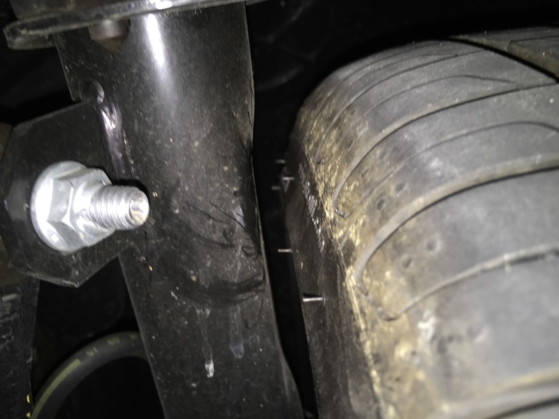

Are you using spacers? I ask because I only have approximately 8mm of space between the 205 on my JCW and the front shock. So it appears I wouldn't have the space to move to a 225.
No but my rims are a 45 offset not the factory 54offset

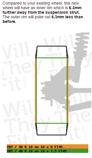

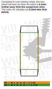

Why not just use a small spacer for the NM Engineering wheels? I doubt the fitment is so tight they can't handle a small spacer.
Edit: For instance, this wheel is an 18x7.5 et 45.
R99 is running Speedlines that are 18x8 et 45 and still easily fit under the fenders
You could run a 6mm spacer on the NM Engineering wheels to be at the same effective offset he has. Also apparently his Speedline wheels clear the JCW brakes, so that's another option

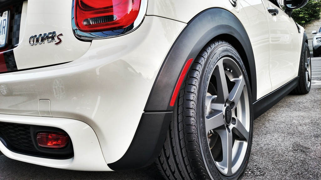

Monte Titano Piana from tirerack. 17x7.5 et45 with Yokohama Avid Sport 225/45/17 RF's with tpms was just over 1500.00
