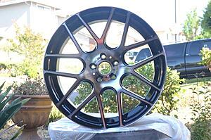

I'm looking at picking up a set of TSW Nurburgring replicas and wanted to make sure they'd fit:

Apr 20, 2015 | 11:14 AM
  #182
Good stuff...but when I say they will fit, I do mean with a rather aggressive stance. They will be right out to the edge of the top of the fenders at their widest point. they may even poke past that just a hair.

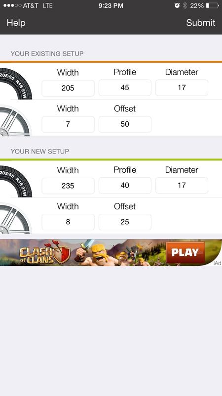

Apr 20, 2015 | 03:17 PM
  #184
How bad would this be? I want super wide tires without looking super dumb.
Reply 0
Apr 21, 2015 | 12:51 PM
  #185
^what is the wheel size and offset? I can provide a better answer with that information

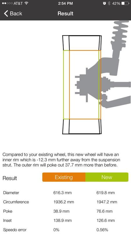

Apr 21, 2015 | 07:34 PM
  #186
Here we go
Reply 0
Apr 22, 2015 | 05:17 AM
  #187
This was an 8" wide et 32 wheel. Yours would poke an additional 7mm out from that.
Reply 0
Apr 22, 2015 | 12:06 PM
  #188
yeah, 8" with et25 is gonna be poking out a bit TOO much. especially up front! and with 235 tires? No way.
unless you're willing to do some custom widebody work... lol
Reply 0

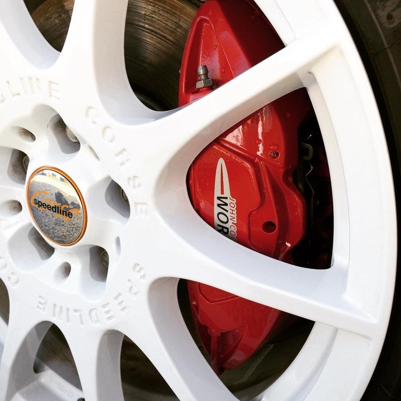

Apr 24, 2015 | 01:14 PM
  #198
The JCW Brakes are massivE.
My 18x8 ET45 Speedlines barley clear them.
However, I know a guy who also runs 18x8 ET45 with the JCW brakes, but his spoke design is different and he needed 8mm spacers to clear the JCW's!
My Speedlines were obviously designed with BBK's in mind, unlike his rims.
The only way the MINI wheels clear the brakes is the unfortunate design with the spokes bending out ridiculously - it looks very odd in person!

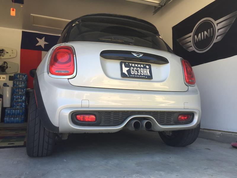

Apr 25, 2015 | 12:48 PM
  #200
You don't need very wide tires for grip on this car. I went one size wider and a whole lot stickier and i can barely force it to lose grip. The make/model of the the tire is more important than the width. Unless you turn it into a drag car...then you could put skinnies out back and fat drag radials up front
Just snapped this if you want a better idea of a 215/45 on an 8" wheel.
