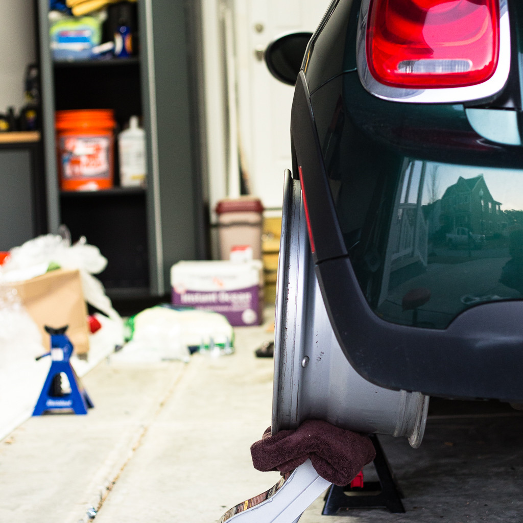

17x9 et 48
So much for using the R56 fitment as a guide, heh.

So can a F56 S with Stock suspens run 17x8 wheels?
  #96
Old 01-22-2015, 06:50 AM
randomquickness's Avatar
randomquickness
randomquickness is offline
Join Date: Jun 2009
Posts: 631
Received 4 Likes on 3 Posts
^yes, with correct offset it would fit just fine

Any idea what the range of offset i can run with?
  #98
Old 01-22-2015, 08:09 AM
randomquickness
Join Date: Jun 2009
Posts: 631
for an 8" wide wheel I'd say ET45 and lower. Possibly as low as ET35 but I'm not sure if that has been verified yet.

Somewhere between 40-45 for an 8" wheel would be good if you're going with a meaty tire. On the stock suspension you won't have to worry about any clearance issues.

Vic,
Could we see more pictures of the car and wheels? They look pretty interesting!
