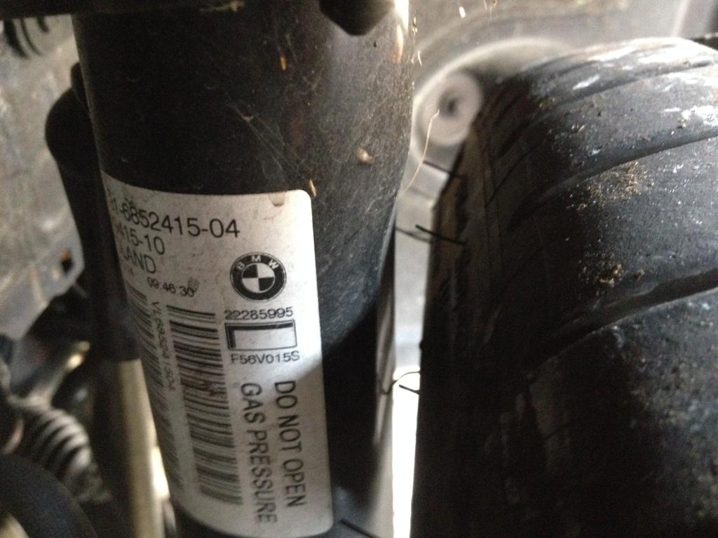

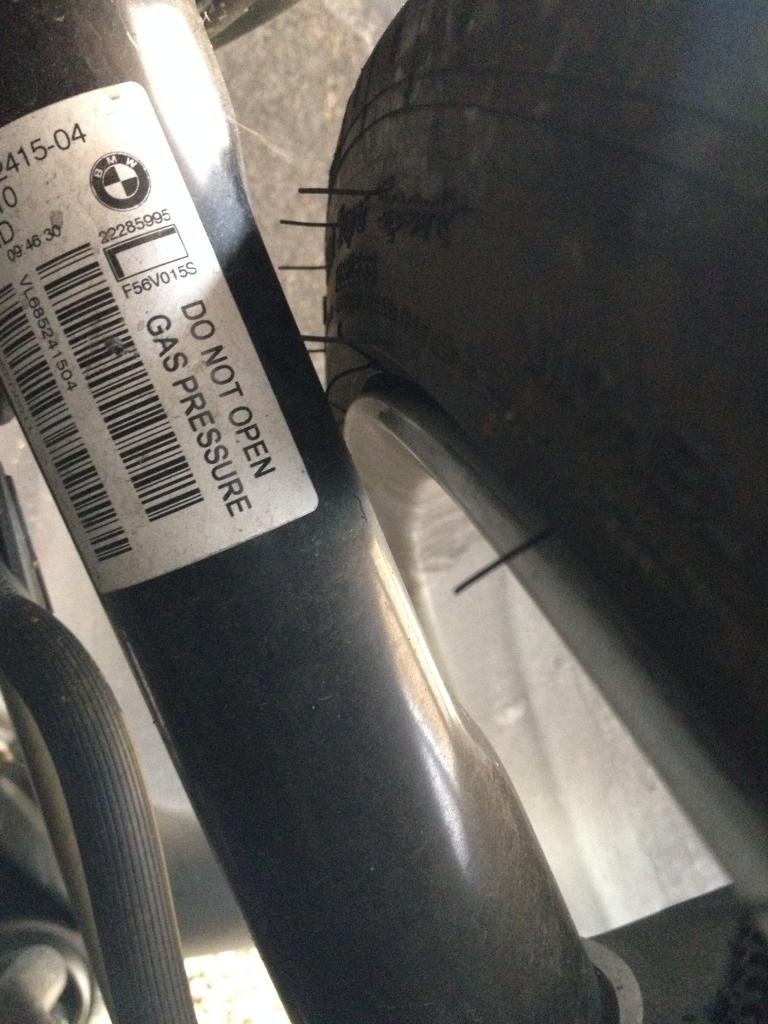

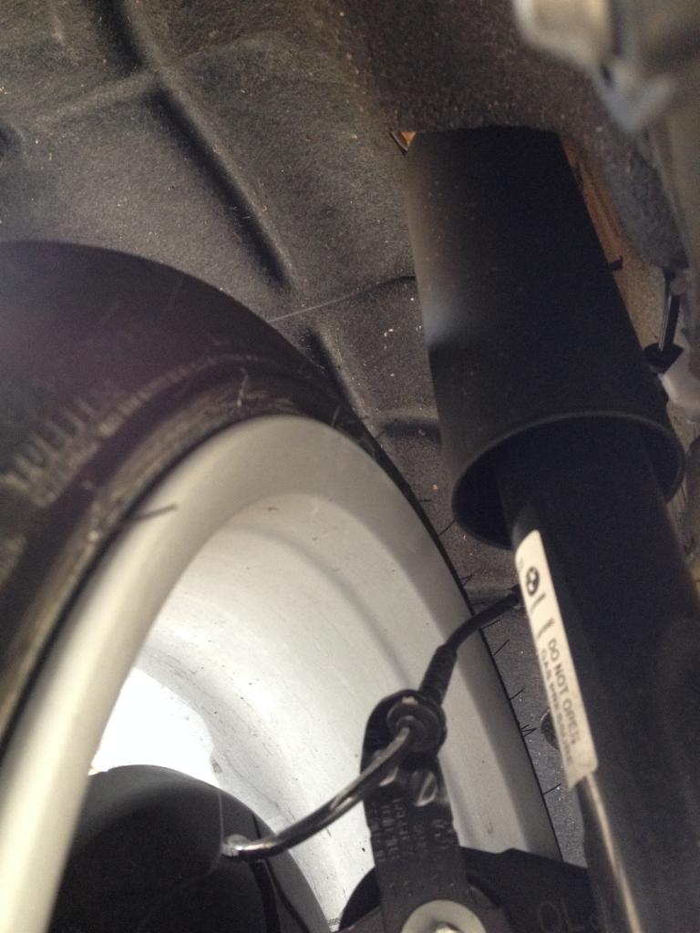

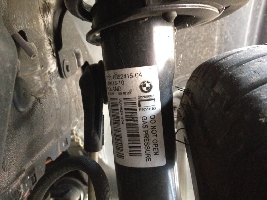

Pictures that show inner clearance of 18x8 ET45 with 205/40 Michelin Pilot Super Sports fitted. (no spacers and stock sport suspension)
Front:

Rear:

Have you ordered spacers yet? I'm curious to see the fitment at et35 BEFORE lowering it.

No spacers yet - I am trying to decide if I will need 10 or 12mm spacers to clear the struts with the coilovers
