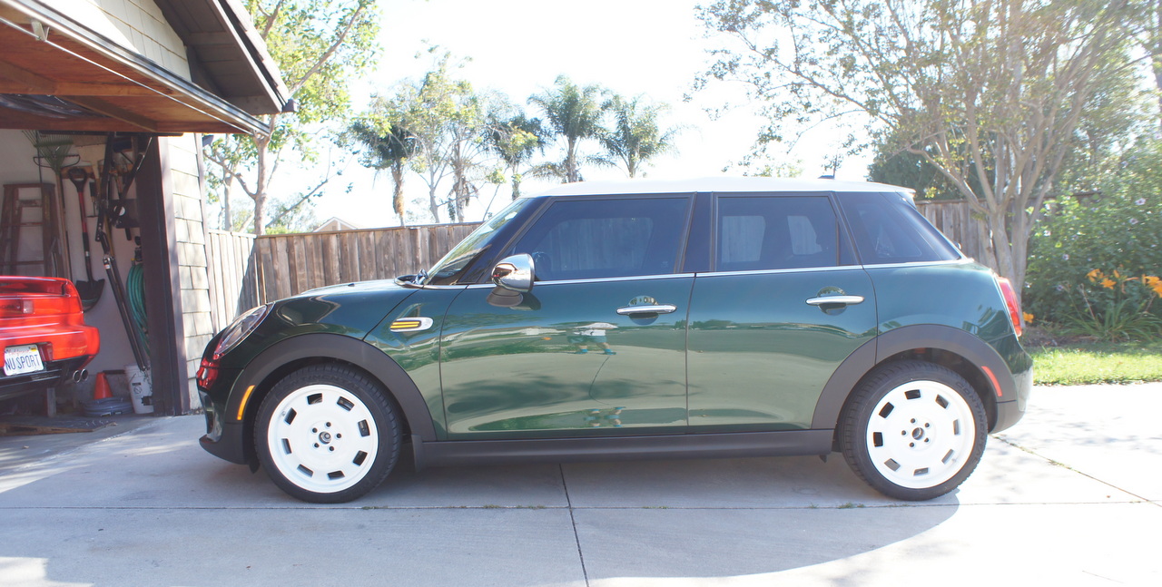

These are 17x7 ET43 with factory-size 205/45/17s
Attached Thumbnails Official F56 Wheel Fitment Thread-dsc02465.jpg   Official F56 Wheel Fitment Thread-dsc02467.jpg   Official F56 Wheel Fitment Thread-dsc02464.jpg
Cool- are those the VW Heritage wheels? Did they fit without any modifications? I'd love to see them in black... and lowered... =)
Jeff
Old Jun 25, 2015 | 06:25 PM
  #281
KazO's Avatar
KazO
Joined: Jan 2015
Posts: 55
Jeff
There are ways to get away without modifications to get around the small centerbore and different lug seats, but I was changing from black to white so I had all the proper machine work done.

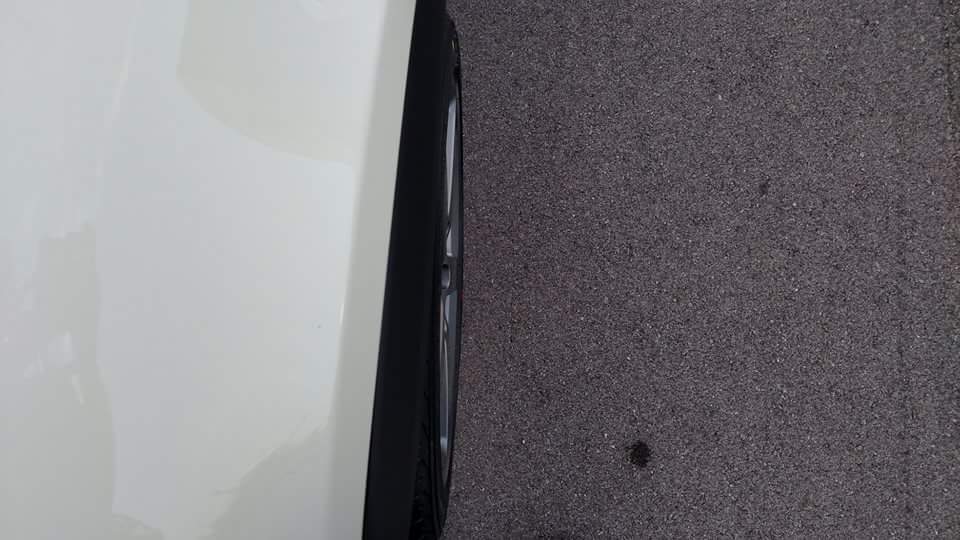

Yeah you will have lots of clearance issues especially if you go low. Wheel wells are not forgiving in the F56. I have only 75" wide but my tires are 8.5" wide et 45. I clear the rear fender by 3-4mm and the front struts by 3mm. Front camber is .8 rear 1.7.
Front wheel
