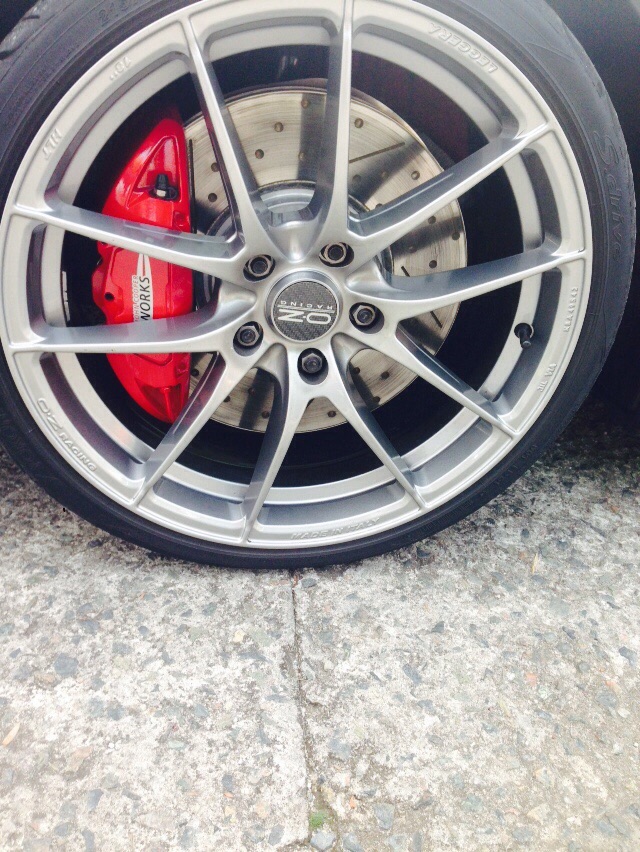

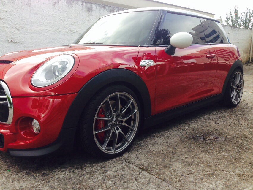

OZ Racing Leggera HLT 18x8 et48 with 10mm spacer up front and 10mm in the rear, plus NM springs.
Yokohana SDrive 215/35 no rubbing at all.
The front wheels went off the fender line.

Sick! Really nice with the red.

Quote: OZ Racing Leggera HLT 18x8 et48 with 10mm spacer up front and 10mm in the rear, plus NM springs.
I see you "redded" out the chrome around the headlights and tail lights. Nice touch.

I agree with you. Thanks!
Quote: I see you "redded" out the chrome around the headlights and tail lights. Nice touch.
The door handle too, plus a black belt line. It changed how the car looks. Thanks!
Reply 0

Nice choice in wheels!

Looks great!!

those do look great! easy to clean also!

Looks nice, you must be in Thailand or somewhere, MINI pretty rare there ? like the painted HL and TL trims.
