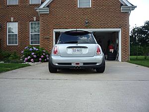

Originally Posted by Mjimport
What do you think about the esm 001 in black 16's ? I know the 17 looks sick but I prefer 16 for daily driver purposes.
Anyone have pics of black 16"?
ESM-001 16x8 +35.
Idk what 16 has to do with daily driving over the 17.. but to each their own. 16s are too small looking to me on the R56.

16 would have a little more meat on the tires, reducing the wear and tear on the suspension (and driver)
Btw I have an R53, but the pic above really helps. I bet it would look better dropped a little bit.
Would look a lot better lowered. All minis look better lowered, stock height is not my style. I guess 16 go better on the r53 since they have smaller wheel wells, but i dont think 16vs 17s provide any sort of different in ride, or such. I run on a good tire and its a 40 series and I would say it rides 10 times better than my 45 series RTFs. lol.

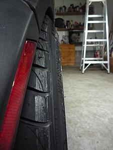

So i finally can join this thread as I pulled the trigger on some 8" wide wheels. But as I was getting the mounted and balanced, the shop took the liberty to putting them on my car... Even though I was excited to get them on (they're the first set of aftermarket wheels I've ever bought), I was sure that my suspension set up was a little low for the width and offset.
Here are the specs:
Wheel: 16x8 all four (BBS knockoffs)
Offset: +20
Tire: 215/40/16
As soon as I got in the car, I could just hear the rubbing on the back tires. The fronts, surprisingly, don't rub as much as I thought they would. I wanted to just tell the shop to take them back off, but I was flattered that they were taking pics for their website and had to be somewhere. Anyway, I drove home the whole way listening to the sounds of LOW. The only time i couldn't hear the rubbing was when I reached 50+ and my car lifted up due to the air underneath. So I got home and saw this awesome new protective coating on the shoulders of my brand new tires.
Basically, the tires melted the plastic fender to the part that was rubbing.
I know the fenders are plastic, but has anyone heard of anyone rolling/pulling the metal behind it. I would like to stay at the height...

MINIng,
That's a lot what my tires looked like too before I rolled my fenders. (the metal part of the fenders at least. Basically, jack the car up, take the wheels off, and pound the metal towards the sky like there's no tomorrow. If it rubbed enough, it will have bent the metal so it is laying flat against itself. There is a little metal ledge (hard to explain without pictures) and it might be laying flat. You need to get something flat and get it under this metal, and once it parts a little, you can pound of flat again. Really hard to explain without pictures, but I can show you pictures of my fenders and how they look "rolled" so it can give you a better idea.

Originally Posted by MINIng
You live and you learn...
(from the mistakes of others )
...not a mistake, the setup you have is done on plenty of other MINIs, once trimmed up in the right spots...should be fine.

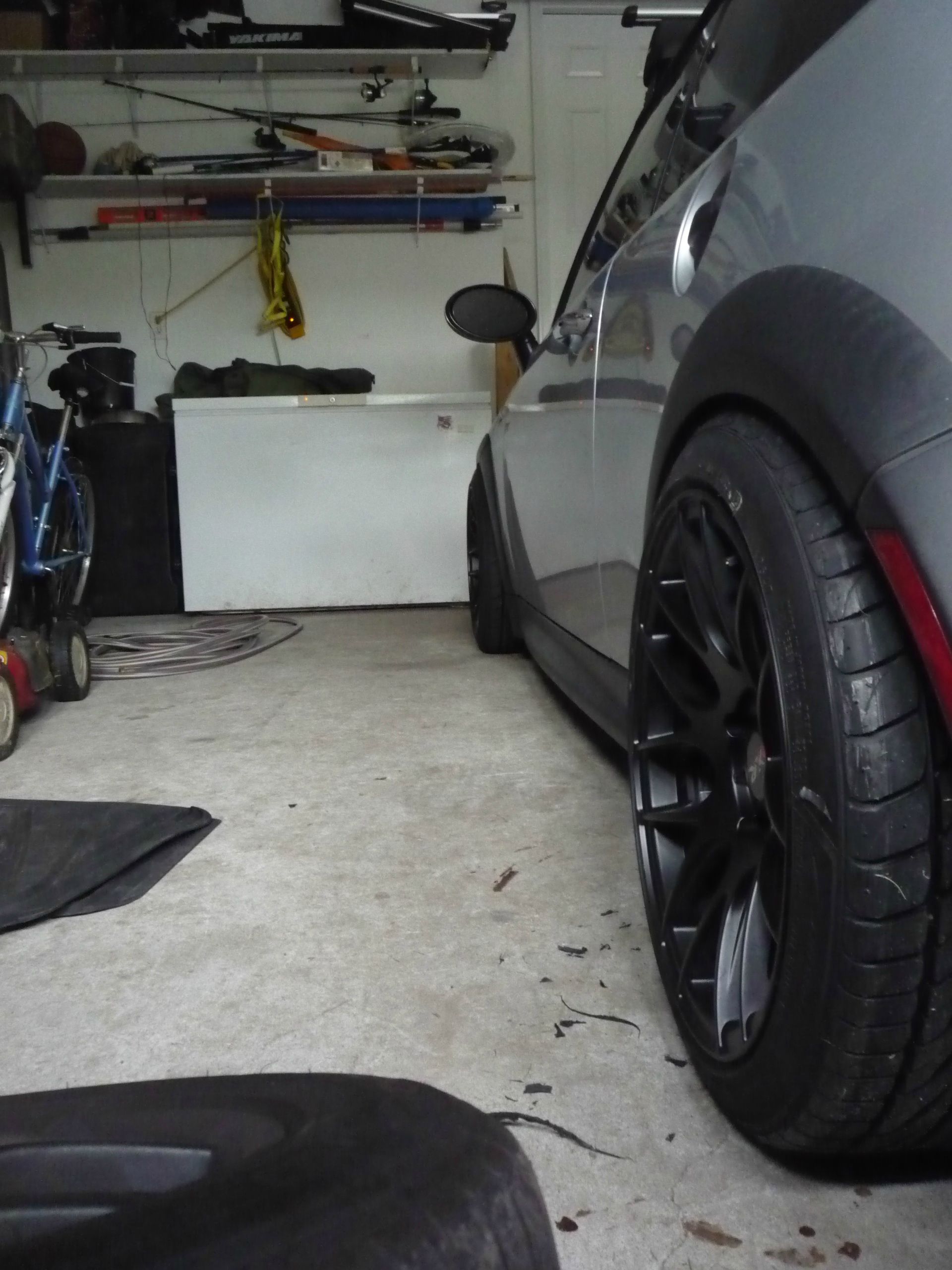

i was trying to hide it until i got it all dolled up , but since you asked nicely i'll give you a preview.
Notice all the trimming on the floor
currently looking for black lug bolts with a lock and key... if any advice

MINIng : Need more pics, I have a set 16x8 et26. I was wondering if 215's would fit.
Did the rubbing stop once you trimmed the arches? I really don't want to stretch 195's/205's unless I have to. I'm thinking the extra 6cm I have may just help given I have fixed camber plate on front and Adjustable Lower Control Arms (ALCA) on the rear.
Old May 31, 2012 | 03:09 PM
Did you adjust camber? I would highest suggest it.

^^yep, adjust camber.
..also, that lil' bit of trimming...gonna need more than that, ..wheels off..then dremel tool, plyers..etc..

Originally Posted by J&M'sMini
are your original (black) lug bolts just tarnished and faded then?
I don't know what you mean about original black lug bolts. If there are OEM black bolts, I will buy them. Its a 2006 r53. I bought it used with only one owner at 26k miles. It came with the standard boring looking bolts. I really just want something I can use with my tire iron and not a ratchet.
I just went to town on cleaning it, washed, clayed, polished and waxed, so I should put some nice pics up this weekend if the weather is still good...
What kind of pics are you looking for? wheel well?
My guess is that your setup would definitely work. I may have to trim the arches a bit more, but that one ride home did a lot of the work for me already and the rubbing has definitely decreased. Its just the average to larger bumps that cause the back tires to rub. Nothing major.
My guess with a 26et you're looking for a more flush look, which is defintely attainable. In retrospect, I would have gone that route, but I like the style and price of the wheels too much. Also, I think et is measure in millimeters and not centimeters.
I just got an alignment and don't want to burn through these new tires. But I will be going to town on those fenders very soon.
