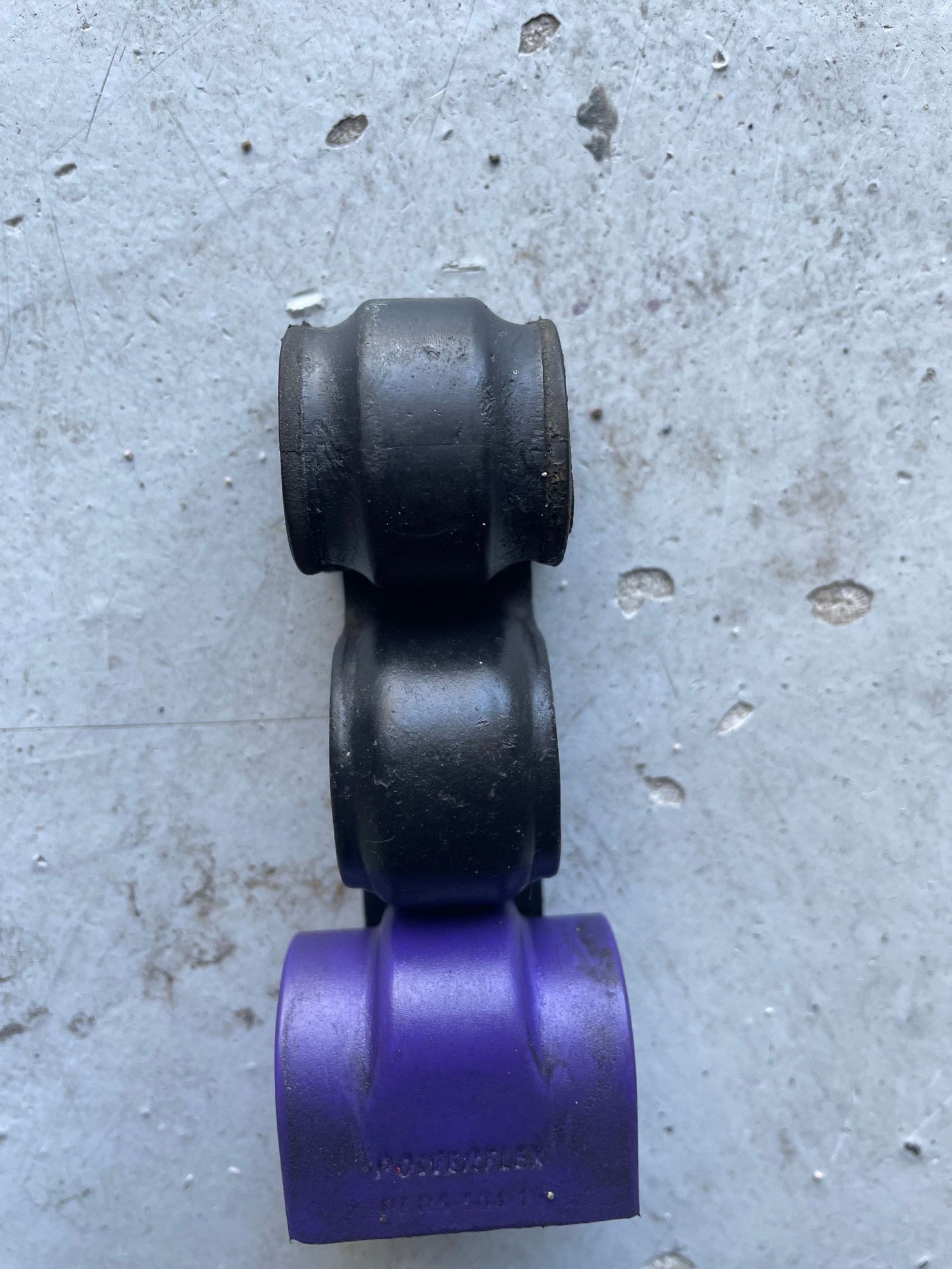

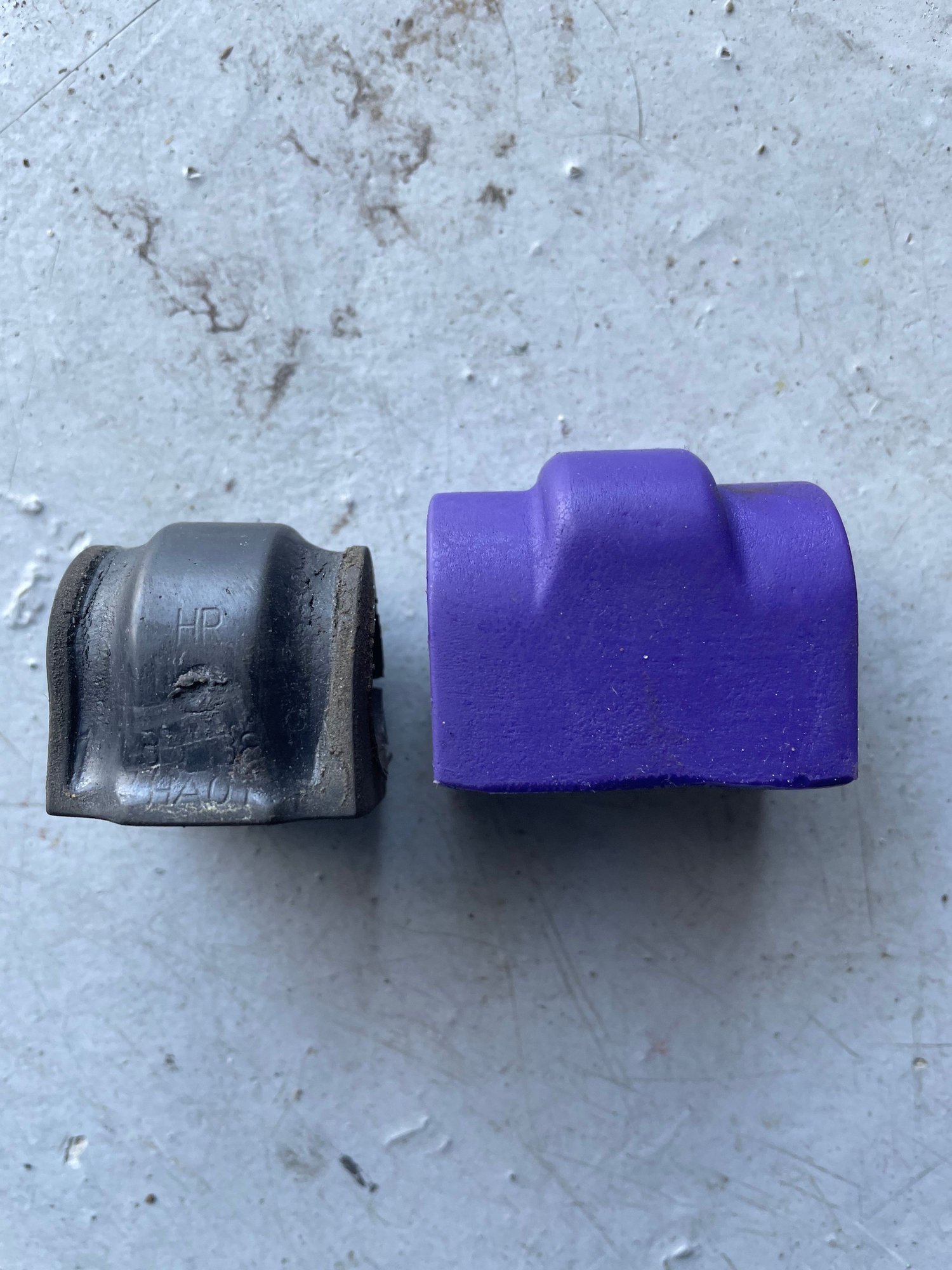

I tried to install the 19mm rear anti sway bar power flex bushing today to replace the 19mm H&R aftermarket but would not fit in the clamp. Requested ECS Tuning to return my order.
Attached photos:
Powerflex - H&R - Clamp
H&R - Clamp _ Poweflex
H&R - Powerflex
H&R - Powerflex side by side
