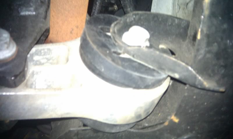

I was just wondering if anyone looked underneath after some time of having there's installed, it's been around a year now and I was installing my oil temp sensor in the oil pan last night and noticed that it looked as if it was coming out?

I'm assuming everything is still tightened up? Regardless, that doesn't look like I imagine NM plans for it to look.

yes its the bolt tight, i didnt think so either lol its only coming out on the one side too, the front is nice and snug

Mine did the same thing days after I installed it. I reinstalled it twice just to make sure and it kept doing it. I talked with NM and they said it was fine.

well is this right or not?
it looks like there is not enough backing letting the plastic protrude like that
Hmmm.. Mines in the shop this week due to A/C Drain leaking, leaving lakes in my rear floorboards but I will check mine when I get it back this weekend! I installed mine around Christmas time. Also my bushings are the triangular shaped ones. It might make a difference, I don't know.
