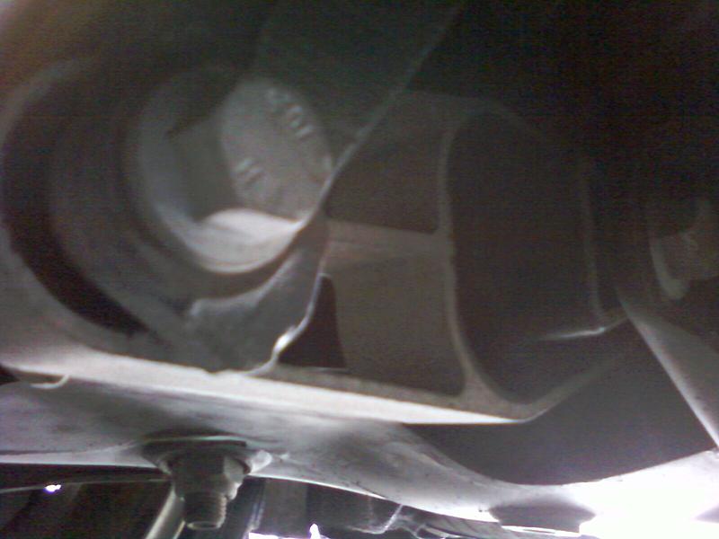

Just installed my NM Torque Arm bushings. I had the older trianglar torque arm and initially ordered the wrong ones for an '07. I ran the car hard and did not notice any additional vibrations. My initial assessment, it appears to reduce the torgue steer greatly. The install was easy, as previously posted by someone else, 25 minutes once it is raised. Think this was an excellent investment
Glad you got em so fast. You've got one of the few triangular mounts.
