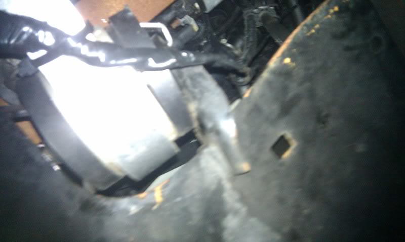

So I got the "fix" from NM for the bushing coming out and after I tighten it down it barely touches the bushing defiantly does not push it back in or stop it from coming out, anyone else have this issue?

see post # 130
heres my solution works great
