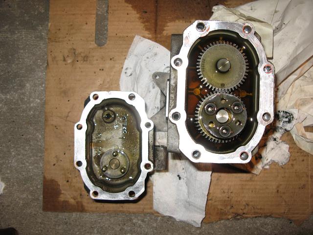

ok, will buy that gasket maker thanks for info.
Mine looks pretty clean, glad i don't have to spend another $$ for s/c
Few questions now.
1. Is there any torq spec on both plates for s/c when i put together?
2. Should I use loctite? when i remove bolts for s/c plates it was too easy and I see some oil around inlet that with green gasket (bottom of waterpump).
afraid bolts get loose as time goes.
http://www.useloctite.com/products/p...cking090e.html
3. s/c fluid to use. I see thread about that, is it right? "waterpump drive side- 2.5oz; nose gear side(pulley side)5.5oz"
https://www.northamericanmotoring.co...ger-fluid.html
just like to make sure so i don't screw up.
thanks

We don't use thread lock on the main bolts. Always scares
me if you have to take it back apart. If you torque them
down tight they should not come loose. I don't find loose
bolts on these units when we rebuild them (usually). The gears
look good on your unit but how did the 24 tooth gear get pushed
down further on the shaft (we always see them flush with the end
of the shaft)?
Charles
Supercharger Tech.
supercharger@excite.com
