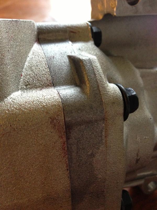

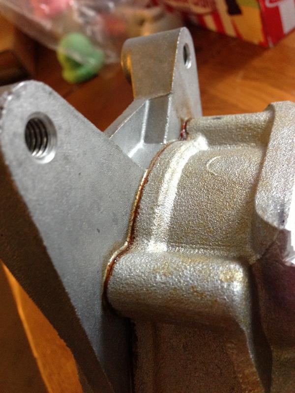

Pulled off a SC with 70K from my friend's 04 MCS because of a broken water pump nipple.
Lucky for him I have a take-off that has been sitting in my closet for 5+ years.
However, I just pulled it out and am slightly concerned about the case seals.
Do you think it's ok to slap this baby in as is? That would save time and $$$ for sure.
SC looks to be in good relatively unused condition otherwise.

At a minimum I'd drain and refill the front and rear. Would be nice to pull apart, inspect and reseal, but that would be a bunch more work.
