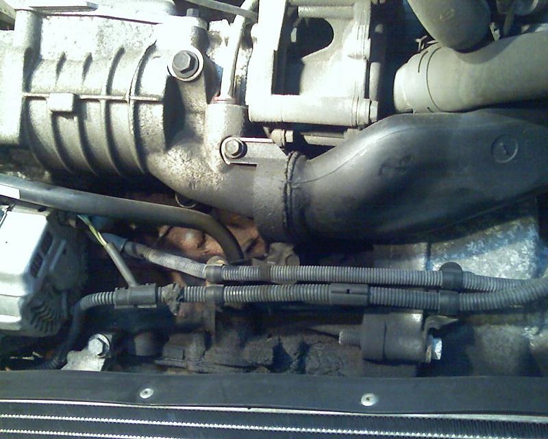

leak at supercharger
I also posted this message in another forum but it seems that the discussion is happen here.
My 02 has 100,000 miles on it and i noticed fluid on the front of the block. Reading all the post regarding known issues with the SC, I tore it down this past weekend.
The water pump side of the SC was low in fluid. However, there was some left in (maybe ½ an ounce) and nothing appeared to be damaged. I will send it off to get rebuilt b/c of the high mileage on it. The drive side had more fluid (close to the fill level) but the fluid was darker in color. Anyway, my question is that I am still not convinced that the fluid on the block is the SC lube. Has anyone seen anything similar? See pic. Any ideas or comments?
Oil is "caked" on the front of the block at and around the top of the oill pan. It seems to be coming from the connection between the SC air intake and the air duct.

Originally Posted by 02scooper
...My 02 has 100,000 miles on it and i noticed fluid on the front of the block... Has anyone seen anything similar?...Any ideas or comments?...Oil is "caked" on the front of the block at and around the top of the oill pan. It seems to be coming from the connection between the SC air intake and the air duct.
The seal at the green gasket for the supercharger intake duct will become compromised with time. Most of the oil is coming from that interface. I’ve had a leak at that gasket causing idle issues before, so I replace it every time I have access to it. High mileage also brings with it the possibility of excessive blow-by across the piston rings, thereby increasing crankcase pressure (there’s positive pressure even when new). The O-rings on the dip-stick tube will harden over time and allow some pressure induced seepage there, along with seepage from the sensor located above it. I had an oil trickle from the crankshaft position sensor at less than half your miles.
