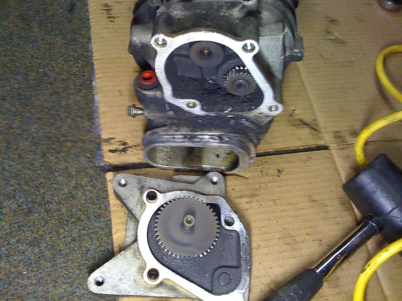

Finally got the S/C out of the car and this is what I found. The front of the unit was in great shape and the Alta Pulley I installed 6 years ago still looked like new. The back where the water pup hooks up is another story. Missing teeth and gear dust from worn down gears. I can't believe BMW would let their product fall apart like this. This car has 53,000 miles on it and Nebula's had even less. What a travisty!
Attached Thumbnails Rattle : Supercharger / water pump-img_0023.jpg   Rattle : Supercharger / water pump-img_0025.jpg   Rattle : Supercharger / water pump-img_0026.jpg

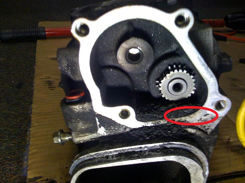

This is the second one I have seen like this in a week.
The other one also showed similar damage, and signs of the SC oil leaking frm where the cover attaches. It would seem that the machine marks left by the CNC grinder could be attributed to the oil loss. Some machine marks are pretty deep in the SC which fail.
In your last pic I see similar brownish stain ( circled area).
Rattle : Supercharger / water pump-supercharger.jpg

Machine marks
Those aren' really machine marks as much as the crud and shavings that fell out when the two pieces were separated. I apologize for the quality of the photos, they were taken in my garage last night with an iphone. Not the best quality. In talking with Brian @ http://canadiansupercharger.com he made mention of the fact that most of the gears installed OEM were rather inferior, that's why he and his partner in Florida have developed new rear gears that are lapped for quietness and, from what I understand, much stronger. The good news is that you can buy just the rear gear set up. They seem to know what they are doing and also seem to be reasonable. I would not wish this experience on my worst enemy! I hope none of you ever have to go through it, it is a real PITA.
Clean the edge of the SC off...you will find the tool marks.....I can see the gunk/debris. That is not to what I refer. I refer to the "tea staining" on the machined part of the SC where the plate attaches.
looks to me like that is where the oil leaked out. It looks like the gasket materal was compermised, the oil leaked out, then it ate the gears. If you read the thread, this means the seal between the sc and the waterpump gears is most likely good, so a cheaper rebuild, like the ones from the guys in FL, with new gears might be fine. $500 bucks for a rebuild is cheaper than $1600 for the dealer rebuild, 2000+ for new, or even the $1000 bucks for others guys. Granted, it is not a high performance rebuild, and might have a shortcut taken (see the above posts from dustin), but with a 2 year warrenty, and the fact the oil loss was external, I'd rebuild it, and even if it was already replaced, keep it for nexttime.
