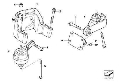

Sounds like your mount is leaking. Your 06 should have the fluid filled mount. It is a thick black fliud, much thicker than oil. It is tough to get all the fluid off all of the places the fluid leaks and sprays on. I just engine degreaser and various brushes.
It is item 3 in the picture and they still call it a rubber mount but it is filled with fluid.
P/N appears to be: 22116778610
I am not sure of the torque on the bolt. You will need a external torx bit, I think size E12 but I am not sure.
