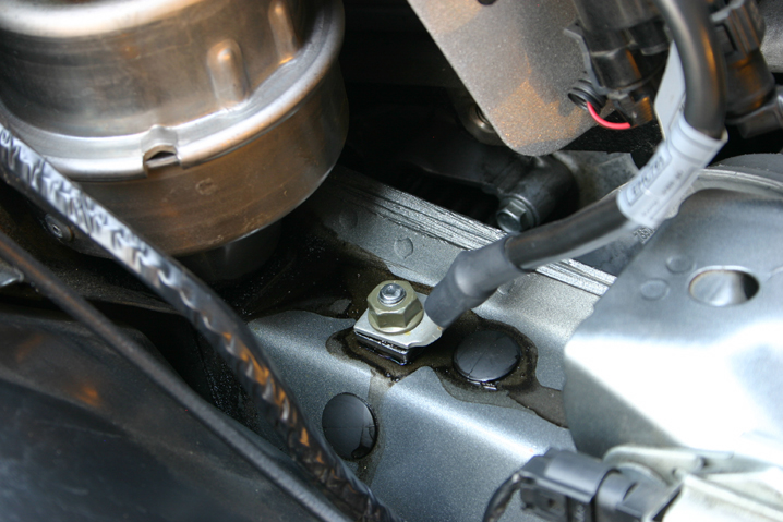

I just experienced this issue with my '05 MCS
Having trouble cleaning the paint around the now replaced part . . . will test the isopropyl alcohol suggestion . . . its a shame because some of the stuff also splattered onto the otherwise clean engine.

I used engine degreaser with a rag and soft brush on the paint. I had to use a small brass brush on the engine. If you go with engine degreaser, I suggest orange smelling degreaser because your face will be right over the degreaser for a long time. Took me almost an hour to get everything clean.

Isopropyl Alcohol works great on this clean-up. Use an old toothbrush and the alcohol all around where it was bleeding and it will come off with no problem.

Thanks . . . fyi I think the residual stuff maybe a bit more firmly baked into the paint on my car . . . but I'll soon be back at it with all of the aforementioned solvents giving it another shot.
The alcohol worked great on my engine, however.
