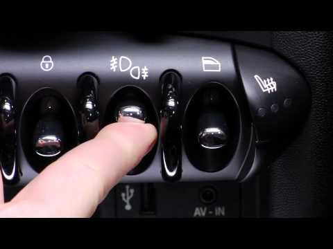

Its a separate switch for the rear fog lights. Your switch panel would look like this if you had the rear fog light option:
The fog switch on the right side is for the rear fog light.

Here is a picture of my cars switches, not a separate switch

OK, I did a little extra searching...
You switch panel would look like this with the rear fog light option:
Thanks!
Looks like I have front fog lights but not a rear one.
Strange?
Thanks for the information.

Rear fogs were not a common option selected by US owners, though many cars already had the wiring & lamps fitted anyway.
I think you'll at least need to change the switch panel for the one njaremka posted Then get the option coded, probably by the $$$ealer, though with a little luck, it might not need coding!
