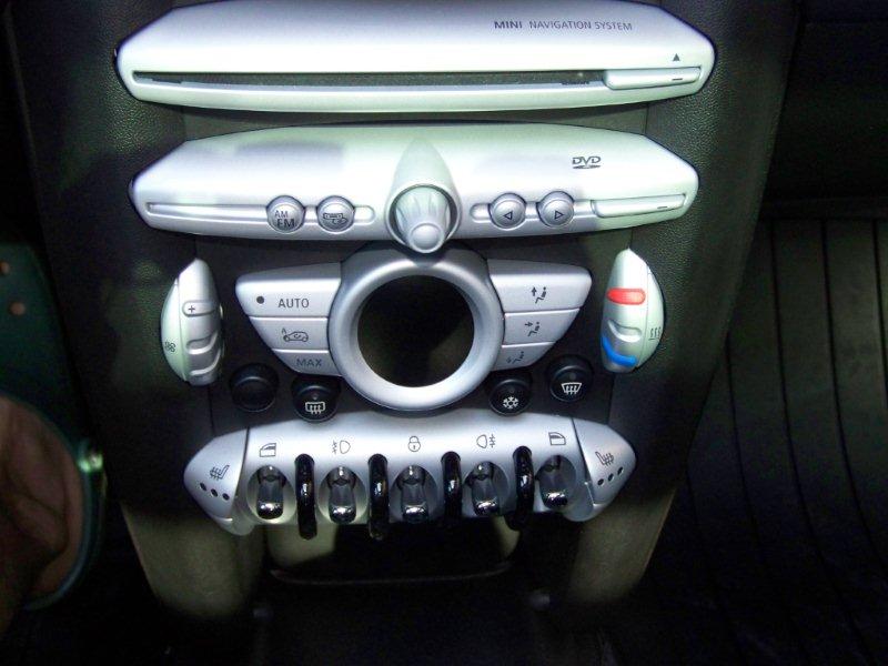

Here's some pics of the full bank of toggles and the rear of the car w/ the new fogs.
Nice work! Looks great...let us know when you get it programmed.
