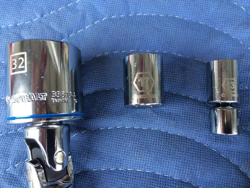

This weekend, I got under the car and changed the oil. From day one, I was never going to just follow only the Boot to Bonnet No Cost Maintenance schedule, as to me, every 10K miles is crazy! If you think spending $60 bucks and an hour or so of your time, to protect your engine in between the manufacturer's recommended change schedule, is excessive, then rock on. I will certainly take advantage of the Mini service that I've paid for in the cost of my vehicle, but I will also change the oil in between their schedule. I personally feel that frequent oil changes (every 4K - 5K) is a cheap and easy method to ensuring a longer life for your engine. In the end, you'll choose the interval you're comfortable with, or wait for the computer/calendar to tell you.
So, for those that want to change their own oil but haven't yet - here are the steps. It's extremely easy and a way to stay in touch with your Mini and feel good about yourself at the same time.
I noticed that some drivers on this Forum remove the entire undercarriage cover to get greater access to oil drain and filter housing. I went with trying to change the oil just using the two access panels to see how easy or not it is.
Ensure the engine has been run and is warmed to operating temperature.
Either jack up the car and place on jack stands or drive the front of the wheels onto a pair of ramps or if available use a lift. For my F56 I will simply use the ramps. It's quick and easy.
Open the hood and then open the oil fill cap to allow the old oil to drain easier.
Getting access to the oil drain plug and the oil filter housing is as simple as turning the plastic housing retainers and then flipping the access panels open. The access panels are located towards the passenger side of the engine (see the first photo). From underneath, you can't miss the outline of the panels. The retainers holding them closed can be turned by hand, no coins or tools needed.
The oil drain plug takes a 17 mm hex socket. Place a good sized oil pan under the rear access panel, remove the plug with your 17mm socket, and drain the oil. Take caution, the oil will be hot. Let this drain completely and then replace the drain plug so you can move the oil catch pan to under the oil filter housing.
The filter element canister has a separate drain plug. Don't skip this step!!!! There is quite a bit of oil still in the filter canister and simply removing the canister will ensure you get hot oil all over the place. Use a 13 mm socket with an extender to open this plug and drain the oil out of the canister. You can replace the plug when complete to stop any further oil dripping while you remove the canister itself.
Using a 32 mm hex socket, I found that I needed not only a socket extender but also an angle attachment (see the second photo). Remove the oil filter canister.
I ordered the Oil Filter Kit w/ O-ring from ECS Tuning plus 5 quarts of the Mini Synthetic 5W-30. The kit and oil are affordable, shipped quickly, and had all the right parts (including the larger sized oil filter element - part no. 11 42 8 570 590).
Take off the old gasket from the canister, apply some oil to the new gasket and replace it onto the filter canister. I also replaced the drain plug in the bottom of the canister housing (since the kit came with a new one, not sure if all new kits have this or not). Then installed the new filter element into the housing. When putting the canister back into the access panel, you will need to use a bit of force to get the oil filter onto the oil flow tube on the engine. The hole in the top of the filter itself will fit snugly onto the tube/pipe. It will sort of "pop on" the first time. At this point, then you can begin to screw the bottom of the filter canister back onto the engine. I didn't bother with torquing it to a certain spec, but made sure it was on snug. At this time, also ensure the smaller drain plug that you previously replaced on the canister is also on snug and firm but not over tightened.
With the new filter element replaced and that part of the job finished, open the oil drain plug again after placing the used catch oil container back underneath. You will have more oil that will drain out! Let this complete, and then replace the old o-ring with the new o-ring from the kit (it may still be in place on the oil pan or it may have fallen into the used oil container; mine was still on the oil pan). Replace the plug, tighten, and clean any residue on the pan with a rag. Again, I don't torque this, personal preference. I go by feel.
Restore the access panels and close the retainers. I was impressed that I got little to no used oil splatters on the panels.
Now fill you car with the 5 quarts of Mini oil. I initially added 4.5 quarts and later checked the oil level with Mini's handy electronic oil level process (I miss the dip stick!!!). It required another half a quart so I added the rest and it's all good. This amount matches the used amount of oil that I removed (5 quarts). Close the oil fill cap and wipe down any dirt, debris, and oil drips.
UPDATE: The amount of oil used in the F56 MCS is actually 5L (5.3 quarts) - Unfortunately quantities of liquids are not documented anywhere in the Owner's Manual (appalling actually). I have driven over 500 miles since this oil change and the 5 quarts I put into the car never got the electronic oil level gauge up to the full mark. I then decide to add 1/3 of a more quart of oil which would then equate to 5 liters and bingo, I'm at the full mark on the electronic "dipstick" (ah yes, a dipstick would have been much more effective throughout this whole process). Actually, just put the fluid quantity in the Owner's Manual and I would never have to put so much effort into this very basic vehicle maintenance job.

I did my oil change and I'd say it went as expected, maybe a bit better (cleaner).
I used car ramps for the first time and they were nice. I had the panels for the oil change which opened easily without tools. And you can see that the panel is held in place with "regular" bolts.
The panels open and are labeled. I'm guessing the + is for the drain plug and the O is for the filter assembly.
There's the drain plug (17 mm) which was pretty easy to remove and the oil drained cleanly through the panels. It's the horizontal one, not either of the two smaller ones staring straight at you.
There's a picture of the filter assembly. The filter assembly drain plug was a Torx T55, which I read somewhere so I was prepared. I needed to use an extender to reach the filter drain plug and it was a somewhat odd angle so it was a bit tight to unscrew. The oil drained out of the filter assembly. I used a 32 mm adapter (also from WMWs) to remove the filter assembly.
I saw that my OEM filter kit from WMWs came with a washer. I didn't see a washer on the drain plug, but I added it there since it fit. I felt around the area and it felt like a washer might have been stuck there, but I couldn't move it and visually, it didn't look like there was a washer there. More oil did pour out after I felt around that area. I oiled up the plug and screwed it in by hand.
I removed the cartridge filter from the assembly, then added the new filter. It just seems to snap in. I then added a new assembly drain plug (since it came with the kit) and torqued it to spec (44.5 inch-lb; note that is inch, not feet). I figured I'd torque everything to spec since it's a brand new car! There was also a new o-ring for the assembly, so I switched out the old one and added the new one in.
I oiled up the assembly and screwed it in by hand. At first, it wasn't taking so I pushed up until it clicked. I torqued the assembly to spec (18.4 ft-lbs). Then I torqued the drain plug to spec (14.8 ft-lbs). I bought the torque wrenches yesterday and am enjoying the confidence of using a spec versus just tightening it as much as I can (which I used to do with my previous cars).
Then I added my 0W-20 Mobil1 oil (5 full bottles and about 1/3 of another one). I turned on the car, it gave several warning (mainly the hood was open and the door was open), but it said that the oil level was acceptable. I couldn't measure it though. So I'll have to drive it for 30 minutes then measure? I guess I'll do it tomorrow when I go to work. (That's kind of annoying, honestly.)
