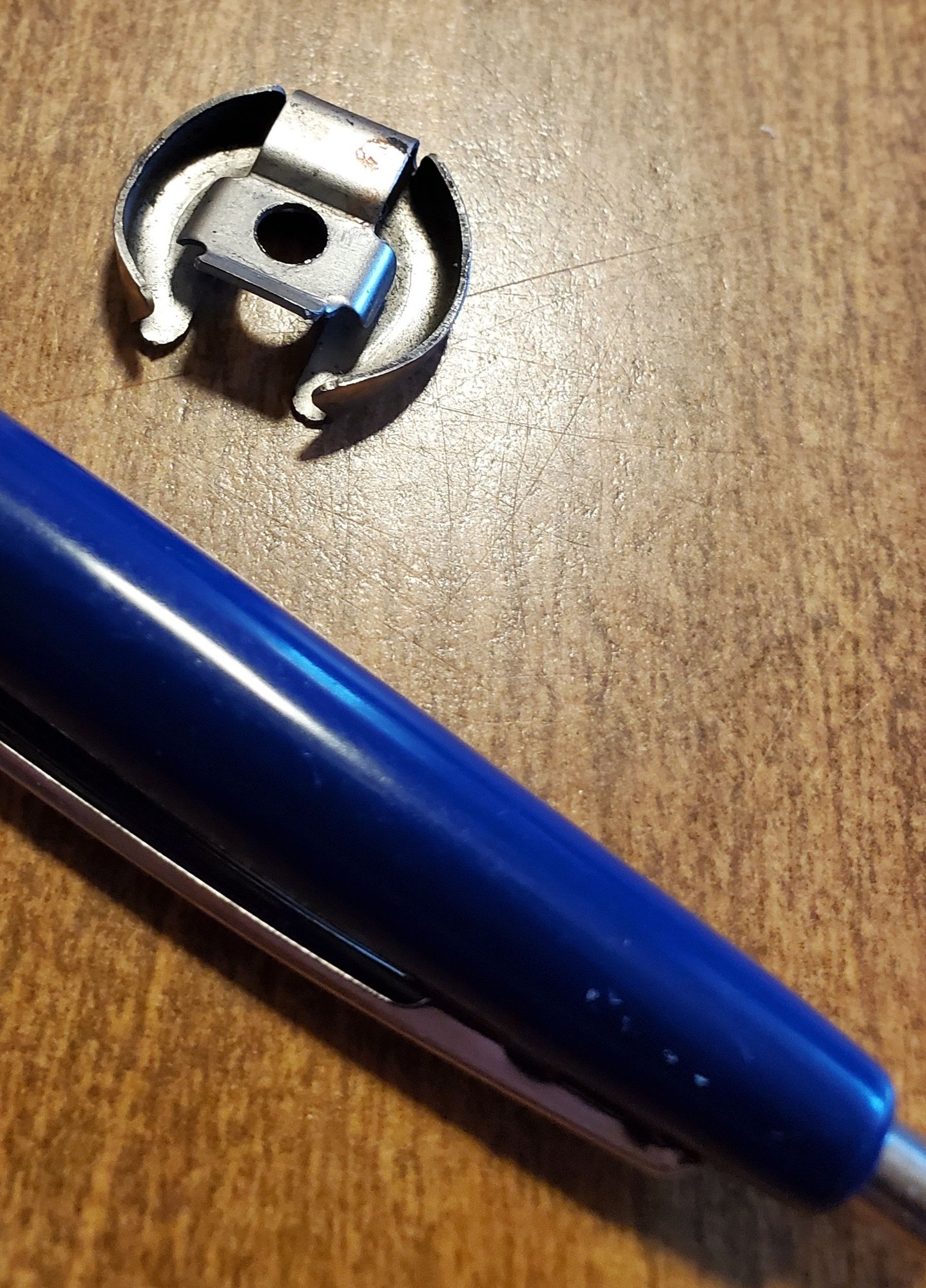

Can anyone give me some help installing this clip at the end of my shifter linkage? It looks different from the original clip and not sure how it goes, or even if its the right part. The part number dealer gave me is 25112754813. Even a picture of it installed on your car would be great.
Here's the existing part:
Here's the new part:

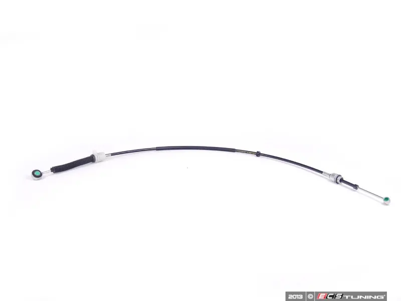

For this cable: https://www.ecstuning.com/b-genuine-...r/25117594646/
On the end near the transmission.
Snaps on the ball end on the transmission https://www.northamericanmotoring.co...spd-trans.html
Then the clip finishes the job after the cable link is snapped into that.

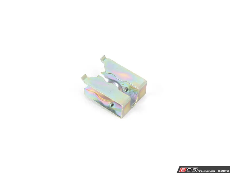

https://www.ecstuning.com/b-genuine-...e/25118609053/
It holds those cables in places. Narrow U clip side goes down and slides in from side, pair of pliers should work.

This is VERY helpful, thanks. I'm thinking the part I call the old clip goes onto the end of the shift rod FIRST and then the clip i pictured as the new part slides over the top, keeping everything together. Agree? Picture of Clip installed anyone?

That's how I would understand it to go together. The clip becomes the secondary point of security.
