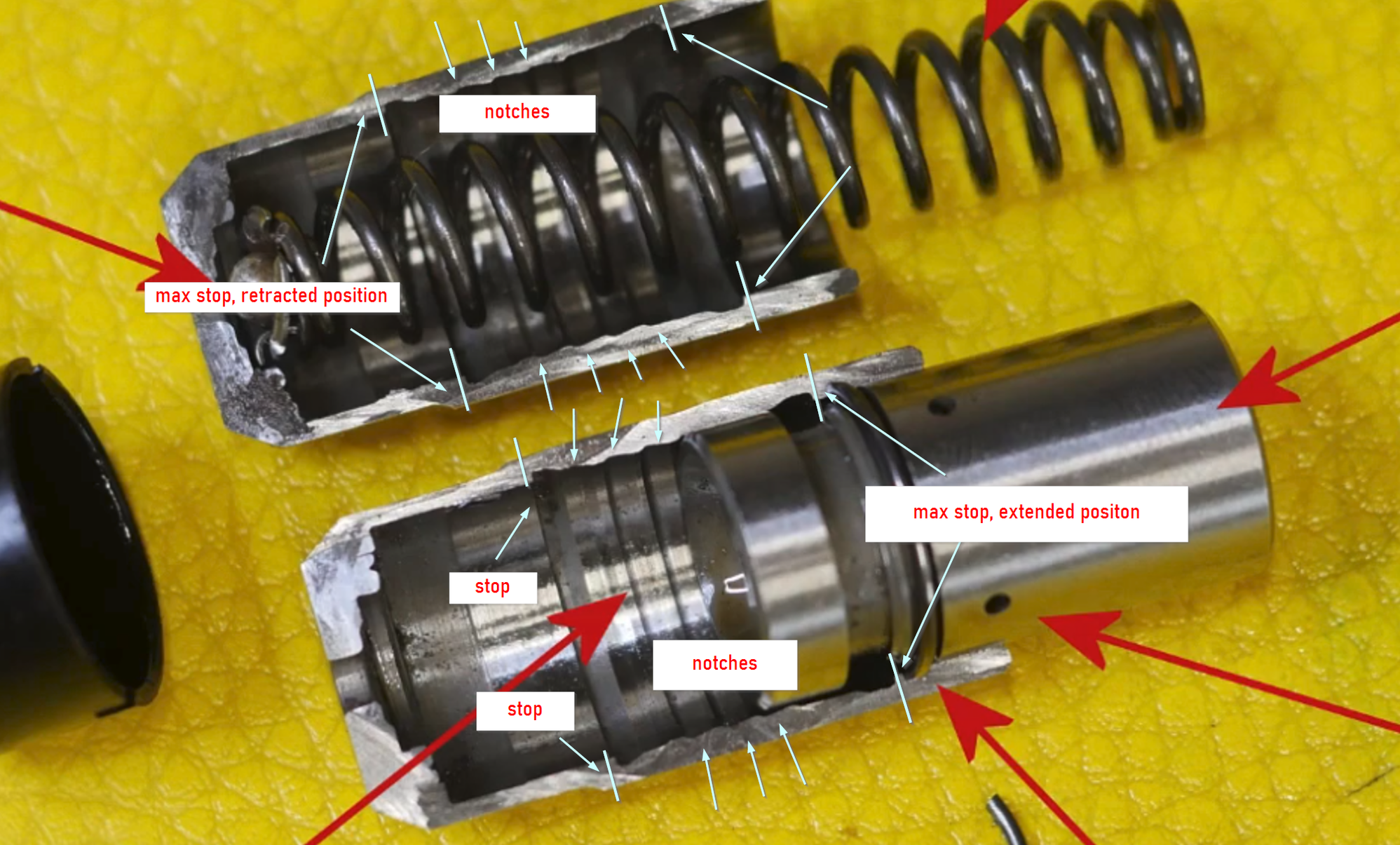

Okay I went deeper as to how this tensioner really operates.
Based on this assembly and also my simple analysis, ( looks like ) TENSIONER is not activated by oil.
It's riding on its internal spring, the oil is only there for the Tensioner's lubrication.
So when people say the tensioner is sticking, does not extend... it's due to a broken SPRING not oil, clogged dirty. It could be broken in half, or maybe part of it, which is still works but not as when it was in original state, the required tension is no longer pushing the chain guide --- not enough force.
Check this assembly below. I got this from you tube.
Tensioner assembly
Tensioner assembly
Okay some may argue..... "Dude you're high again" ---- It's the oil that's pushing the tension!!!!
Here's another image.
You see the boundaries for maximum stop for retracted and extended? That's full mechanical stop you can't go pass that, even that big SPRING can't go beyond that, it is held by the "spring clip" it stops there.
As for the oil??? We all know fluids like air and liquids, they always go for short distances, they want to flow to less restrictive areas and the tensioner is designed to have oil holes\passages to exit out... it's like your brake caliper which is sealed, pushing the brake pads to clamp the rotor., but put a leak on the caliper or open the bleed nut, it's guaranteed it will NOT push the pads, brake fluid will just flow out., same what is happening on this Tensioner, they designed it like this. It's not the oil giving the tension, it's the SPRING. Or maybe some small oil pressure to reset the position, did you notice the notches?
For the question how the tensioner go bad?
I think the tensioner goes bad when we put too much stress on to it by revving past 4,500 rpm and beyond.
At these engine speeds the chain goes straight, pushing guides back, which is then compress the TENSIONER's spring ( retracted ) oil flows out more out of the tensioner,--- of course it will not go bad right away.
So say we keep hovering around 5000 rpm and up most of the time, due to stress one day that spring will snap. This reminds me of that bypass valve spring the one that creates yoyo...on early R53s most of them got broken spring. BMW updated it with beefy springs.
As for notches., I think they put that there for the spring clip to glide in to and stay there for a certain RPM speed, it's like a transmission for the tensioner. So if you go 5000 rpm and above the tensioner is on retracted position and when at idle speed say 650-800 rpms it's on extended. then 1,500, 2500, 3500 rpms those are the for notches in between.
It's that one big spring is the one doing the most of the JOB, the oil is only a cushion to prevent premature wear, cool it down, and again maybe some oil pressure like to cushion the spring back and forth action of the guide, like the struts\shocks? so the car is not jumping when it hits a bump.
