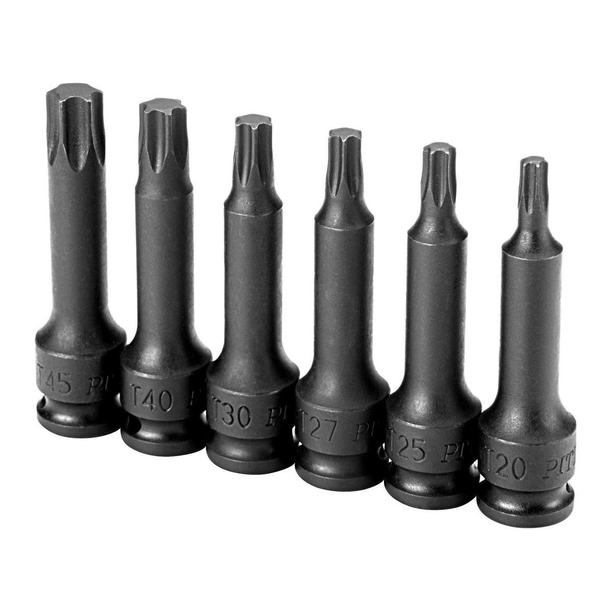

1. you need a T40 torx bit and it has to be long enough and thin enough to fit through a hole on the moving arm of the shift unit. I'd say the tool has to be at least 30 mm long (1-3/16 inch) and under 10 mm in diameter to fit. Harbor freight makes a set of 1/4 inch drive bits that works great.
https://www.harborfreight.com/14-in-...ece-68015.html (see below), but something longer will also work. There's stuff available online but I needed something local so I got this.
