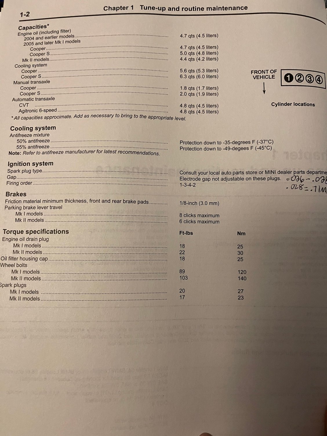

Old Jan 28, 2021 | 08:38 AM
Jason Cornelius's Avatar
Jason Cornelius
Joined: Dec 2019
Posts: 2,107
Likes: 691
From: Cincinnati, OH
From Haynes Repair Manual
