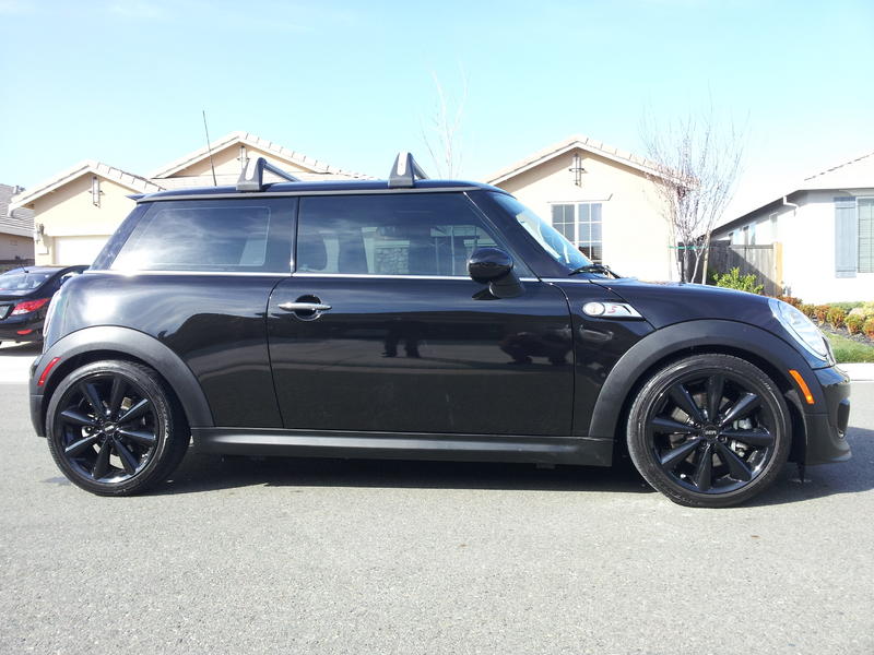

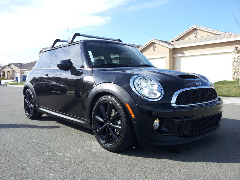

just sharing some pics off the eibach springs i installed this weekend, not to low and not to high, seems perfect for a dd. road feel feels smother than stock but the cornering def improved.

Which springs? Stock shocks?
Old Feb 26, 2012 | 05:26 PM
m3sparky's Avatar
m3sparky
Joined: Feb 2012
Posts: 95
From: nor cal
eibach pro kit, stock shocks for now, until i can afford the shocks i like. kyb

Originally Posted by KevinC
KYB?? Good gawd, why? Go Bilstein Sport or Koni Yellow.
whats wrong with kyb? i had a good experince with them on the m3. do members prefer what you listed as the best shocks for the buck?
i noticed quite a bit more bounce on bad freeway roads. would the diff shocks eliminate most off the bounce?
Old Feb 27, 2012 | 05:42 AM
richardsperry's Avatar
richardsperry
Joined: Sep 2009
Posts: 2,247
From: Eldersburg, Md
KYB on a M3? Really? Try posting that on the M3forum...They'll crucify you...
You need help...lol
The reason it's bouncy is because you don't have enough shock to control the stiffer springs. The stock shocks are valved to (almost, sort of, kind of) control the stock springs, which are kind of on the soft side anyway. If you install stiffer springs (which lowering springs are), you need a stiffer shock to control them. Another vote for Koni or Bilstein sports.

what size wheels are u running on that mini
Old Feb 27, 2012 | 04:42 PM
m3sparky's Avatar
m3sparky
Joined: Feb 2012
Posts: 95
From: nor cal
factory 17s x 7
