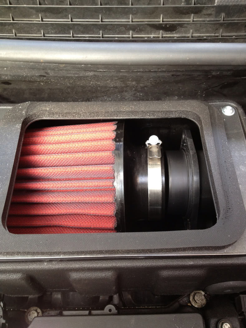

Hey all, I've had this kit installed for a few weeks now and after some observations with intake temps etc I found that the intake is sucking in hot air from the engine bay area.
On the picture below you can see that the scoop feed is not sitting flush/correctly on the rubber seal. Has anyone on else had this issue, and how have you solve it! Seems like a stupid little flaw for such a great bit of kit.

nothing to do with the fit ---but the airfilter is not connected to the inlet tube

MAF sensor doesn't look to be threaded thru the grommet. Maybe he was working on it?

Surely the fit is an issue if the scoop feed is leaving a gap in the seal. Has anyone else checked the fit of theirs to see if its a manufacturer issue, or an issue with fitting?

UK car. Non maf. I have an adapter for the kit. Just means i have that little hole there for now.
It would be nice to see if anyone else has this issue. Surely I cannot be the only one?
You noticed too? :D this is how i found it when I opened the bonnet. It has been off for some time too I think. Drove 15 miles earlier along motorway and it was nearly off again. Another issue that is starting to arise...how to keep it on?

Just checked mine. All looks correct. Contact aem they have great customer service. I am sure they will help you out.

To test the fit of the hood scoop duct to the air box after i had to make a modification to it for my strut brace I used play-doh with saran wrap on the airbox seal and closed the hood. This left an inpression on the putty as to how tight the hood scoop duct was fitting onto the seal. This is an easy way to find the leak.
Also the turbo heat shield should be used to prevent heat damage to the duct as well as heating the air inside the duct.
