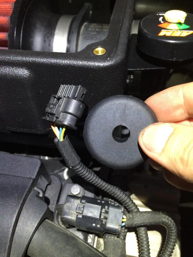

Ok mid install and not really sure how to get the MAF harness thru the small round hole in the grommet.
Do I need to cut it and resplice it? Do I disconnect the other end to feed thru the hole?
Sorry if this has been answered elsewhere.
Any help greatly appreciated.
UPDATE: never mind... I'm a jackass... its split... haha... long day

From the picture. It looks like it pulls apart to feed the maf cable through?
Thanks MNEWRTN. Realized that right after I posted.

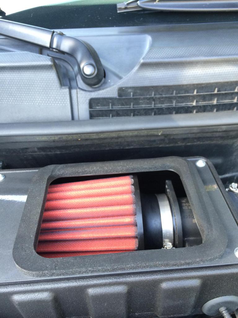

It doesn't look like the hood scoop tunnel is meeting up exactly with the opening in the air box.
Any advice on how to align it better?
Everything seems to be running fine. Not 100% sure its not fully covering the opening, but looking at the impression in the rubber gasket it looks off a bit.

I had an alignment issue with my AEM airbox, I made rubber tubing to shrink the holes where those plastic pegs go, if you remember the holes are larger that the pegs which hold it under the hood. It is allowed to move, align and stop this movement.

Thanks Systemlord. You are referring to three pegs for the air box itself correct? It doesn't really seem to have much play, but I'll take a look and see if I can secure it a bit further.
It's what mounts the air scoop to the underside of the hood, there's four plastic push pegs with ribs. Get some different size rubber fuel hose and cut them almost in half, more like 3/4 of the hose will take out that play. Inset the rubber hose into the hole where pegs go, you can experiment by cutting more or less of the rubber tubing.
Yep, thats exactly what I have going on. The intake tunnel moves quite a bit.
I was just out in the garage examining it. Even used the GoPro, light and my iPhone to check for light leaks...
youtube vid here if anyones interested...
I'll have to pick up some hosing this weekend.
Any advice on getting the plastic push pegs out? I gave it a good tug and it didn't come freely... I have a tendency to pull too hard and break things.
You're going to have to really pull on them hard enough to order new ones, I ordered dozens of them and a spare sponge gasket. The uneven pressure will wear quickly on areas where there's pressure, it will flake apart. I had mine perfectly centered then found out I like the stock CAI. Some of my pegs broke into pieces are still inside my hood forever.
