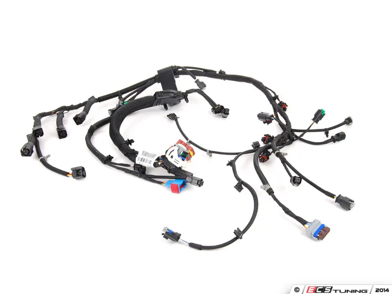

I was driving home today and the sound dampening mat under the hood came loose and inched it's way onto my turbo unit and caught fire. It melted the wiring leading to the ignition coils along with the coil packs and also burned a hole in my valve cover. Does anyone know if the wiring coming from the coils to the coil packs is sold separately or do I have to buy an entire ignition wiring loom? Any help would be greatly appreciated.
Old Jan 25, 2023 | 01:57 PM
Posts: 36,758
Likes: 2,548
Here you go, up to 9/2009 N14 Engines: https://www.ecstuning.com/Search/Sit...h/12517567114/
9/2009 - 3/2010 N14 Engines https://www.ecstuning.com/b-genuine-...s/12517585952/
3/2010+ N14 Engines: https://www.ecstuning.com/b-genuine-...s/12517646453/
No other part sold on that harness. Only other way is to rewire the bad parts. Do you have an 2009-2010 R55 S N14 Engine?

It's a 2008 S.
Old Jan 26, 2023 | 06:30 AM
Posts: 36,758
Likes: 2,548
ok then its that top one.

Thank you. Looks like my weekend just got more expensive and busier.

Only other options is to have someone or yourself rewire and wrap.
Thats the tape they wrap with after the wires are all connected and soilder/sealed : https://www.ecstuning.com/b-genuine-...m/61136920760/

That could be an option if the shielding did not bake off completely.

Yikes, sorry to see that. Yea you are going to need a harness, valve cover, coil packs. etc..
Replace that sound dampening and get new clips. https://www.northamericanmotoring.co...ay-or-nay.html
