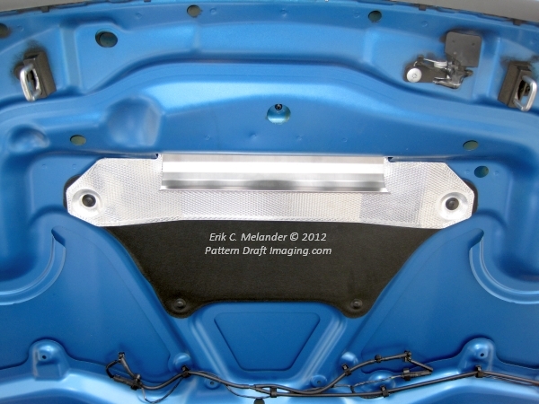

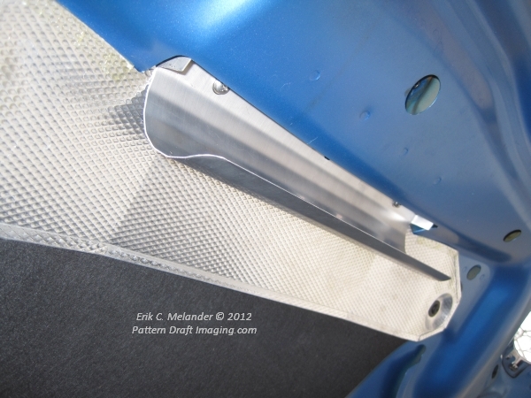

1.) since I've owned the vehicle with 4500 miles on it.
2.) no, it just isolates convection and radiative heat transfer.
3.) see below...
4.) I've been in for several service stops at a pair of dealers without any question or issues...
To remove heat off the hood scoop, I'm using the:
* factory installed 'sound deadening' - P/N #51482755612 (black material) w/ Expanding Rivets - P/N #51481915964 to mount
* OEM Alumnium "Thermal Insulation for Air Inlet Grill" - P/N #51482183986 (heat shield - in bright silver)
* fabricated stainless steel vent scoop (dark silver) that I produce and make available to owners
- Erik
