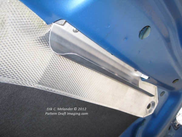

Based on the photos of bluefox280 bonnet, and looking at my bonnet, it looks like the attachment points on both the old and new hoods match up. So part number 51482755612 should (key word should) fit. I'm going to mention this to my dealer the next time I am there...see if I can get it installed under warranty to hopefully fix the bonnet heat behind the scoop.
Also, part number 51487307579 should work just fine on any Gen2 MINI with the newer hood...not just the R58/R59.

How is this setup doing at keeping the bonnet cool? Specifically the area behind/above the bonnet scoop?
Quite well comparison to not have it before.
Prior to installation, I wasn't able to touch the bonnet during summer drives; now I can place my entire palm.
- Erik

Erik, do you still sell these simple metal "partial rolled" pieces?
Yes - I still offer the Curved Vent Scoop for the 2nd Generation MINI R55 / R56 / R57 / R58 / R59 platforms.

WOW, this large piece (MIN P/N 51487307579 ) is almost half the price of the small piece (MINI P/N 51487136797) that just replaced the OE fabric heat shield (Mini p/n 51482755612 ).
MAN thats a MUCH smarter choice!!!! I bought one of BlueFox's curved turbo cooling shields and along with the two other factory parts (grey fabric and metal heat shield), I'm covered off (just like BlueFox's under bonnet pic.
