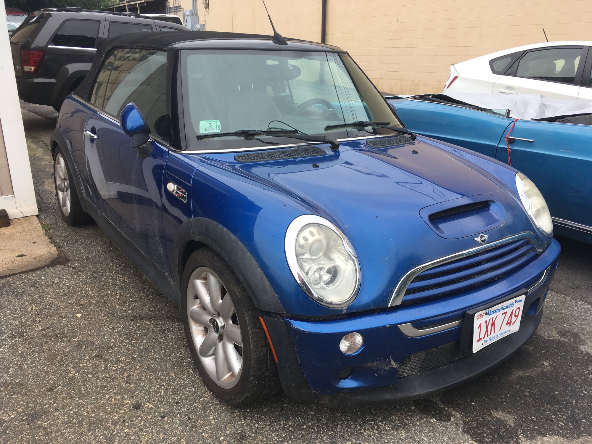

A continuation of my intro thread in 1st Gear
Known problems so far:
  • Fuel gauge not registering: Half a tank of new premium fuel and a new fuel pump are in place, but the MINI doesn't seem to realize it has fuel in it, with a flat fuel gauge. Attempts to reset the ECU ran into a problem when using the amazing guide by shorty_du_op. Specifically I get stuck at step #5 when I get into the system but am supposed to "scroll through" to choose the next option, but how do you scroll with just one button to push? When I push the button at that step it seems to revert back to simple odometer function.
  • No spark in 3 out of 4 plugs: Spraying starter fluid into the manifold had me hearing the engine trying to turn over. suggesting a fuel problem, however after checking spark plugs it seems like the engine was only working with one functioning spark plug.
  • The car sat for about a 12 months with the stick in neutral and I cannot shift it into any gear position. Seems as though the linkage is frozen.
  • MORE SOON
Additional items on the agenda:
  • All four rotors will be replaced
  • New wiper blades
  • The center brake light lens is missing with exposed LEDs
  • The rear tail lights stay on after turning off the car with no obvious reason why
  • New oil and filter
  • New air intake filter
  • New cabin air filter
  • New tires: the car was purchased with 215/45/R17 tires on it, but every source I can find suggests the stock tire is 205/45/R17. Unknown if the previous owner was simply trying to get a larger contact patch on the ground, but I will go back to recommended tires.
