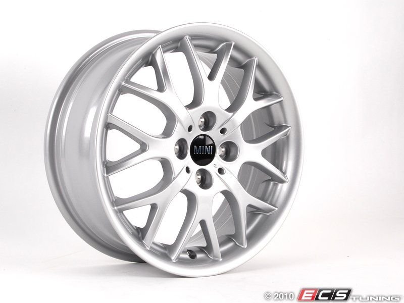

ECS has a SMOKING deal with FREE shipping on some beauties... R90 Factory Mini's
Bolt on and go... has that nice Challenge-Car/JCW 'CrossSpoke" look too !
Be aware that there are two Factory-MINI "R90" wheels... one in 16" and one in 17"
https://www.ecstuning.com/b-genuine-...h/36116775855/
