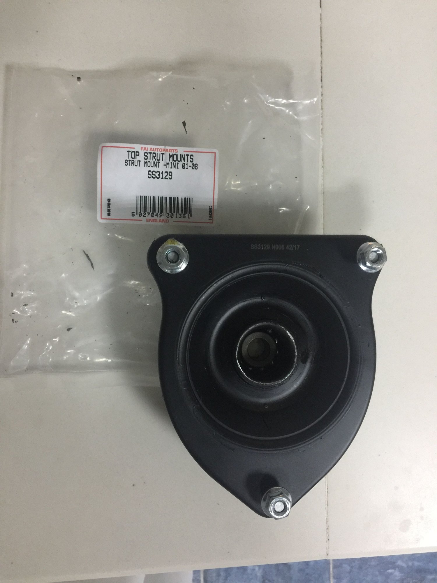

So I had some goodies delivered this weekend...Bilstein B4 shock and strut kit, Nebraska camber plates and strut top mounts ...
Nebraska Camber plates look pretty cool - like the way they bolt into the strut top mount - can replace just the strut top mount on its own in future.
These strut top mounts didn't come with the washer that goes underneath the bearings and sits on the strut shaft - will need to recycle the old one.

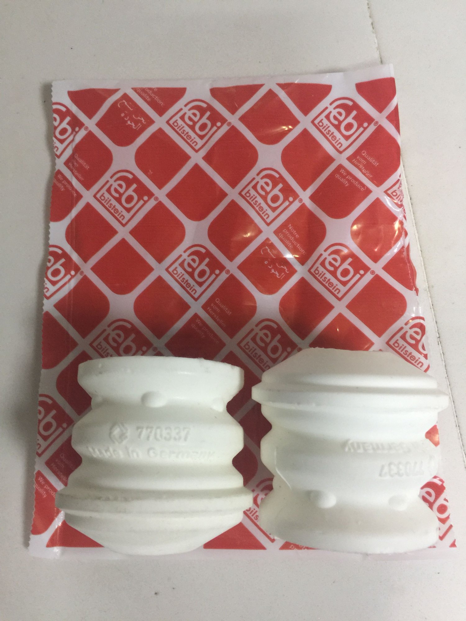

Pretty substantial bumpstops for the front struts - not much suspension travel I'm guessing with these fitted -
Solid looking shocks - again pretty substantial bumpstops compared to the length of the strut shaft - I guess not much by way of suspension travel again
Has anyone tried trimming the bumpstops down a little to allow a bit more suspension travel before bottoming out ? Should improve handling I'm guessing - and maybe even softer over bumpy roads ?

I haven’t seen the need to trim the bump stops on either of our MINIs. They seem pretty well designed to work unnoticeable with the stock height springs. People do trim them, but I think it is done when people put in lowering springs.

Like Eddie wrote, if you’re going to stay at stock height, the bump stops do not need to be trimmed.
With H-sport lowering springs, our R53 dropped about 20mm so I trimmed the rear B4 bump about that much (from the top portion) and 20mm from the front stop (lower portion)
