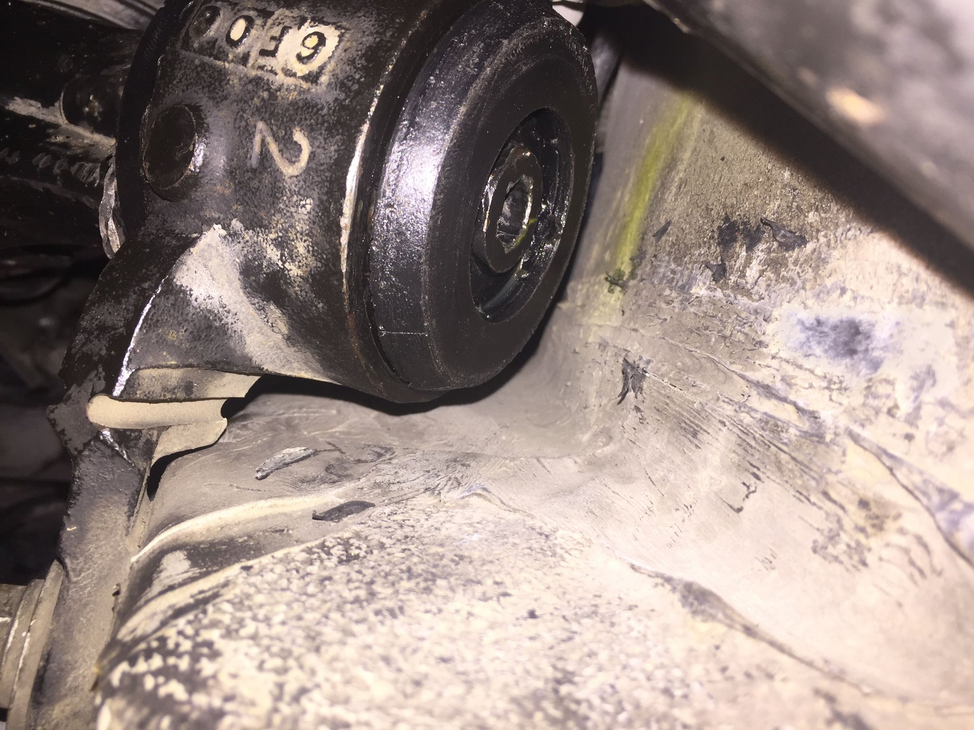

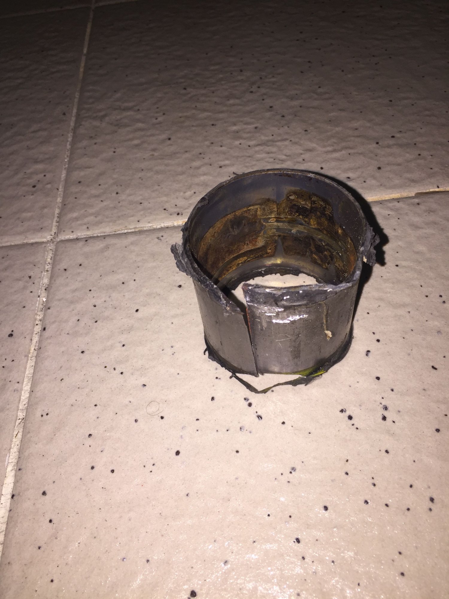

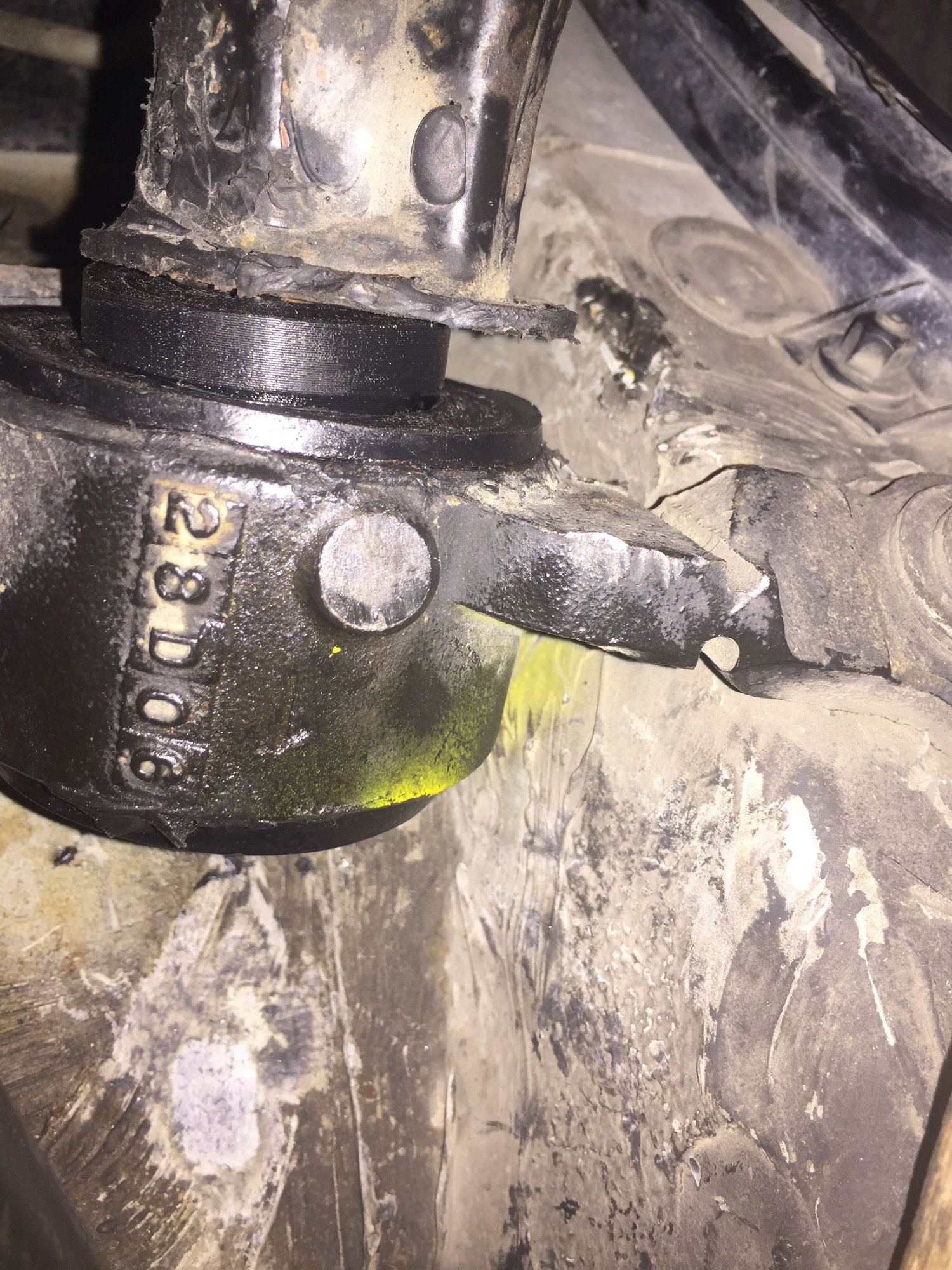

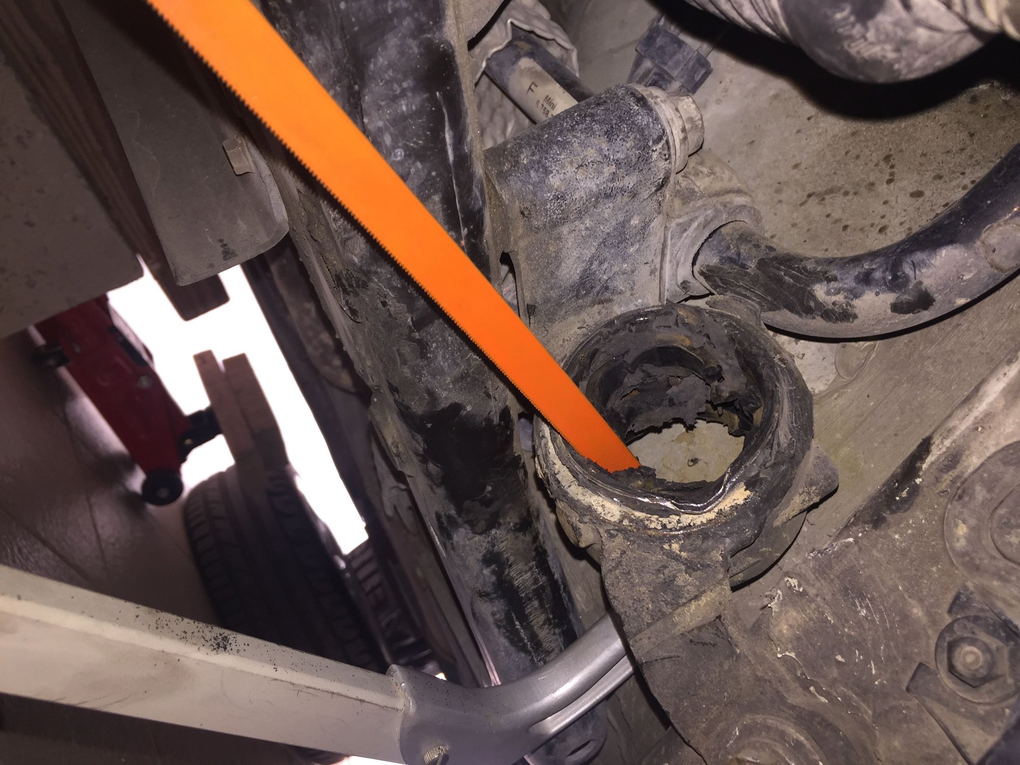

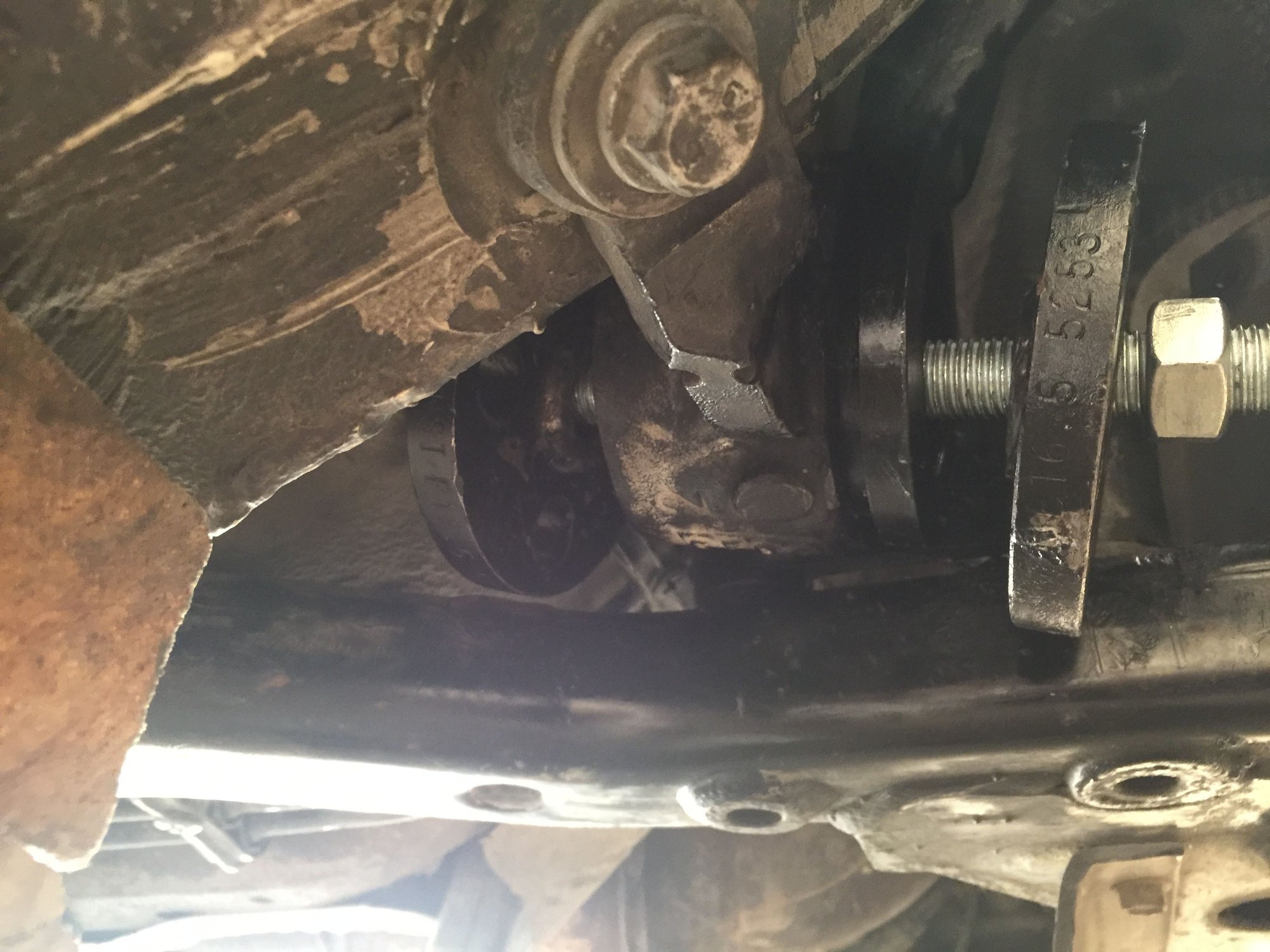

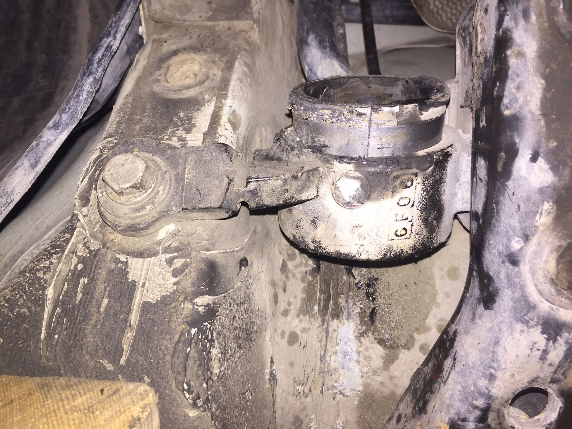

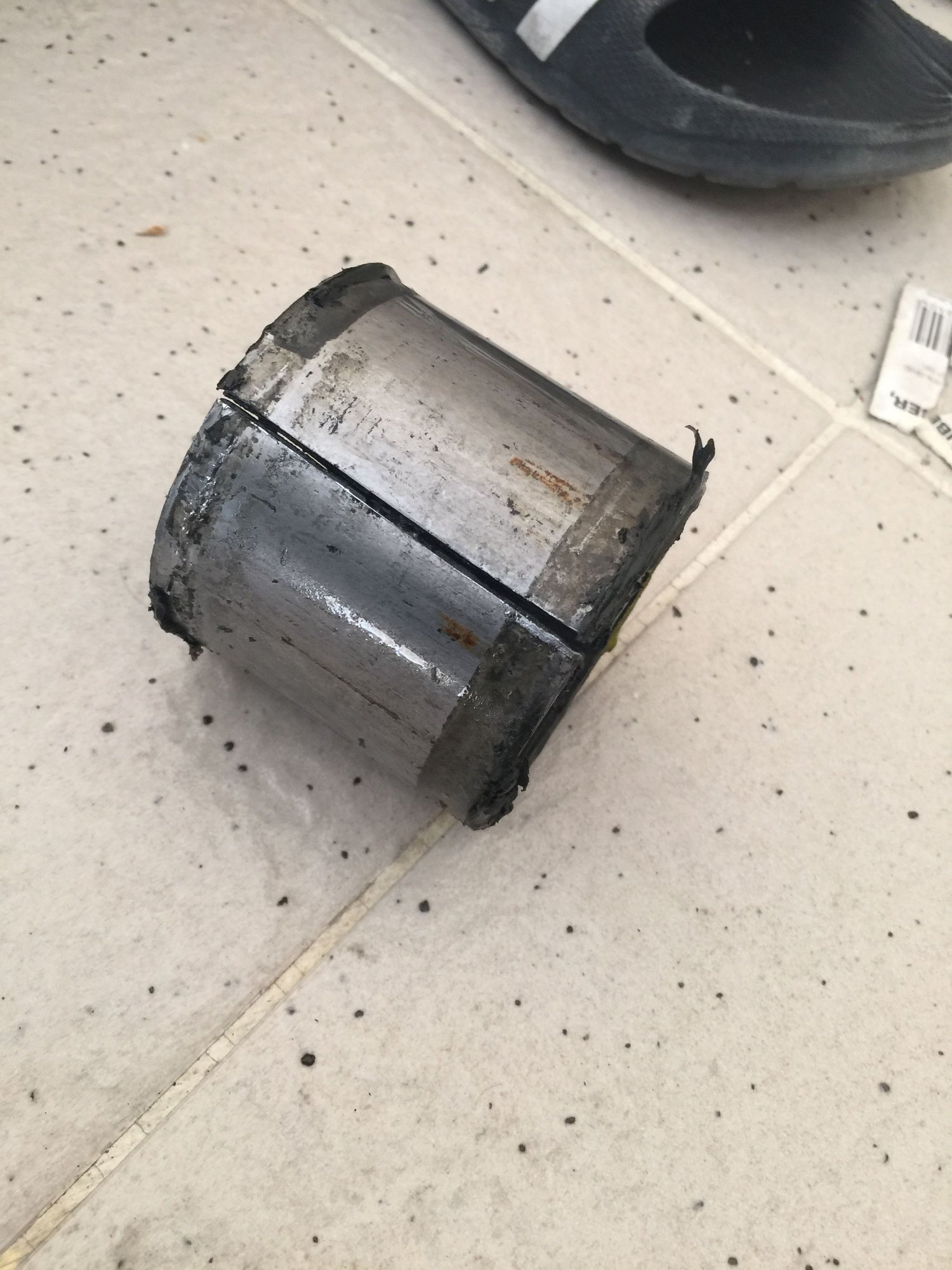

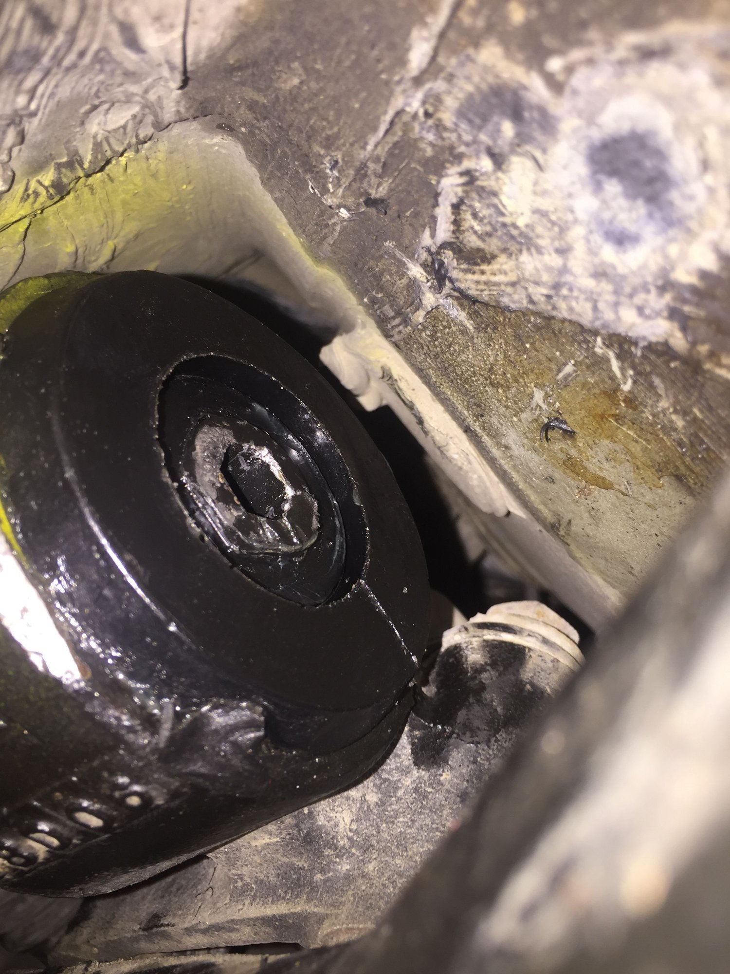

Well after a short delay in proceedings the front LCA 2 piece poly-bushes and new ball joints are done, and inspection passed.
It was another 'first time' job for me and NO youtube video that I watched could have prepared me for what transpired. 'ModMini' does make it look very easy, and instills confidence but he does also seem to ‘airbrush’ over some of the potential sticking points, which I’m sure he must have encountered too at some point. Anyway, here’s my key observations, for what they’re worth, which may help others out:
  • removing the old LCA bushes is not to be under-estimated, especially if you are going to do the job with everything in-situ on the car.
  • I used the ‘hammer method’ for dislodging the inner and outer ball joints from their holes in the LCAs – depending on how seized-on they are, you might need a pickle fork tool to assist – this may be easier but runs the risk of damaging the rubber boots on the ball joints – which is not a problem if you are replacing them anyway.
  • to get the LCA actually out of the rear circular shaped mounting bracket, you need a combination of pulling/twisting and a large pry bar, to basically rip the old bushes apart.
  • you will then need to remove the remaining outer casing of the old bush, which gets left behind in the mounting bracket, as this was pressed-in originally.
  • ModMini uses an electrical reciprocating saw to cut through the casing, which certainly saves time. If, however, you don’t have such a saw, I can confirm that a 12 inch hacksaw will work, with a plentiful supply of new blades to hand and strong shoulders !
  • replacing the inner ball joints does require removal of both the driveshafts - which run directly above the front bolt attaching the ball joints to the sub-frame. This particular bolt is also very very hard to undo by hand, even with plenty of penetrating fluid applied - an electric or air impact wrench would be awesome here, but there's not enough room to use one, doing it this way.
  • replacing the LCA into the new bushes can be a tight squeeze and its hard to get the LCA hexagonal shaft bit (with the new poly-bush on) to go ALL the way into position – the last 4-5mm is particularly tough.
  • trying to get the new inner ball joint into its hole on the LCA was also a pain - what finally worked was positioning the inner ball joint by partially inserting the front bolt first (just a few turns), and popping the ball joint into the LCA hole BEFORE pushing LCA inwards and locating the ball joint over the hole for its rear bolt - such a satisfying feeling being able to get the poly-bushes squeezed together that final bit more.

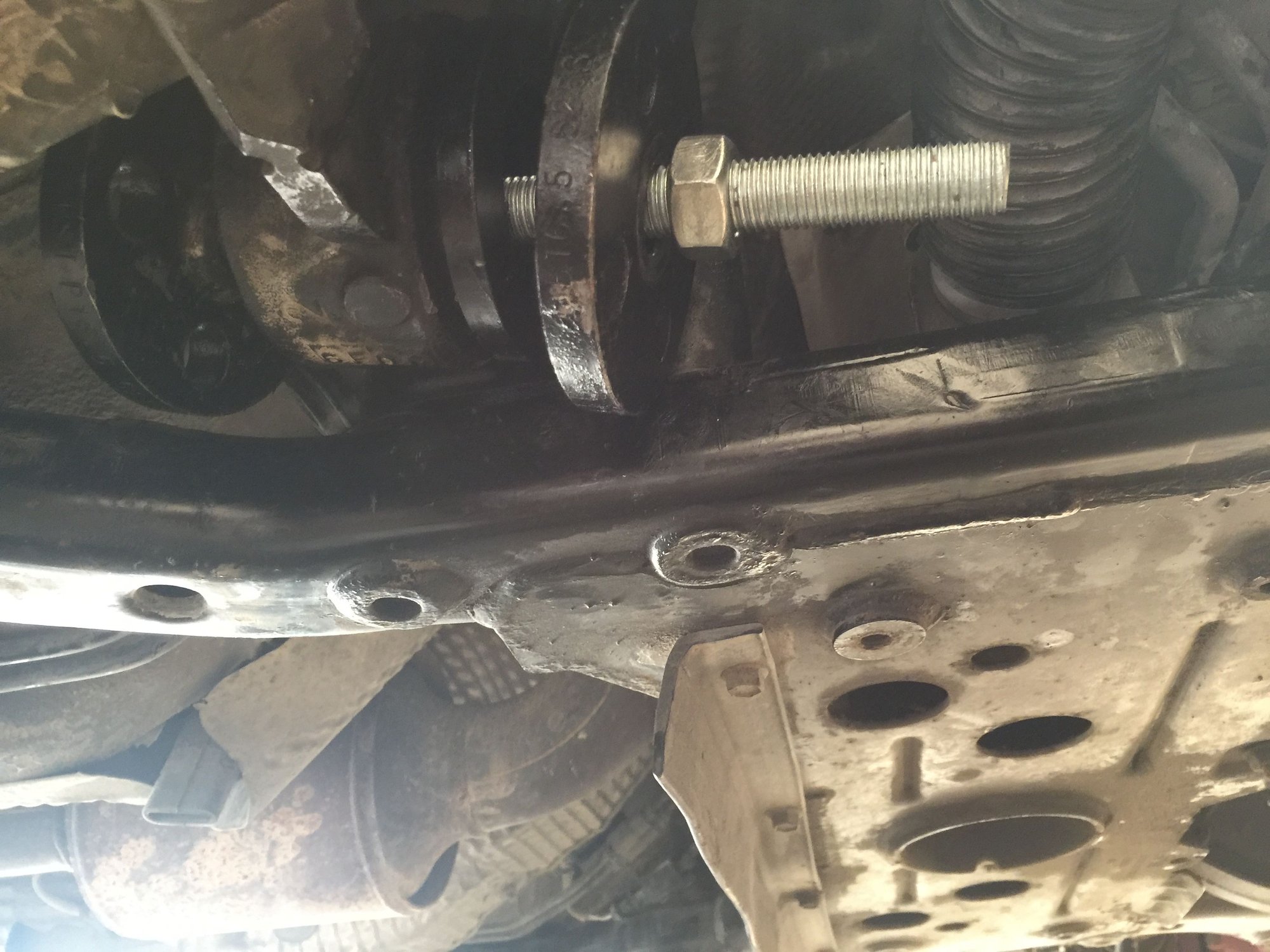

Yes I missed a few things yesterday as I was in a rush. In terms of if it drives better, I haven't really pushed it yet, but on a couple of familiar sharp turns I take every day, it does seem a bit more planted and the stability control doesn't cut in as much it seems.
I also forgot to mention the process of pressing in the new bush, does require a fairly hefty bolt (M16 by 175mm worked well) and 2 suitably beefy flanges - as you will see from the pictures below. I initially used a M10 bolt but this is just not able to cope with the pressure required to squeeze the poly-bush into the mounting bracket - the bush actually folded in on itself and actually bent the bolt.
And once pressed into place, the new bush actually gets in the way of the bolt as you try to pull it out. So you need to gently tap it out with a small hammer
Anyway here are some pics of my latest fun and games......

I think once you push it a bit in a few turns, you will notice a difference. When I did mine, it was with the installation of the front and rear sway bars and the Quaife LSD. So I am not sure how much of what contributed to what. But I am pretty sure the improved tightness I felt was those bushings. Others who have posted about changing them have noticed a difference.
With all the effort you went through, have you thought whether it might have been easier to lower the subframe enough to pull out the whole bushing and holder instead of doing the bushing change in place?

I actually looked at dropping the subframe at the point when I just couldn't press the new bushes in using the bolt technique. But watching videos of modmini and other people dropping out the subframe, looked like a mission too. So the lesser of the 2 evils was to try again with a bigger bolt. And don't forget, even with the subframe dropped, I would still have to press in the new bushes into the carriers somehow. Thankfully the beefier bolt did the trick- it takes a decent amount of pressure to squeeze those poly bushes- rated at 80A hardness.
It was probably the most physically demanding job I've ever done on a car- but equally satisfying to have overcome the challenges and finally getting the inspection passed.

I have done the LCAs on two cars now.....once by the method you used, and once by dropping the subframe. I’ve determined that regardless of the method, THE JOB SUCKS. LOL

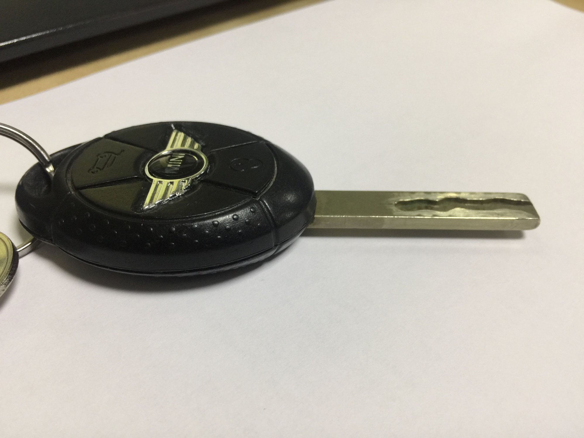

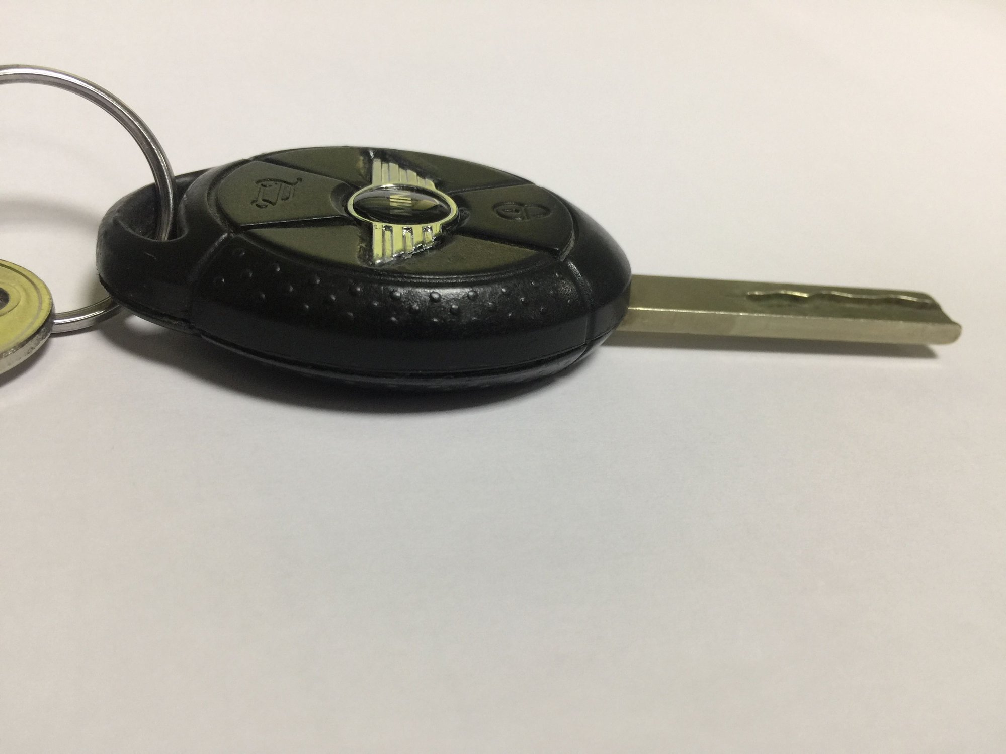

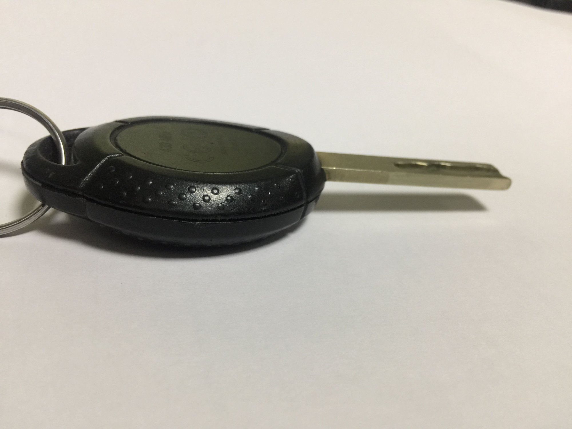

Quick update - just replaced my remote key fob battery - the rechargeable type (Panasonic VL2020 -90 degree type) - and followed the initialization procedure to activate the remote control - how nice it is to have remote control central locking But I still managed to lock the doors using the key again this morning - it will take a bit time getting used to it
Apparently the key is a sealed unit from the factory and shouldn't be opened up according to the local BMW garage, as removing and replacing the soldered in rechargeable battery will damage the circuit board and render the key useless - a new key would cost $450 - plus 'cutting and programming'. I looked on YouTube and after watching others it didn't seem to be too difficult as a DIY job.
You have to cut the key open along the seem, by sticking a stanley knife blade in (not too far but just far enough) between the 2 halves of the key fob, starting from the top centre. It doesn't take much to cut through the plastic - then remove the little circuit board and heat up the solder on the battery terminals and at the same instant lift the battery away, one terminal at a time. The solder should remain in tact if you are careful and is enough to hold the new battery terminals in place - and inserting the new battery is done one terminal at a time too. There is a round black plastic sticker on the back of the old battery which should also be swapped over, as it looked like it was insulating the battery from the circuit board. After sanding the surfaces of the key remote fob nice and flat, where the initial cut was made, the circuit board can be replaced and the 2 halves super glued back together. Then you have to initialize the key to the car again as follows (thanks out to Lotter1 for posting this on another thread):
Initialize remote key fob as follows:
1.) Close all doors
2.) Switch the ignition switch to KL-R (first turn), switch back off within 5 seconds and remove the key
3.) Within 30 seconds, press and hold the unlock button and at the same time, press and release the lock button (3) times. (Must be completed within 10 seconds)
4.) Release both buttons. The doors will lock/unlock to signal a successful initialization.
5.) If additional keys need to be initialized, repeat steps 3-4 within 30 seconds
6.) Switching the ignition to KL-R completes the initialization
And Robert is your Father's Brother. Happy days. Some customary pictures:

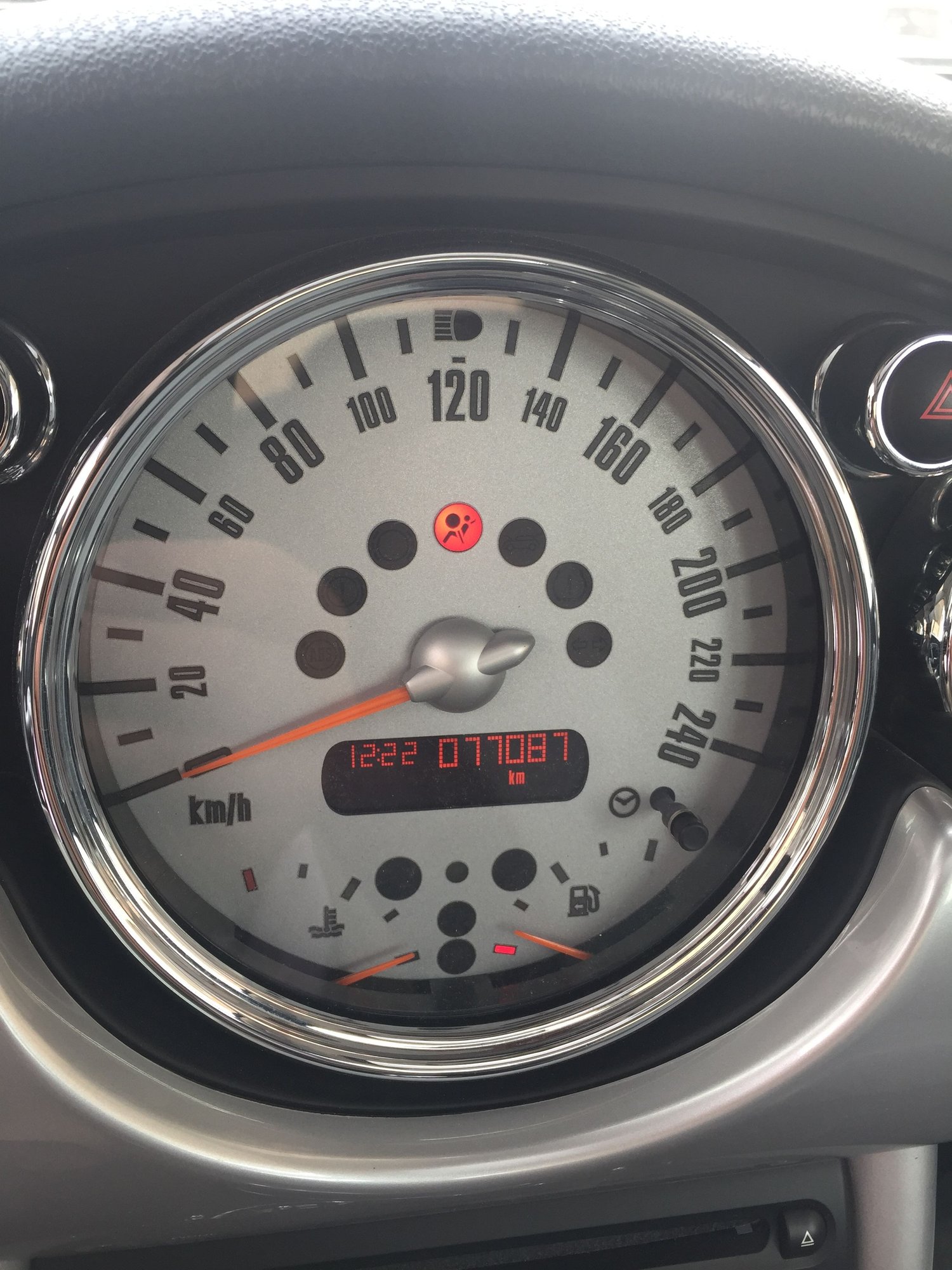

Couple of annoyances have transpired - the airbag warning light has come on for some reason and there seems to be slight traces of coolant leak - as per pics. Any suggestions please on how to reset the airbag light and where the leak seems to be coming from.
What is that square shaped box the 2 pipes are going into ?

As for your car, and the air bag light, I would look for a loose connection or broken wire in the seats. There is a connector under the seats for the air bag. Also, get a code reader and see if it has code that might point you in a direction.
As for the coolant leak, sorry, I have no experience with the R53s. But it sort-of looks like the oil cooler that is on the R56, but in a different location. Hopefully someone else will chime in on this one.

It seems no other chimes needed - looks like you guessed right - oil cooler it is. Another job for the cooler months methinks.
