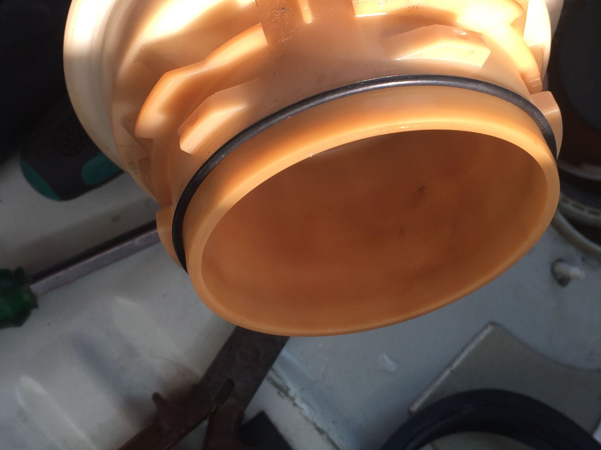

Well I braved the heat earlier and went outside and pulled the fuel filter again- the garage said they checked it but I wanted to check it again for myself. On close inspection it did indeed look like the top part of the filter housing was not tightened all the way. In the first pic below, you can actually see that there is a bit more travel left before everything lines up.
After removing the top, I also discovered that the O-ring had somehow stretched and was now too big to fit. So looks like when I fitted it, the O-ring got trapped out of place as I pushed the top back on to the housing.
I tried to find the original O-ring to re-use that, but couldn't remember what I did with it- (I've actually just remembered now while typing this up ). How annoying.
But in the time it took for me to look for the old O-ring the new one seemed to shrink back to size. Result !!!!
It did feel like the O-ring wasn't seating properly and it took a good 5 or 6 tries to get it seated nicely, so as to allow the top to close properly and then turn fully into place. Popped the ring back on the top and tightened it back up.
I primed the pump first, turning the ignition on and off 5 times with the key alone, before finally cranking it over and it started straight away! Cant quite explain how good it felt, but all praise to God.
Lessons learnt are, always double triple check the obvious things first before getting technical, don't trust the mini fuel gauge and just because the garage says they did something........
