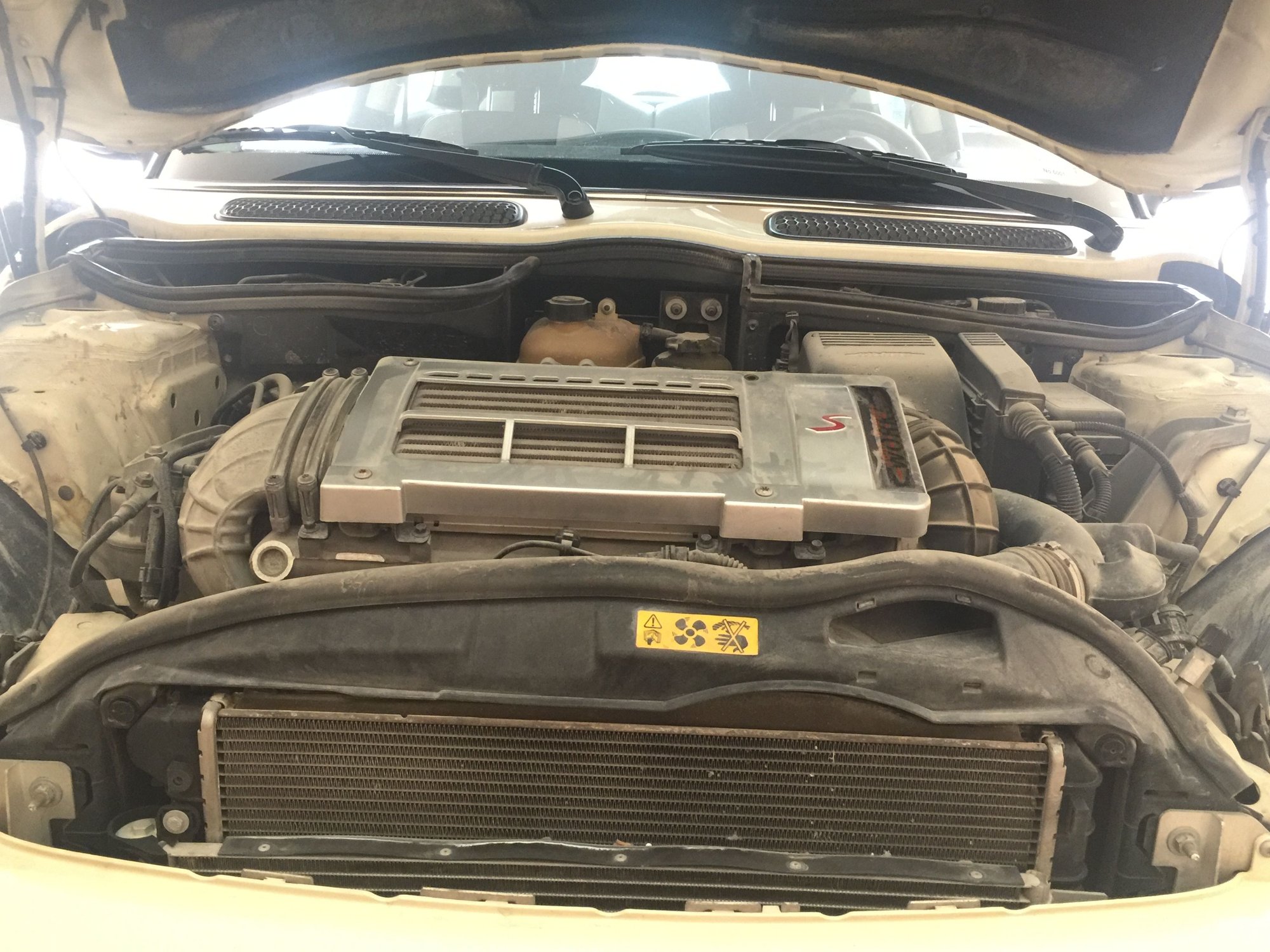

Posts: 153
Air filter removed - pretty filthy - notice the missing jubilee clip on intake pipe
Airbox removal
Needs a good clean
Front of the engine block was caked in oil and sand mixture - obscuring a connector for some kind of sensor on the front of block
Good brush down with Qatar's finest 95 octane gasoline
Also took the dipstick tube off to remove the remains of the broken dipstick - but nothing found inside
Ok all clean - exposing the rusty block - can't win !!
Dipstick tube back in place - can anyone tell me what this connector plug is for ??

Ok next target for cleaning is the power steering pump which is also caked in a oil and sand mixture
Pipes going down from power steering filler reservoir look caked in oil and sand mixture too

The connector on the front of the block should be for the crank position sensor. The seals are known to leak so I would replace it since you have access to it now.

I just went through pretty much all the repair your working on so I'll give you my newbie info -
- The sensor in the front of the engine is your crankshaft position sensor. Definitely replace the o-ring seal on it. It is the source of the oily mess in the front of your block.
- Your power steering return and feed hoses are leaking. Replace them both. That is why your PS pump is all wet
