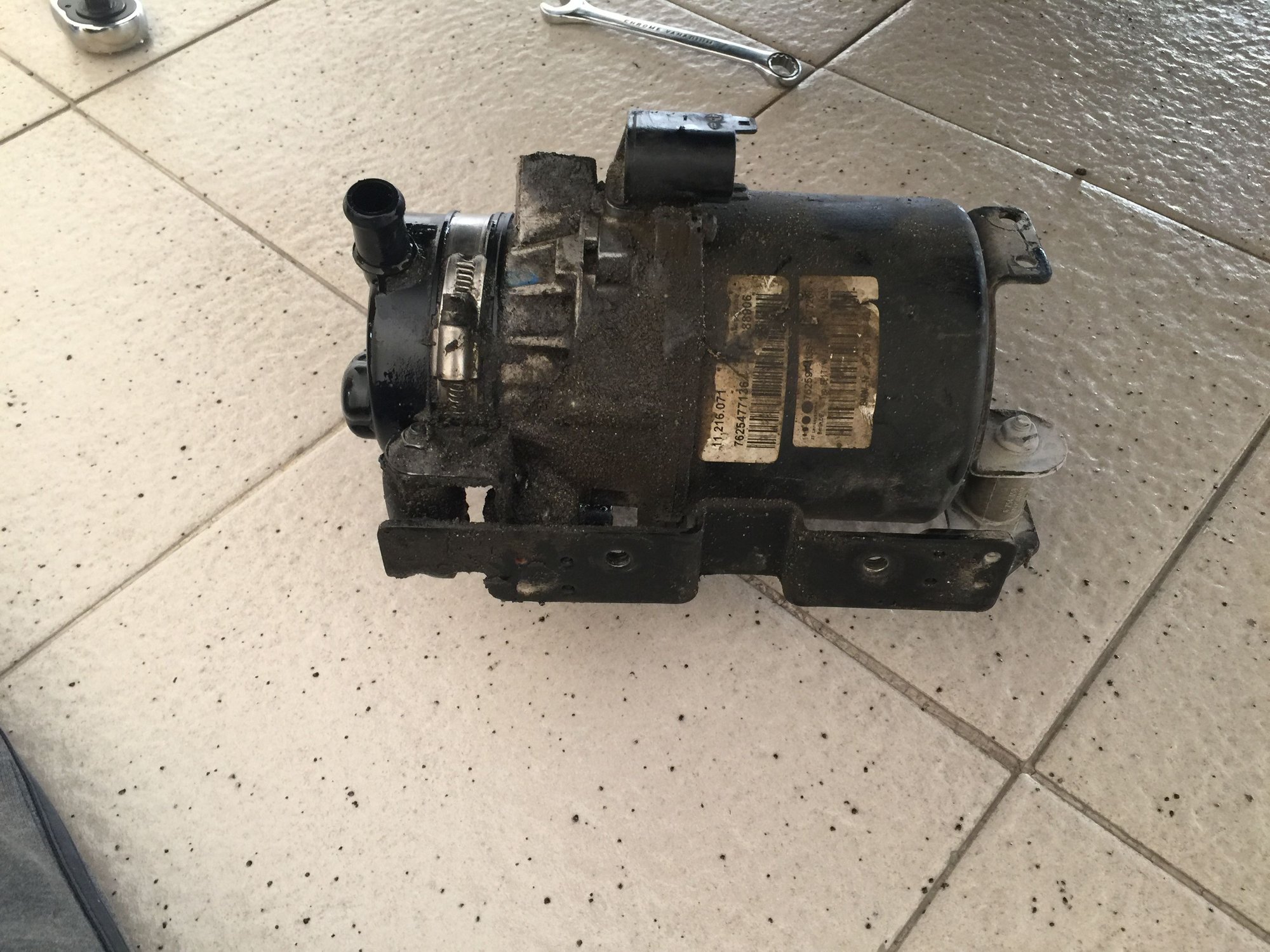

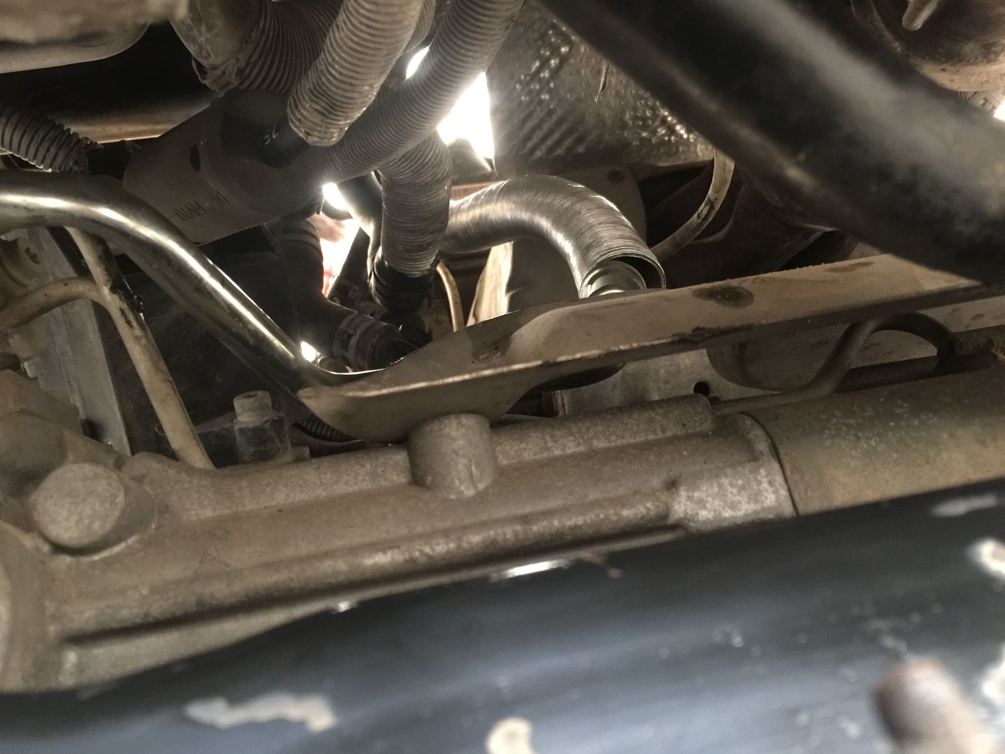

My PS hoses were leaking at the clamp below the reservoir, I assume the rubber is breaking down. I bought Rein Automotive brand hoses from Pelican Parts, about $80 for the pair. Not particularly tough job, easier with the drivers tire off.

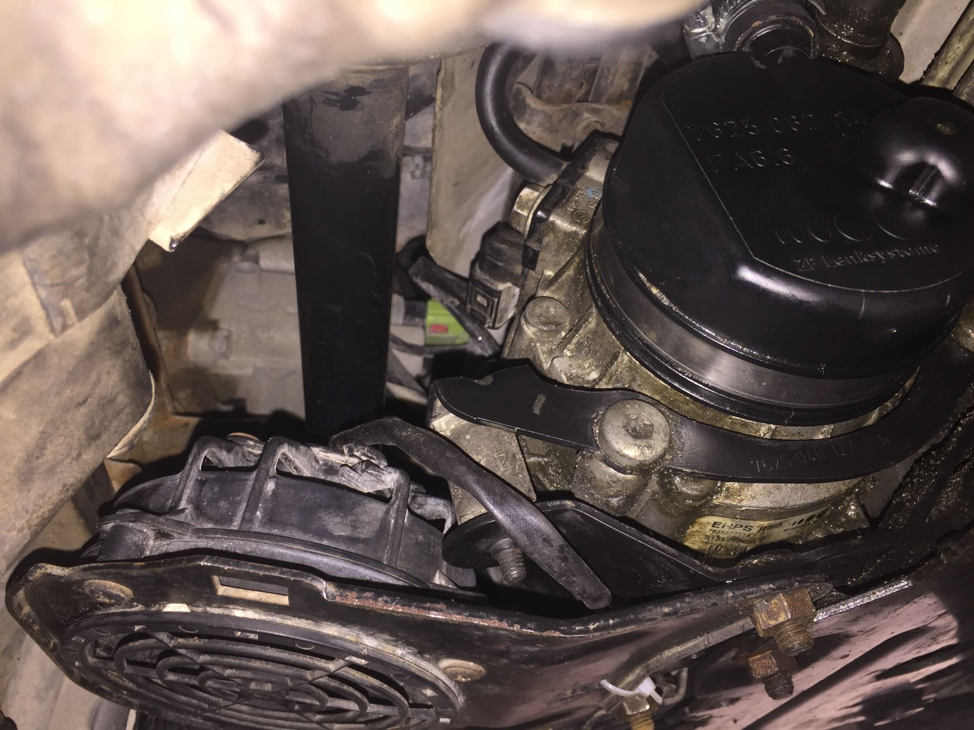

I believe all current PS fans incorporate the thermal relay. Bought mine from Pelican also (genuine BMW).

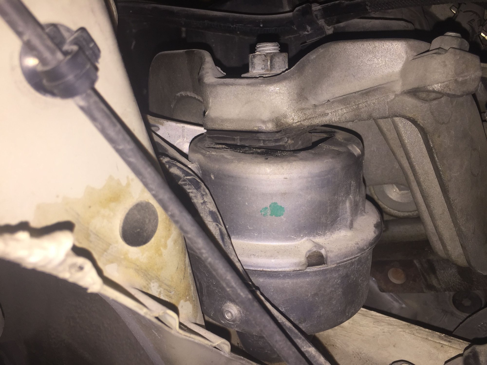

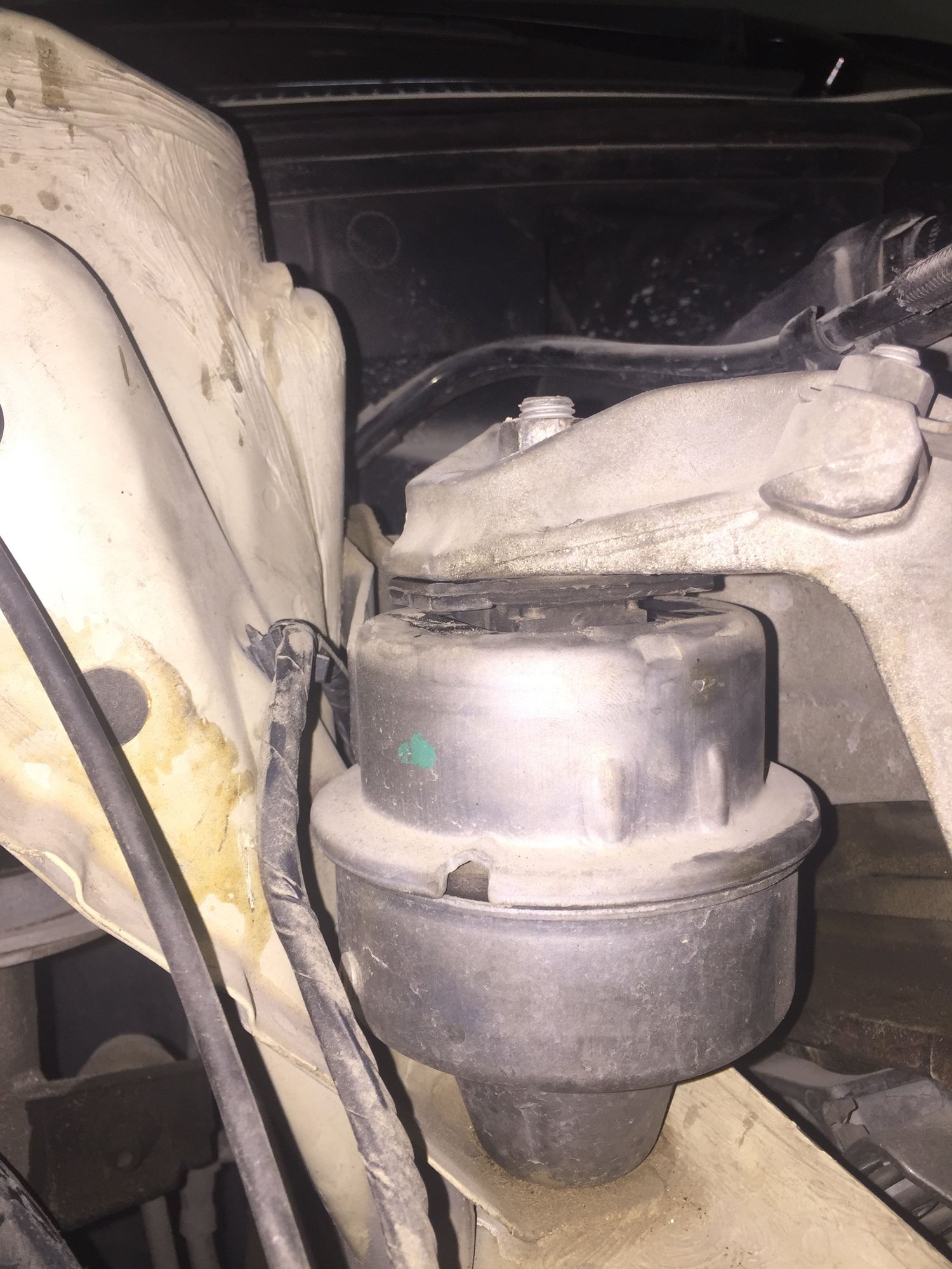

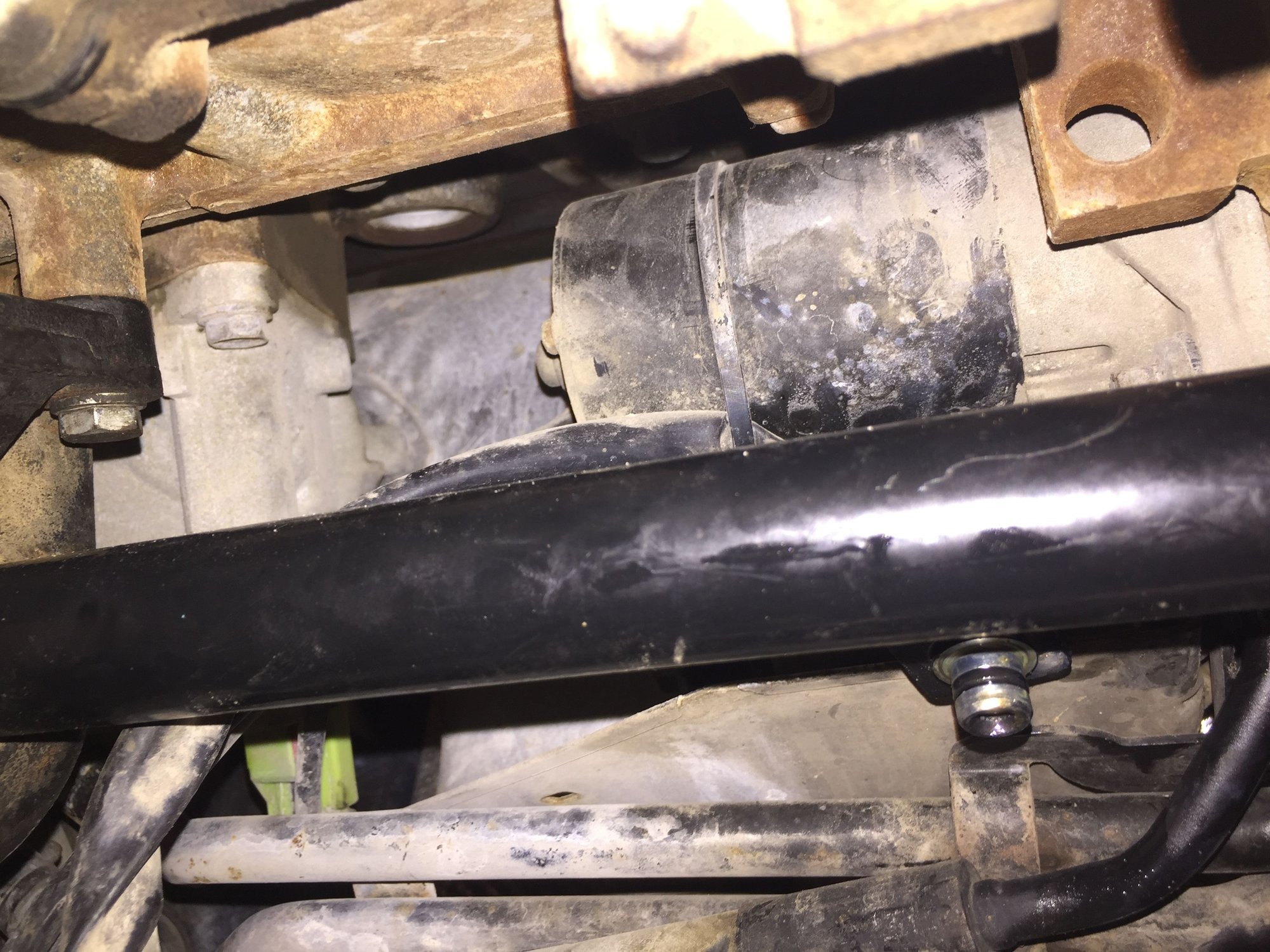

On the engine mount, the thing to look for is if there’s a gap between the rubber “pad” and the metal canister portion of the mount. If the rubber is resting on the top of the metal portion, the mount is dead and the fluid has likely leaked out long ago. Here’s a picture of the new mount I installed just a couple of months ago and the way it should look if it’s ok.....notice the gap between the sides of the rubber portion of the mount and the metal part.
OK so I checked my passenger side engine mount - no gap as you have shown - rubber was flush with metal - and as I was jacking the engine up, the inner rubber section of the mount was just separating away from the lower part - I think it's safe to say that it's donald ducked !! This mount has a really bad reputation it seems - did some reading up on any alternative mounts - seems there are after markets mounts (WMW / TSW) but the additional vibrations can be a bit harsh for everyone's liking - and they are not cheap either - so I will look for an OEM replacement item for now - about 34 quid for a new one (Lemforder brand) off flea-Bay - not that bad really.
That gap under the rubber section is due to me jacking the engine up !
Has anyone tried drilling and filling the dried out mount with some PU like Tiger Seal ? Bit of a ghetto fix I know, but I have used Tiger Seal instead of Polyurethane inserts, and its worked well - the only thing is you have to leave the PU to fully cure in the mount for long enough before re-installing - like a week or two !

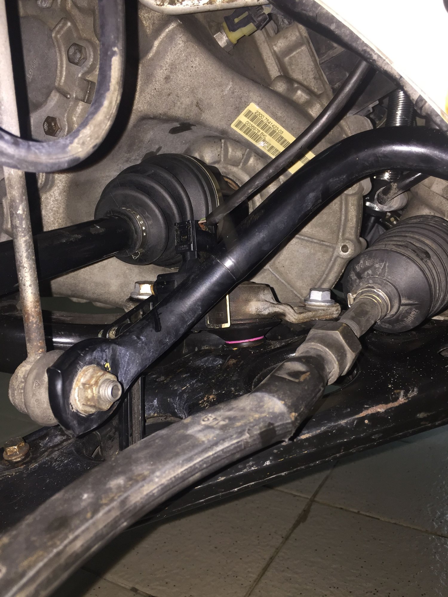

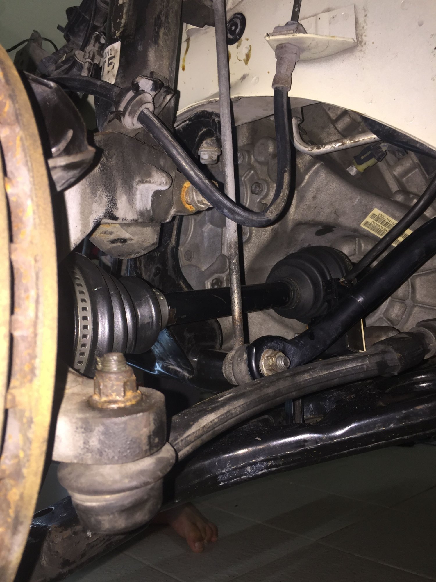

Ok here's progress from last night
First CV joint opened up - inner 'tripod' joint - shorter shaft on driver's side - all looks nice and intact
Nice looking roller bearings and you will need snap ring aka 'C' clip pliers to get this CV joint off the shaft - after making sure you mark it exactly with the driveshaft so it goes back on in the same position
Then to the outer 'Rzeppa' CV joint - the outer boot was actually pretty solid compared to the inner side - no sign of it failing anytime soon - but it's a job to pop the CV joint off the shaft - need to be brave !
Its a messy job - plenty old rags needed
Right time to replace the outer joint - just as hard if not harder than removal - tip: need to make sure the retaining clip on the driveshaft is not loose otherwise won't get it back on
But first some nice new molybdenum disulfide grease - just enough needed not too much
And the same for the inner CV - which is easy off easy back on
Something strangely satisfying about squeezing that grease in - sad I know !
OK both sides ready for the clips
Need some nail puller type pliers that are big enough to fit over the squeeze point on the clips - locking pliers / mole grips can get you started if you need them
One side done
And well into the darkness, the passenger side shaft is also done

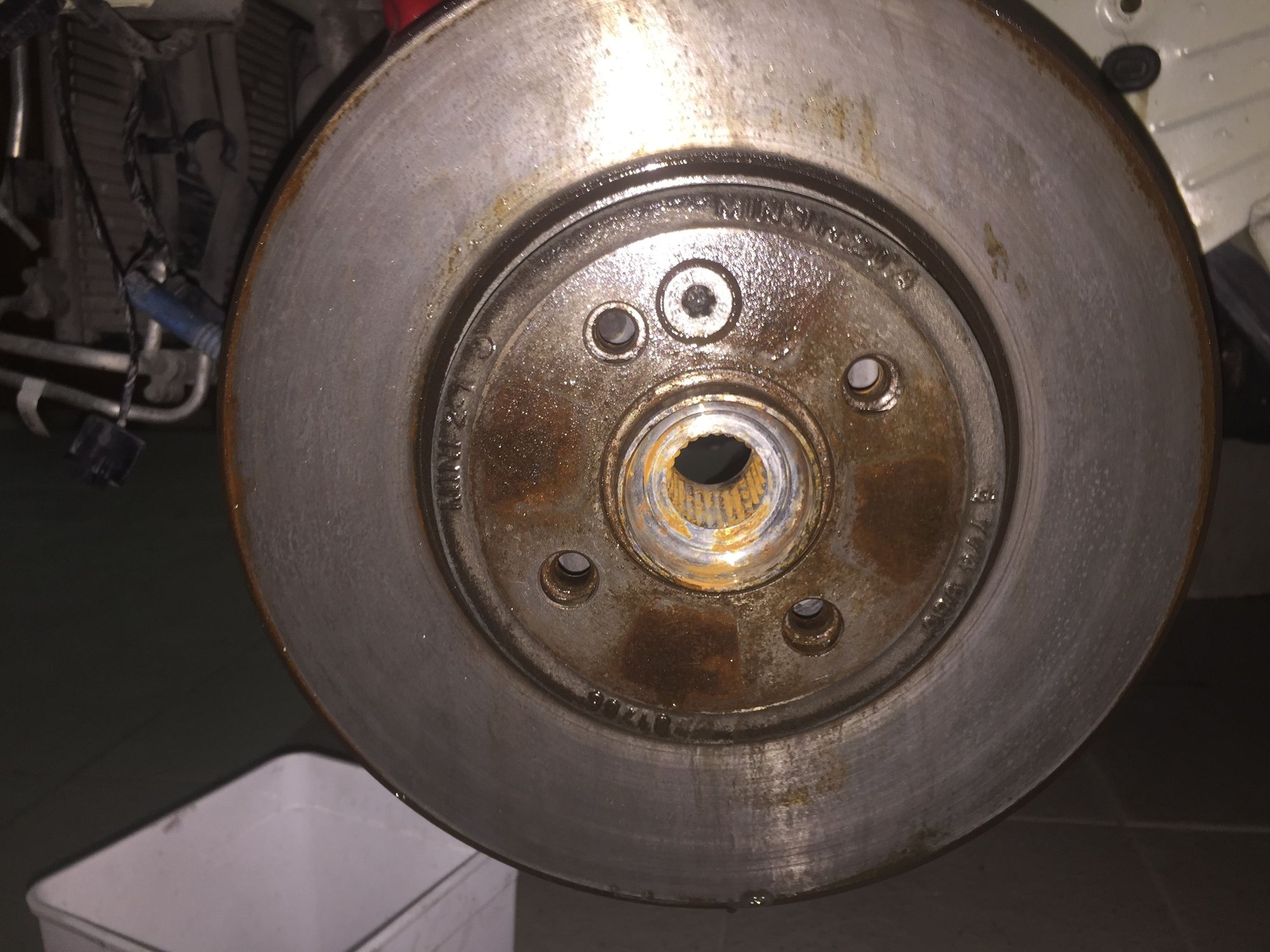

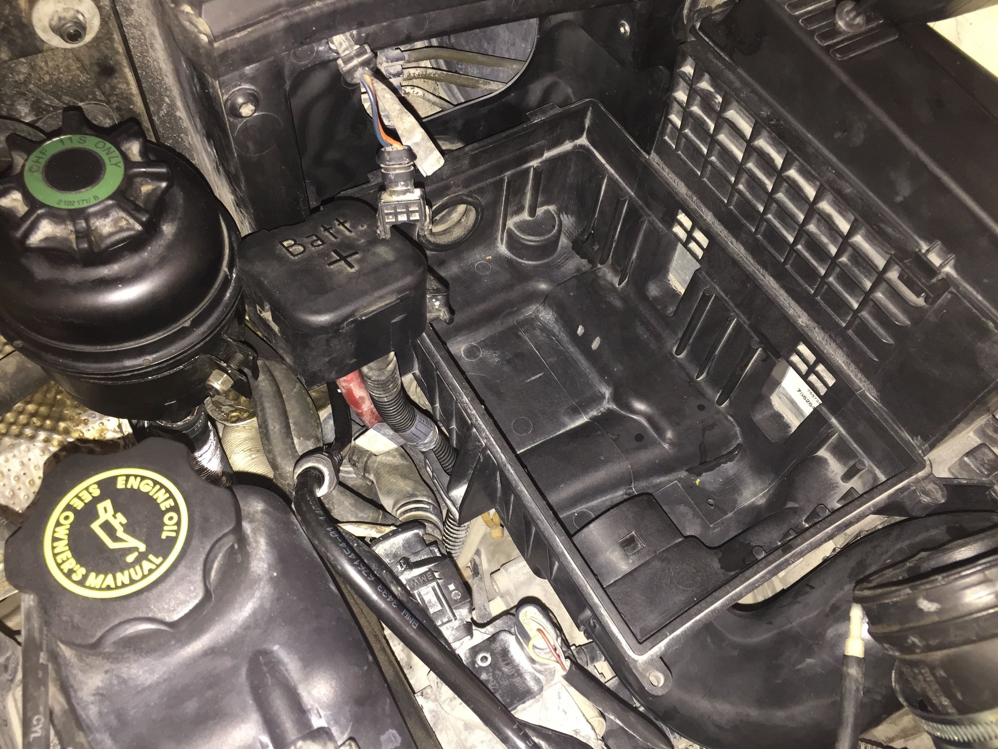

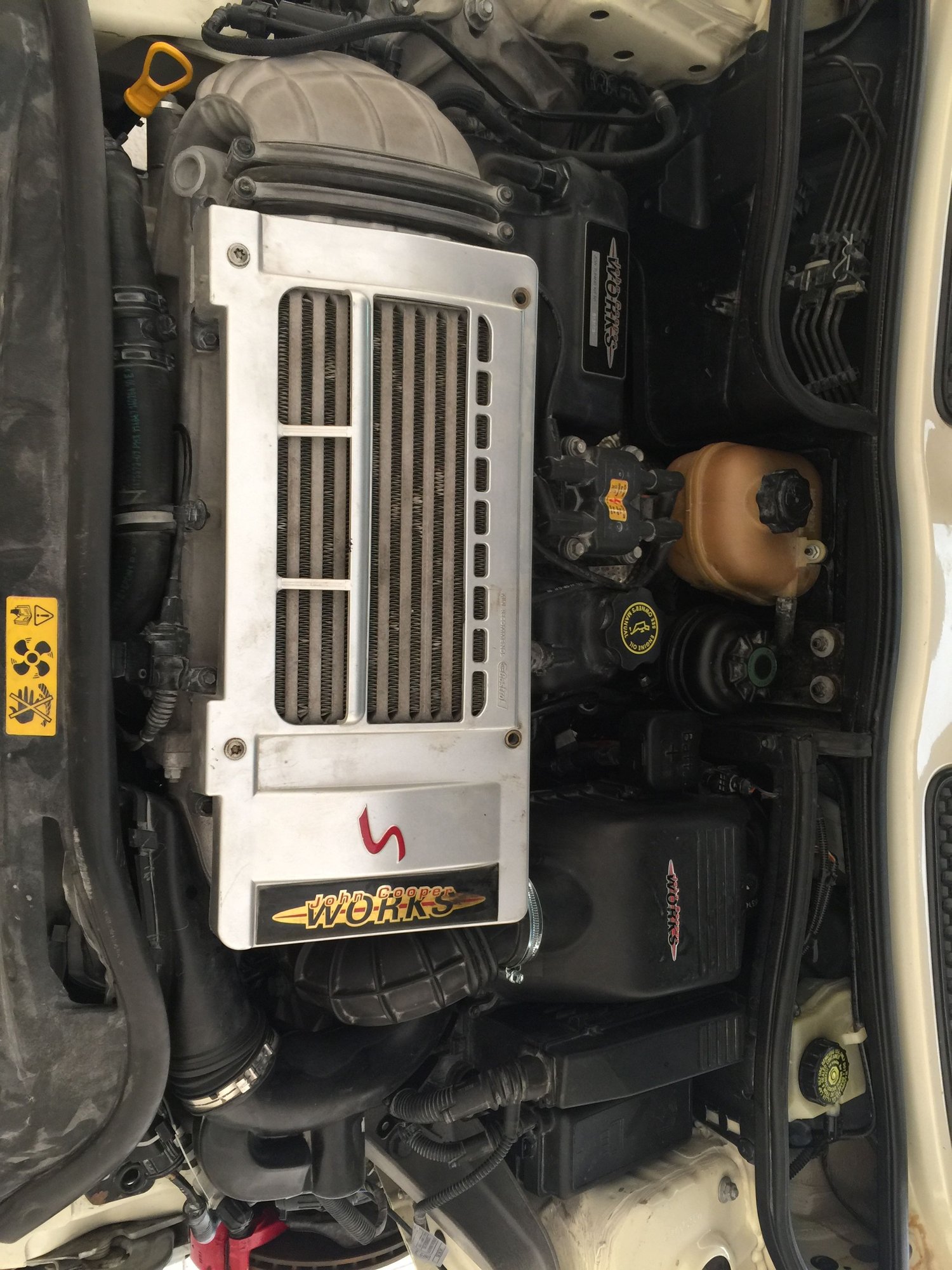

Managed to start de-greasing and cleaning the engine bay, brakes and removed arch liners for a good old clean behind - very well preserved and rust free so far - not used to this, coming from the UK.
Ok here's the list of things to be done, so I don't forget anything and to make sure I do things in the best order (any tips on order of things welcome!):

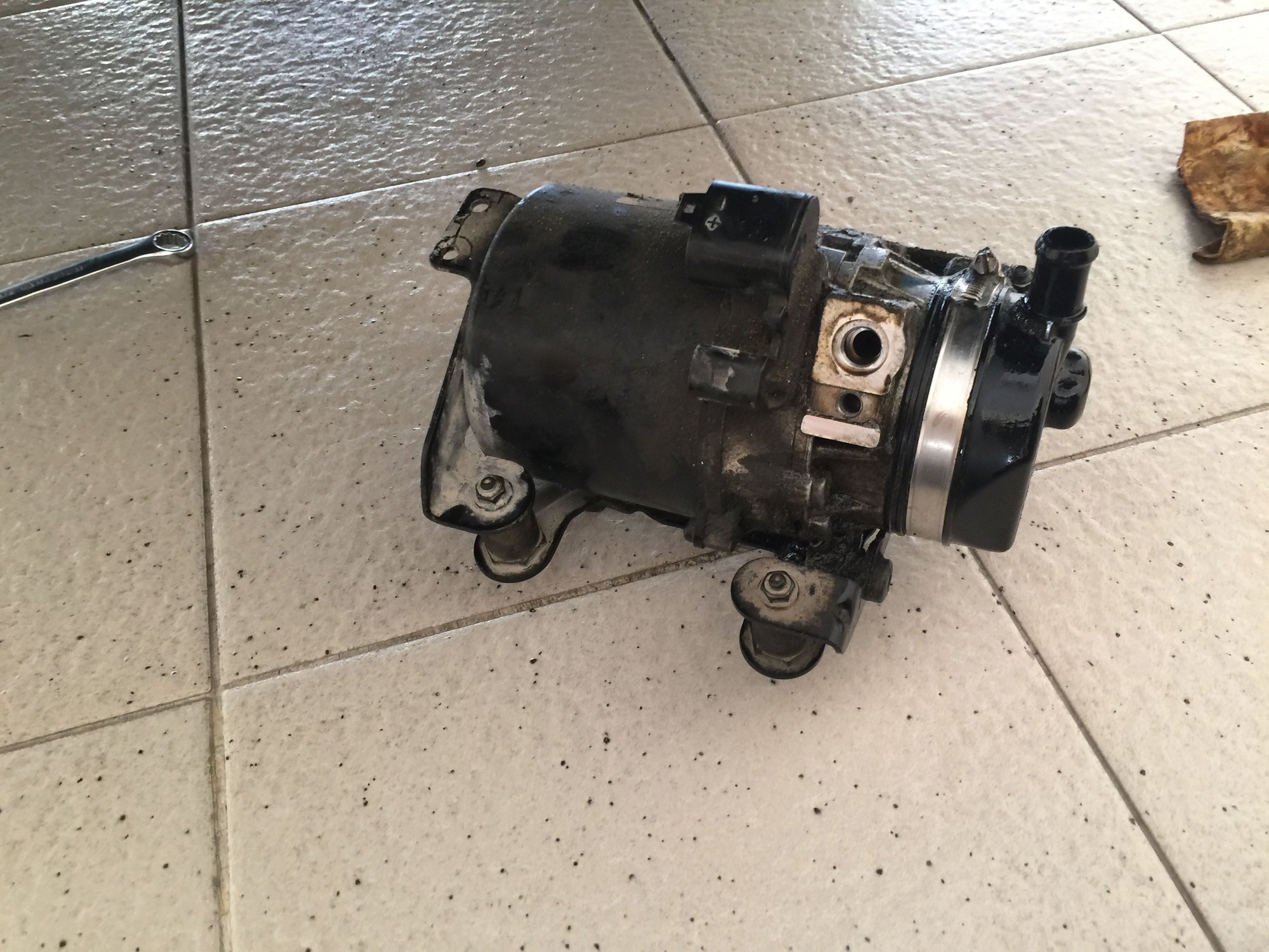

1. Drain remaining power steering fluid out of system
2. Replace both power steering reservoir hoses

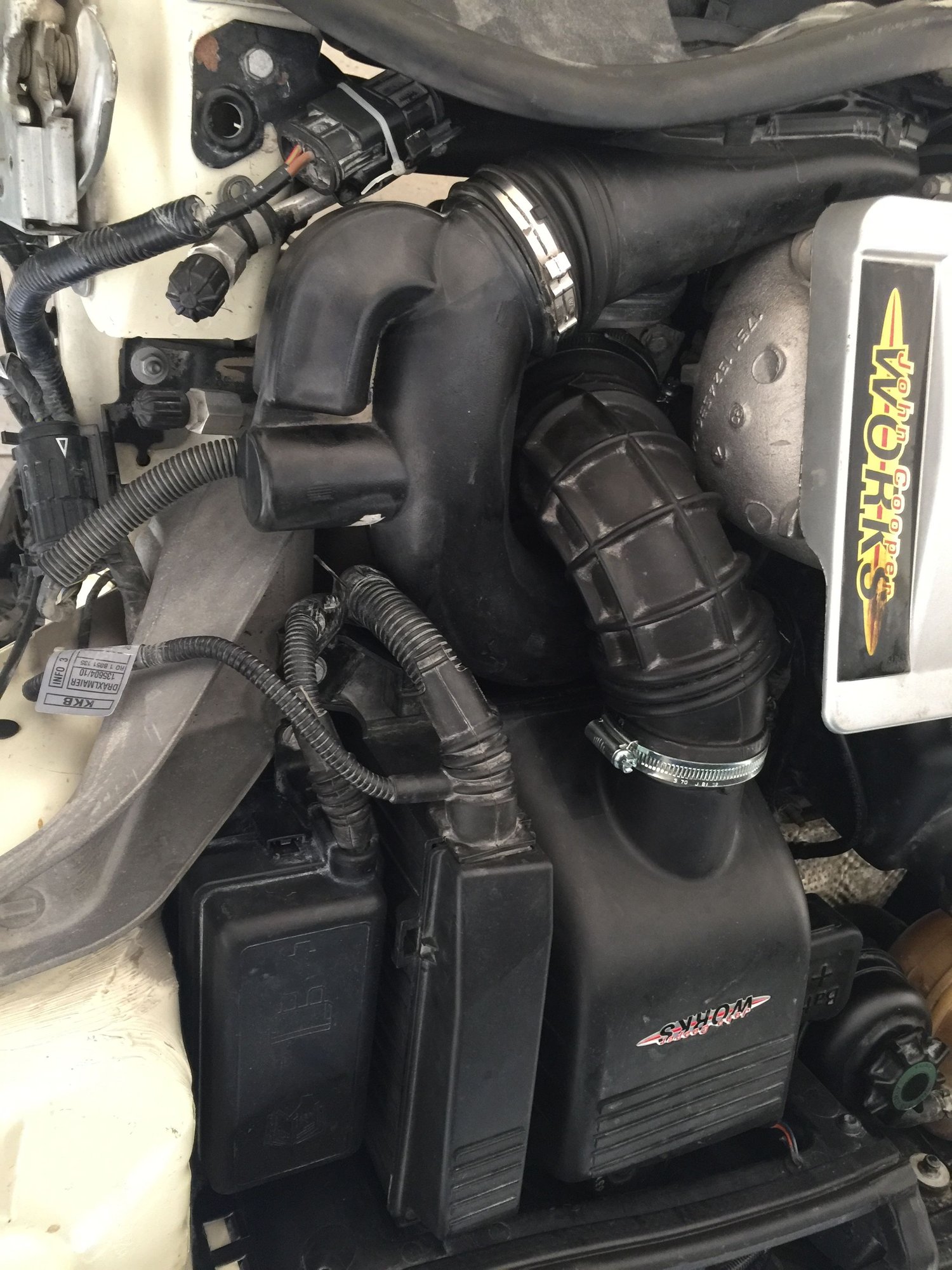

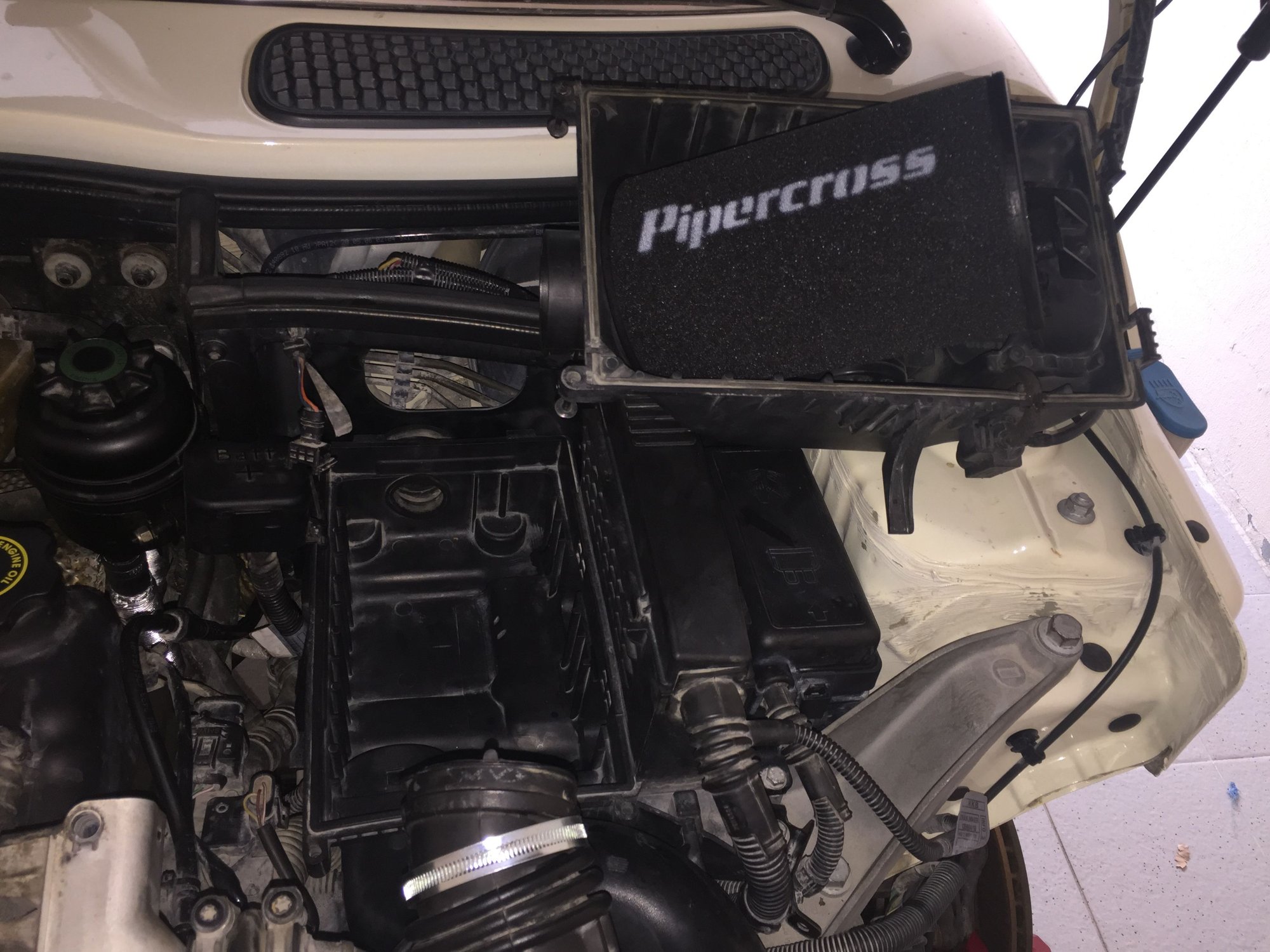

Only things left for today are clean and replace airbox and fit new air filter, new spark plugs, replace and refill radiator, engine oil, gearbox oil and power steering fluid and AC filter. We should be done later on today, God willing.

1. PS Fan: This has been re-engineered over the years by BMW, and if yours is original, you are just asking for catastrophe when it fails. The PS pump is expensive to replace. Get the redesigned fan in there ASAP.

I will order the more up to date PS cooling fan for sure and I will also check on the low speed fan and tail lights issues. I have checked the shock towers and they look ok from the top and underneath, so wondering if they might have been sorted already.

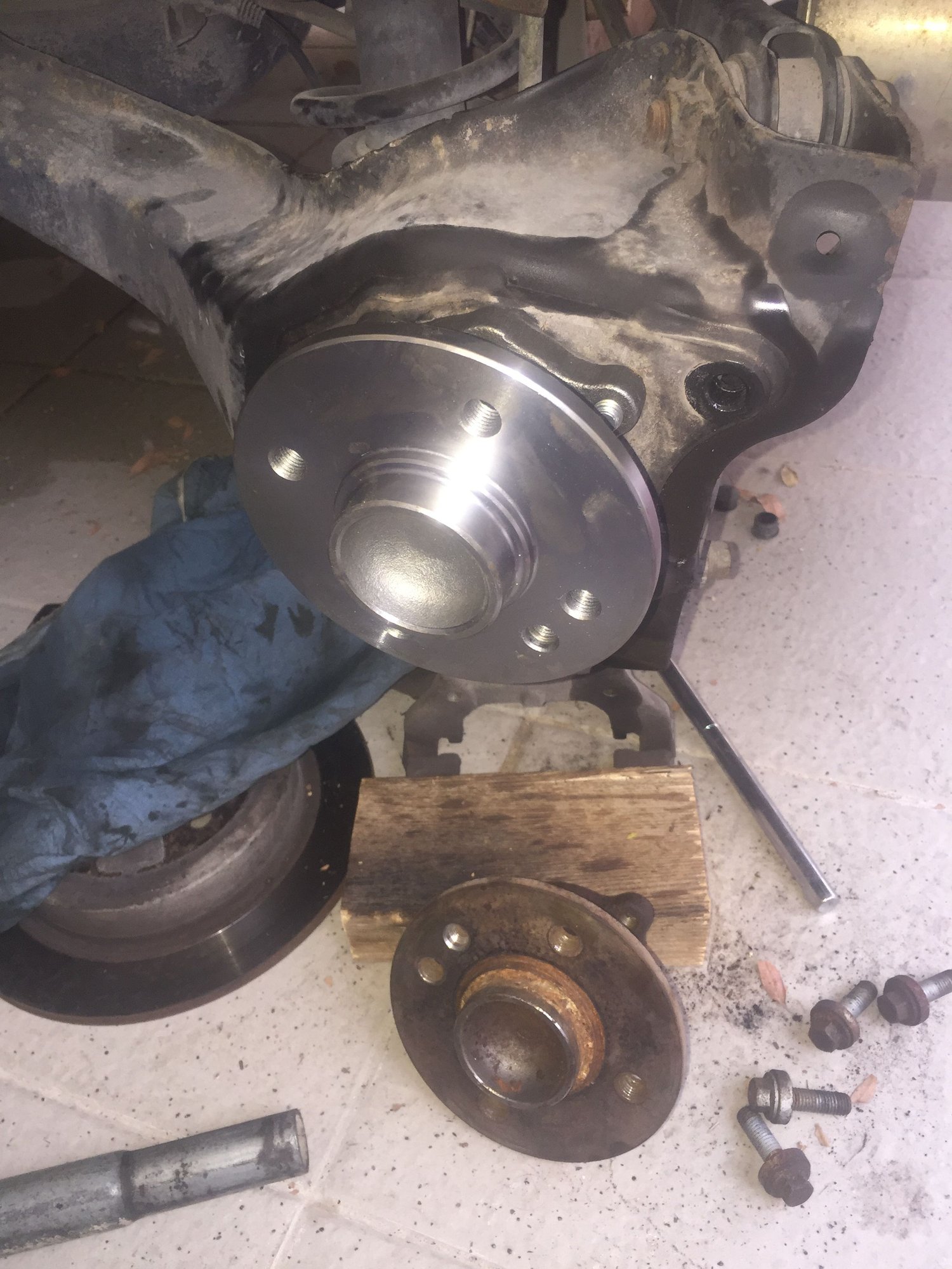

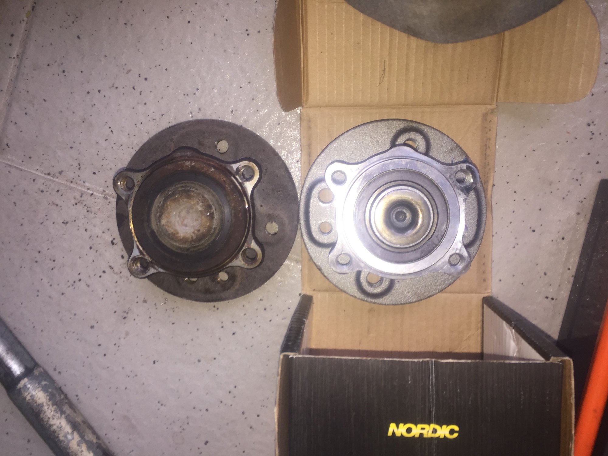

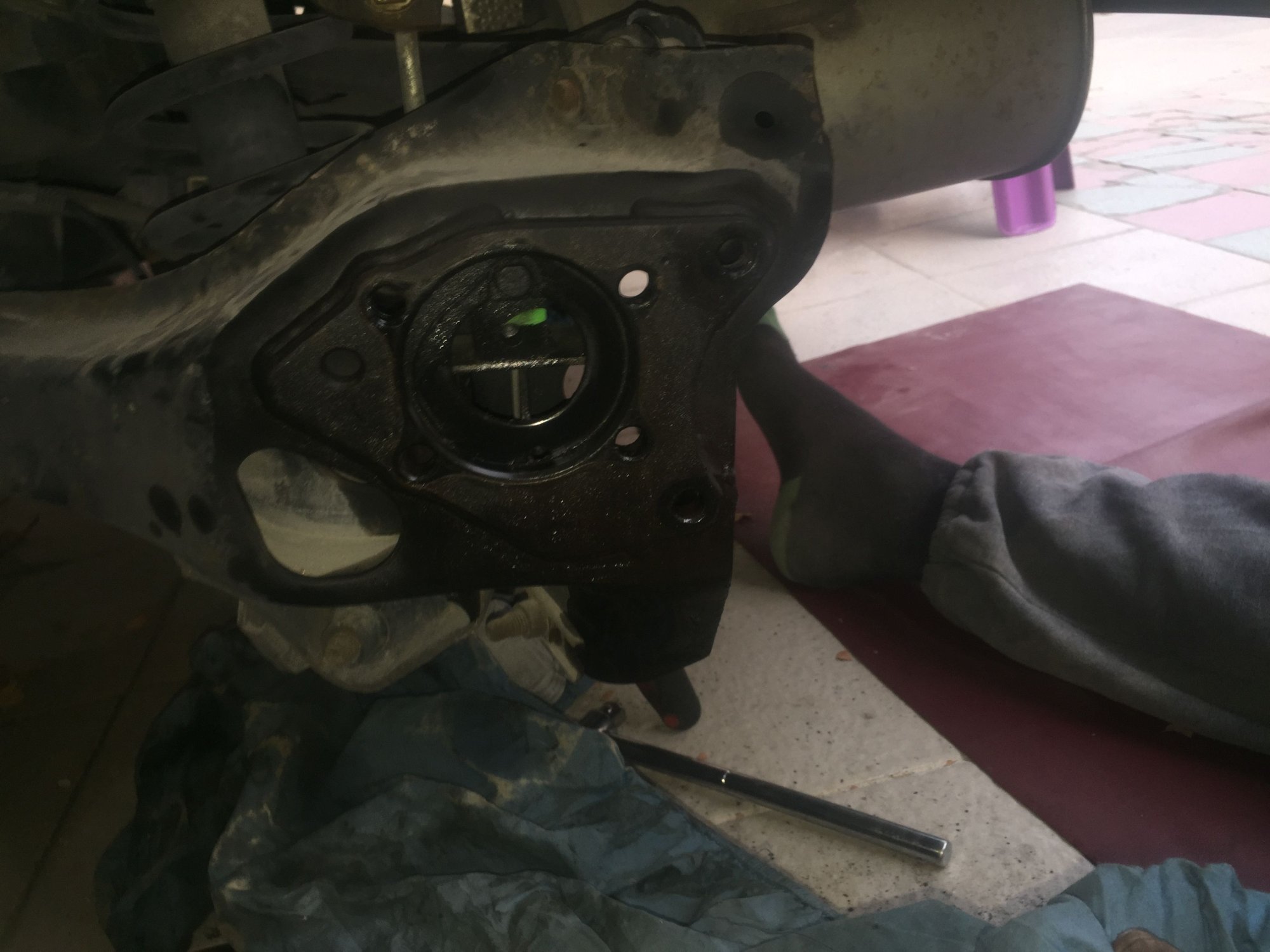

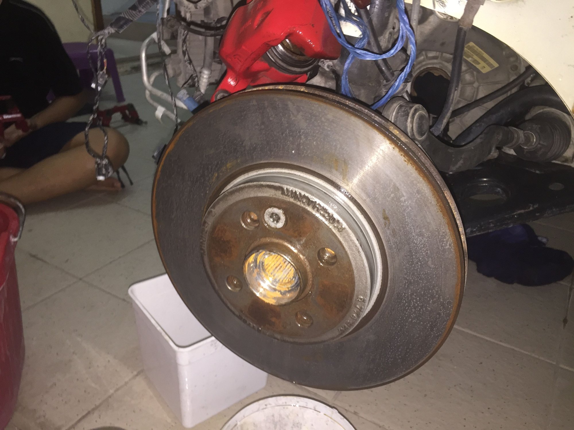

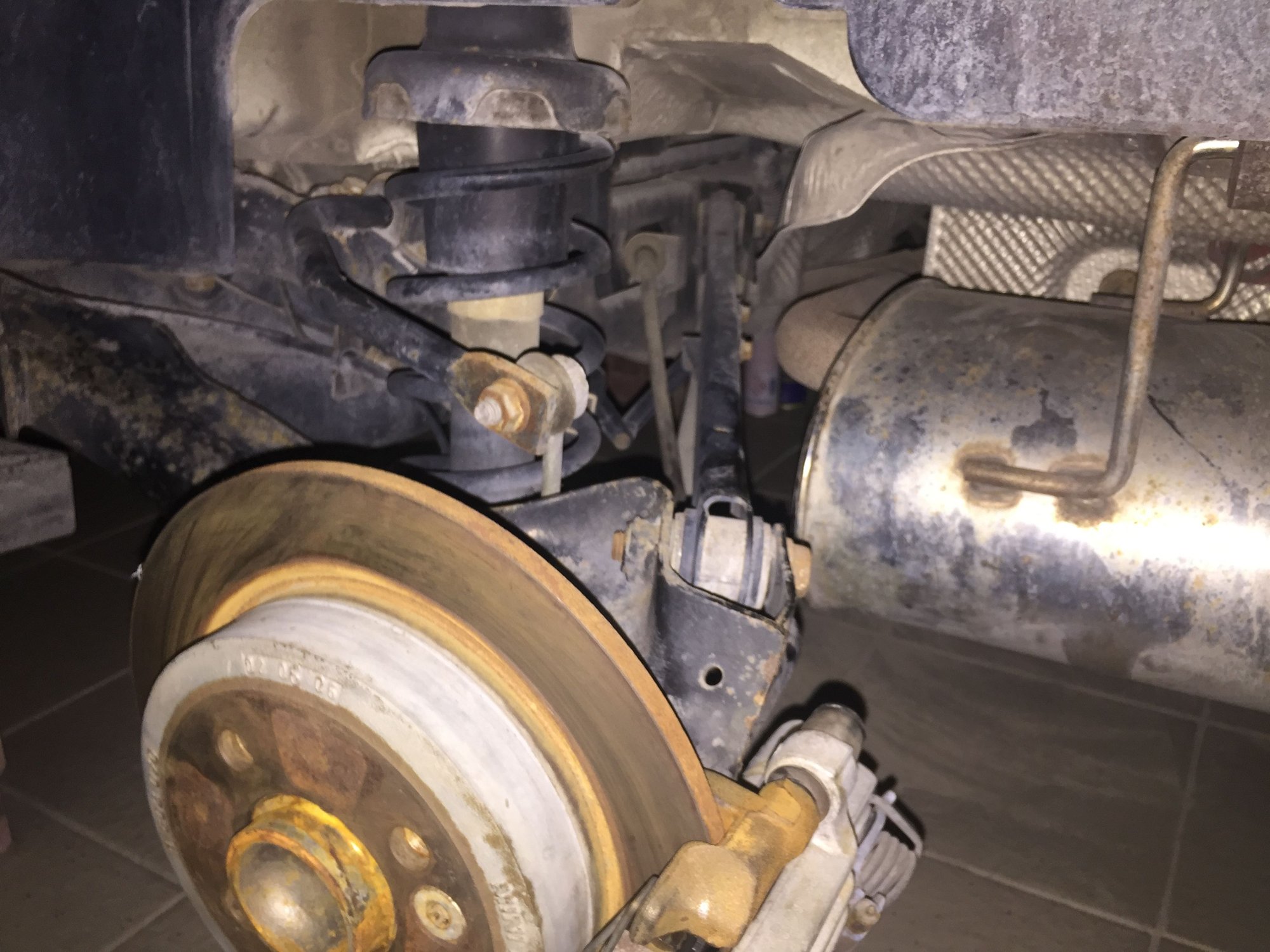

Bolts came out easy after some WD40
Rear Bearing out - easy 4 bolts and off
Shiny new bearing and hub in one - good idea and saves time and pain on pressing new bearings into hub (as with Honda)

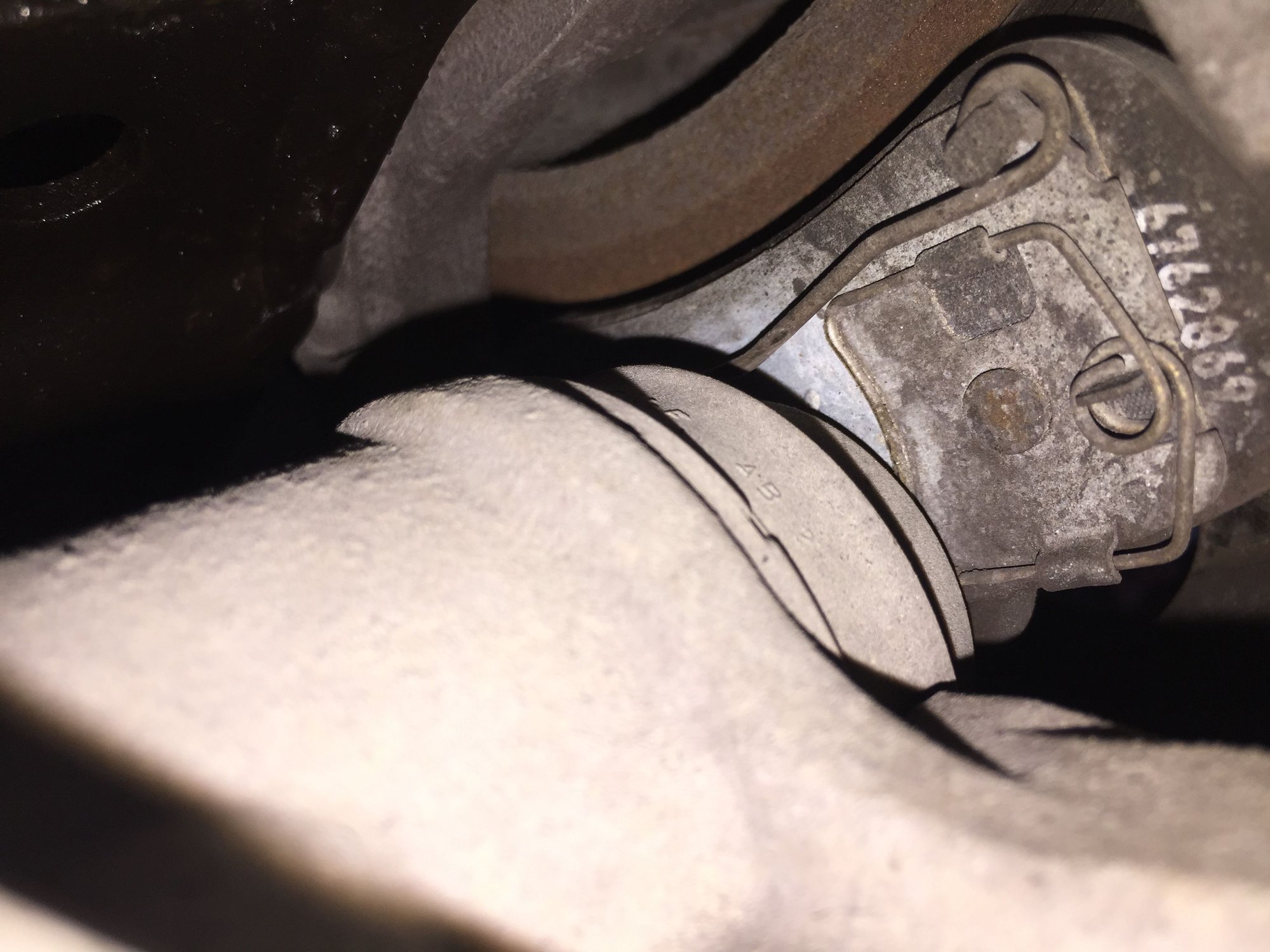

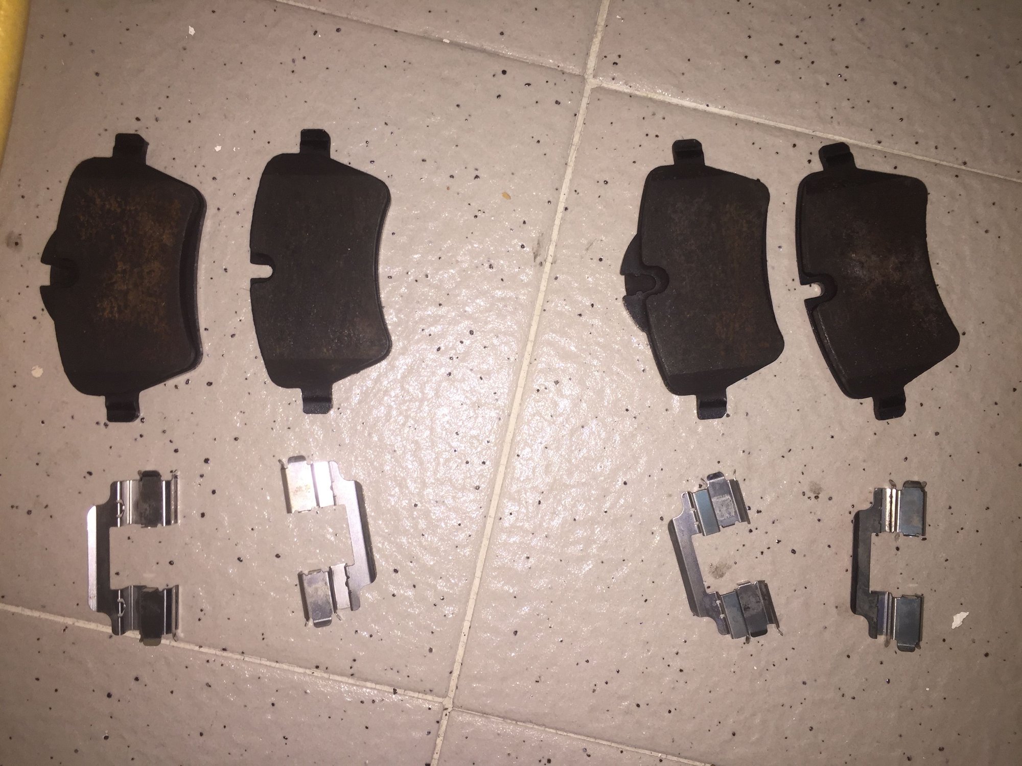

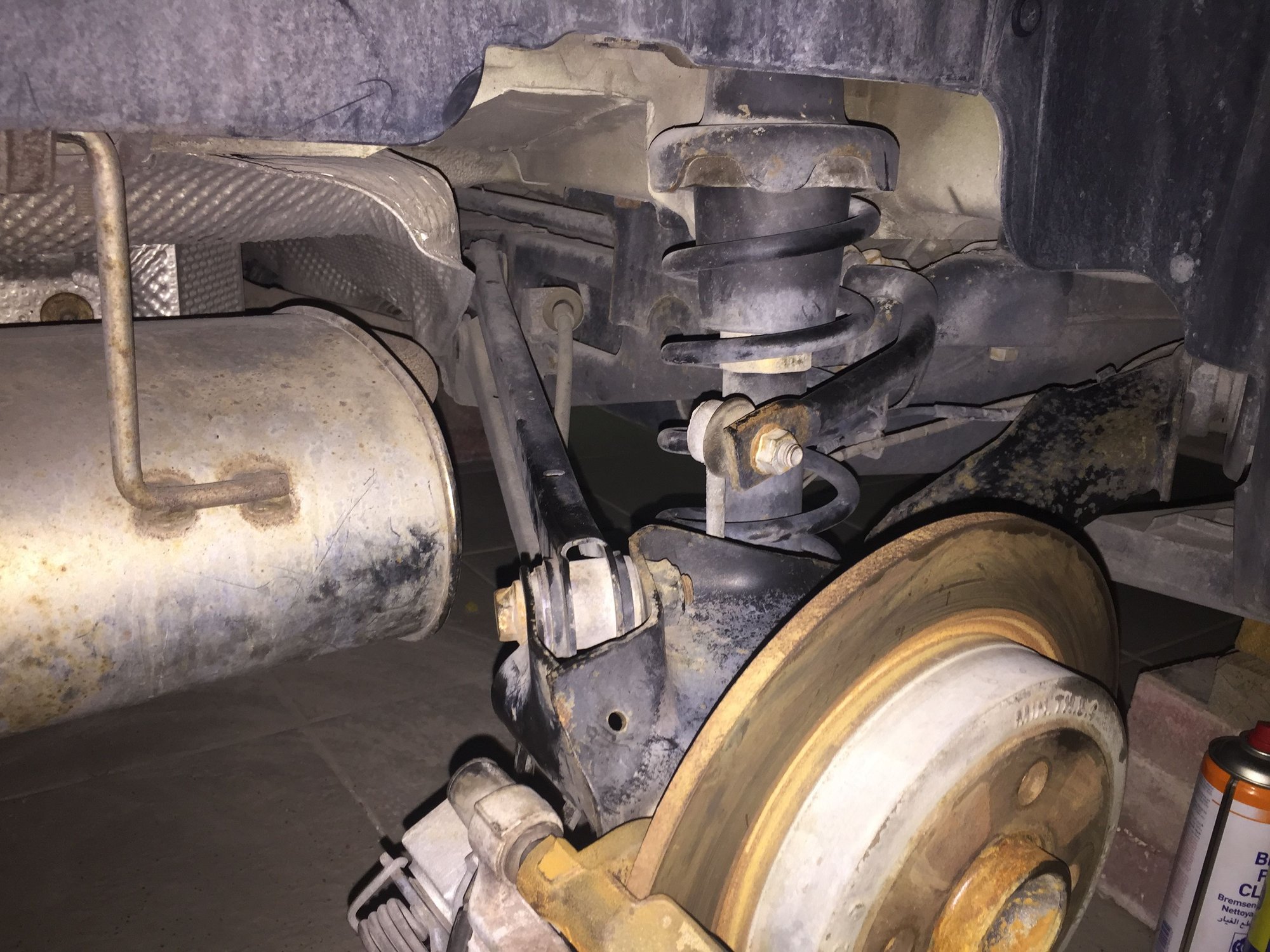

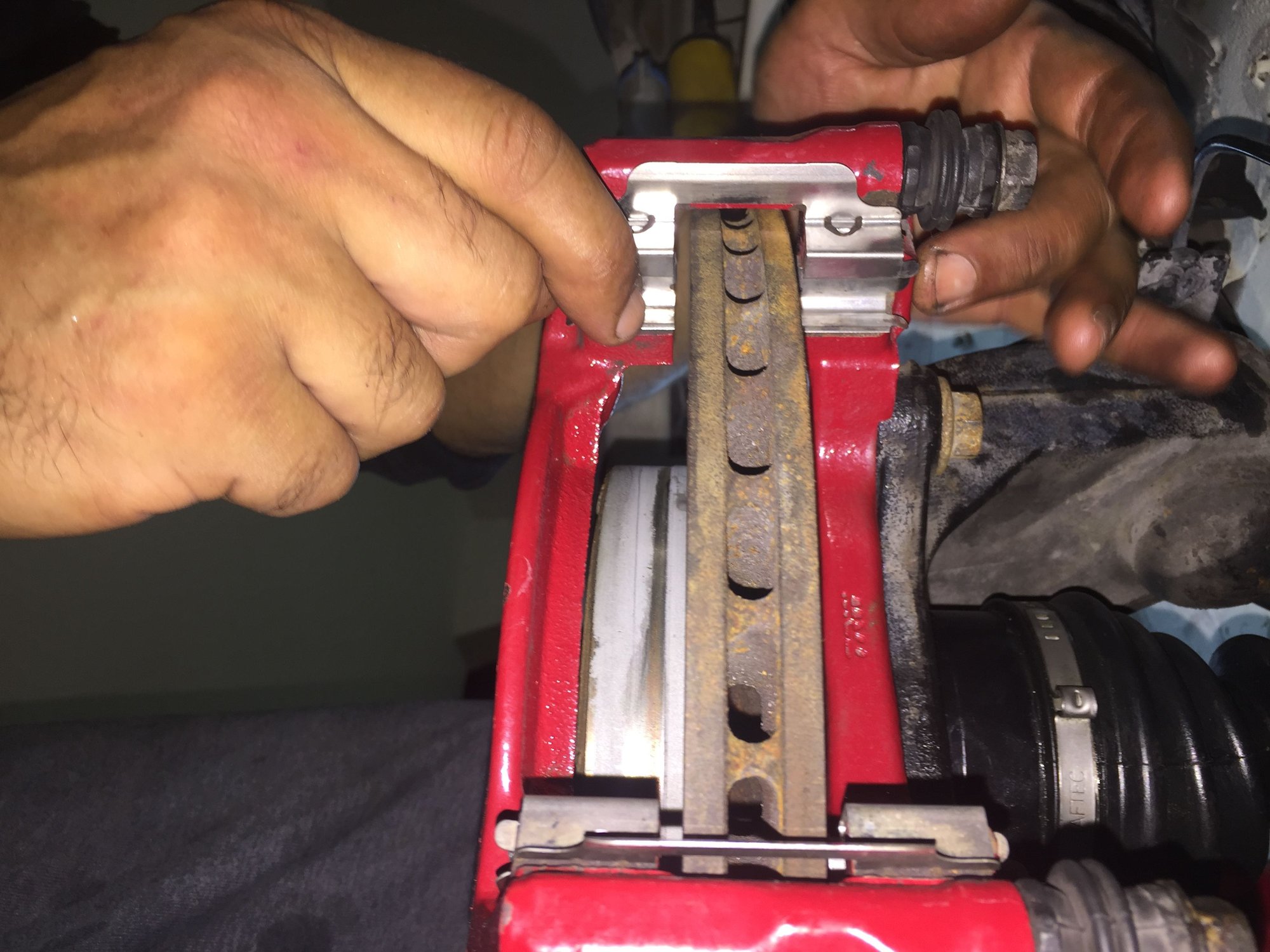

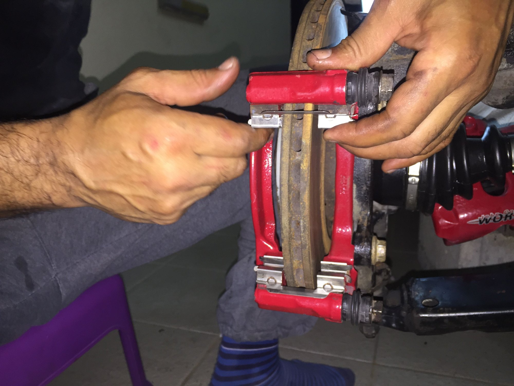

Any idea what those strange looking clips on the back of one of the rear pads on each side are for ? There were some missing on one side, so I just took them all out - all or nothing approach.
Rear inside view

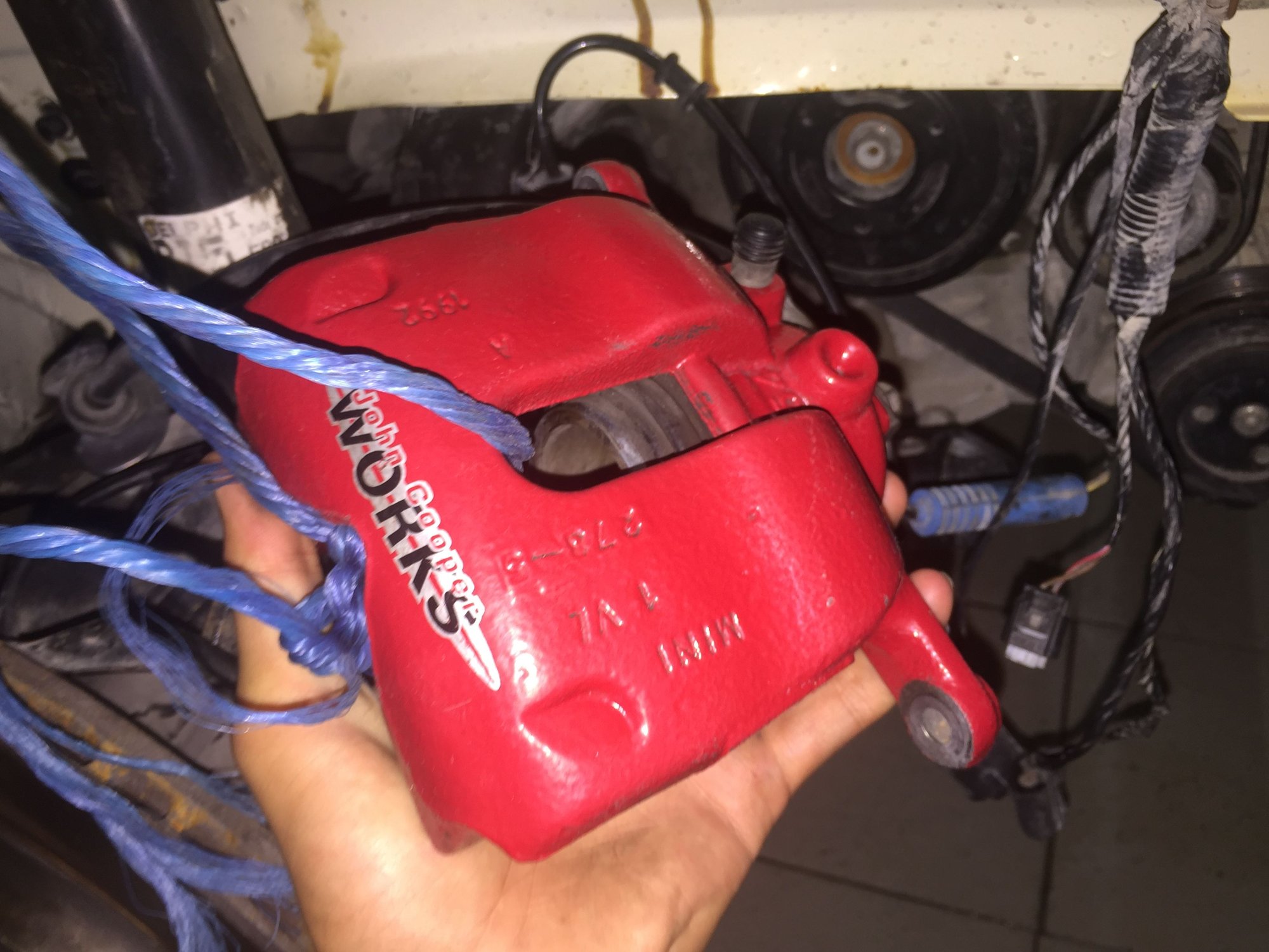

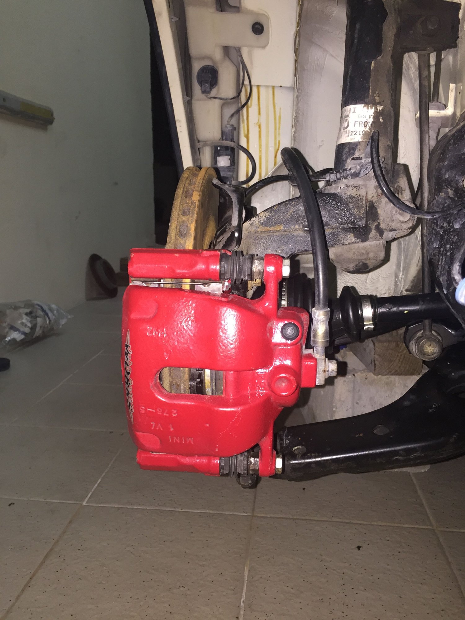

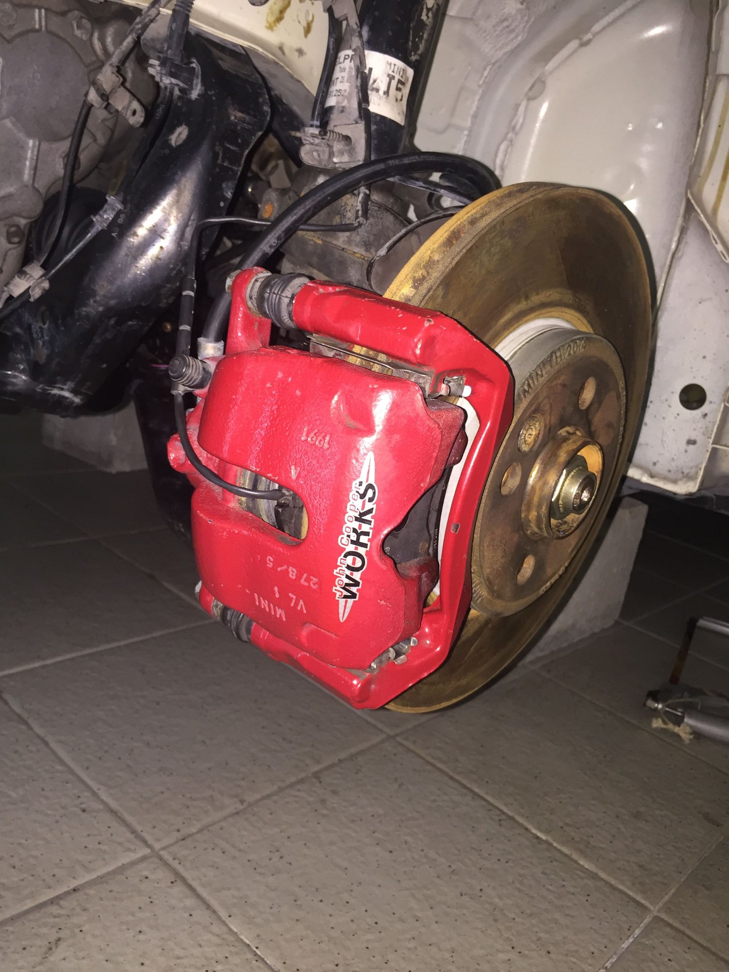

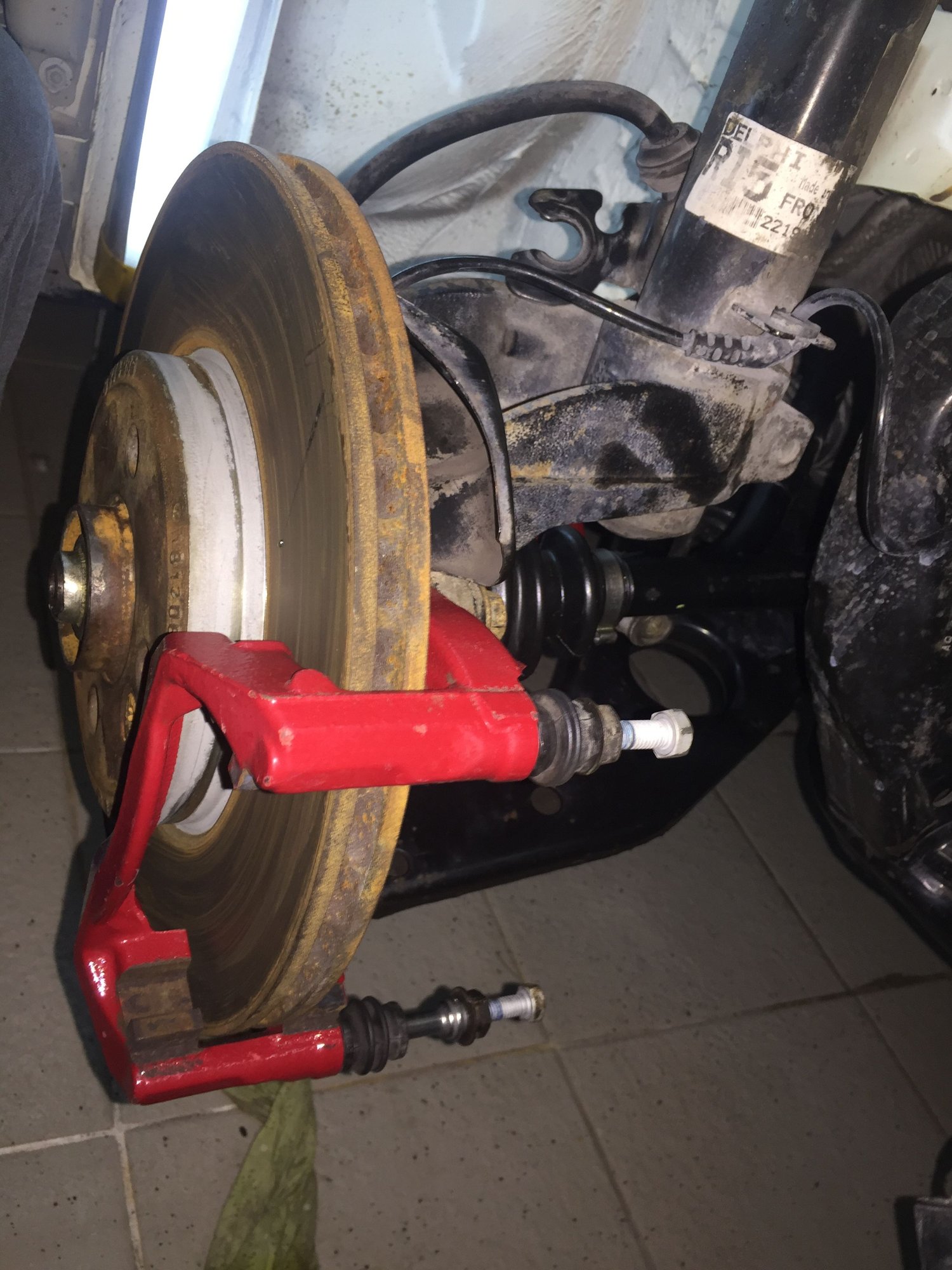

Cleaned up Calipers
Cleaned up brake disc
Cleaned up pads

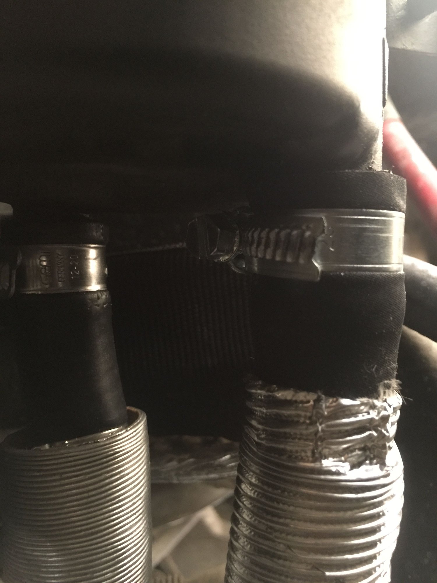

Chose to use jubilee clips in the end - don't like the other type as found on CV boots

RE post #40: I think that they are anti rattle springs/clips, and you need them on the pad.
Thanks - had a feeling they might be something like this - I'll try them as they are - shouldn't do any harm

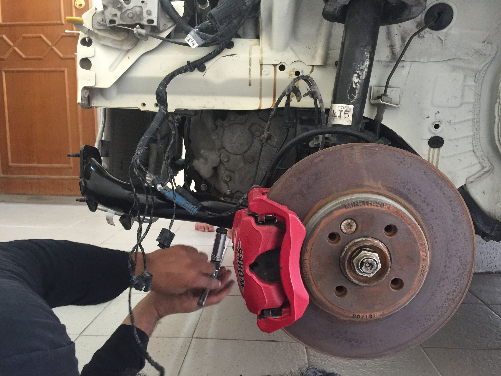

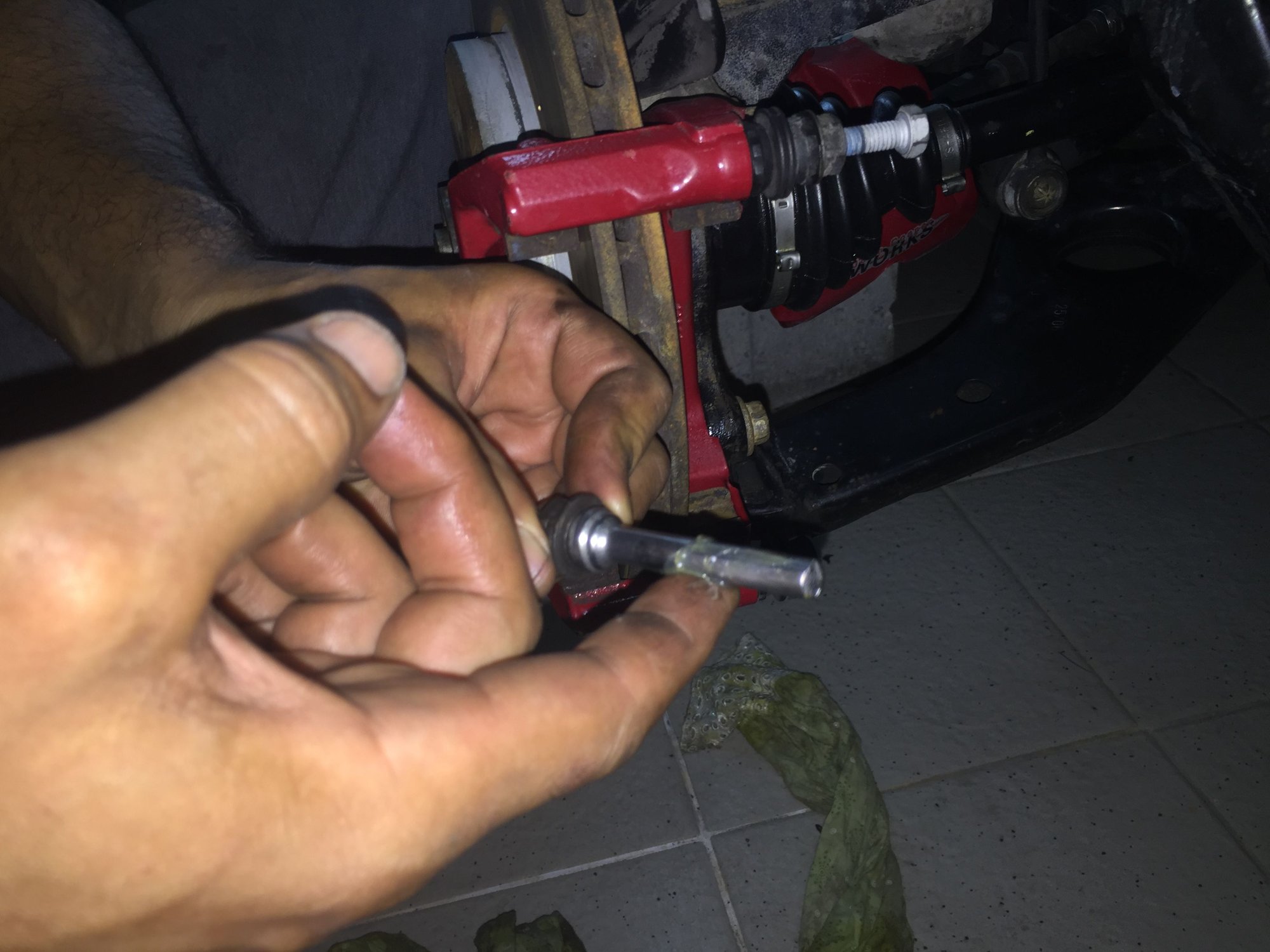

Clean and grease slider pins
Rear brakes cleaned and back together

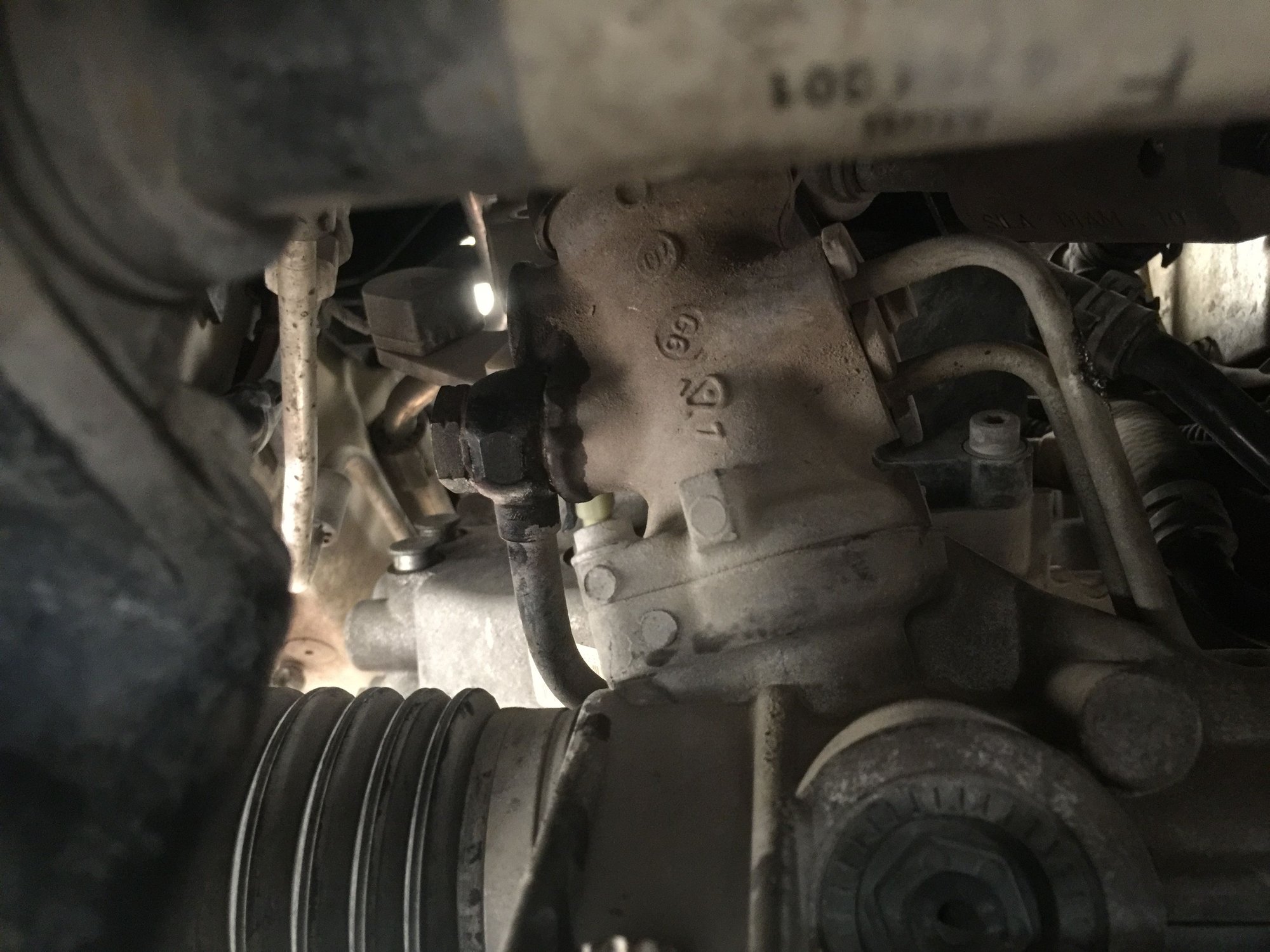

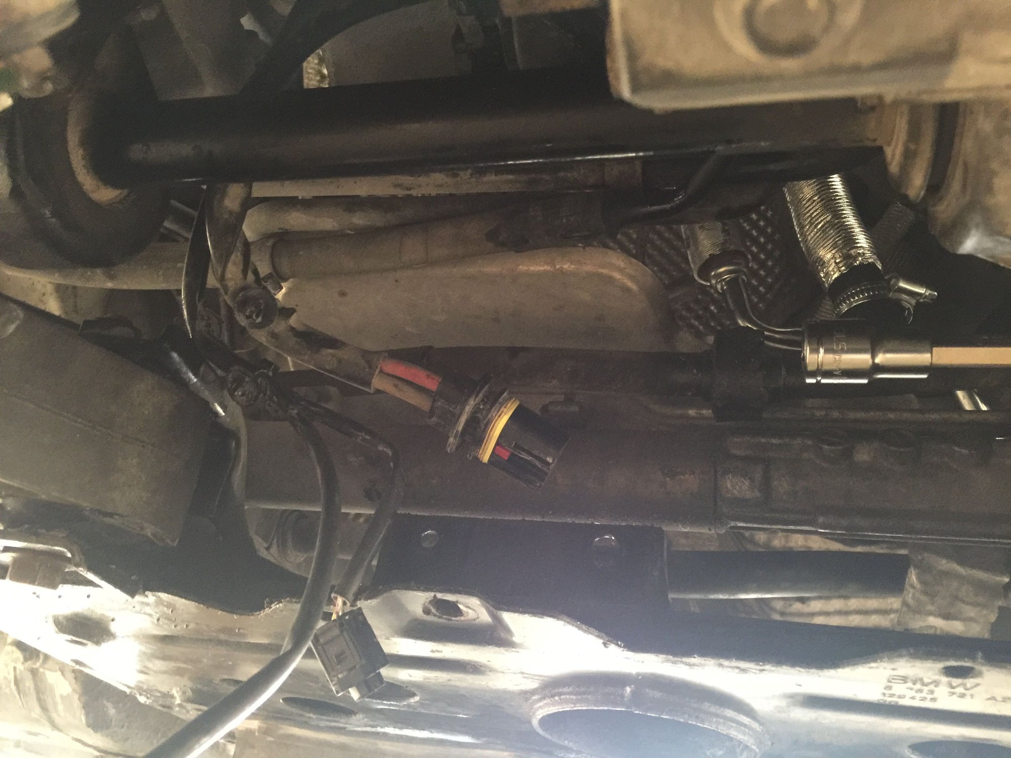

It's the Getrag manual gearbox/ transmission- and I think I will have to remove the PS pump by the looks of it- I can then get a decent sized ratchet with alan key in a socket into the refill plug and hopefully turn it. I don't know why people over tighten things - especially refill plugs- there's really no need !!
i have the workshop manual so will take another look at the fluid re-fill instructions- thanks

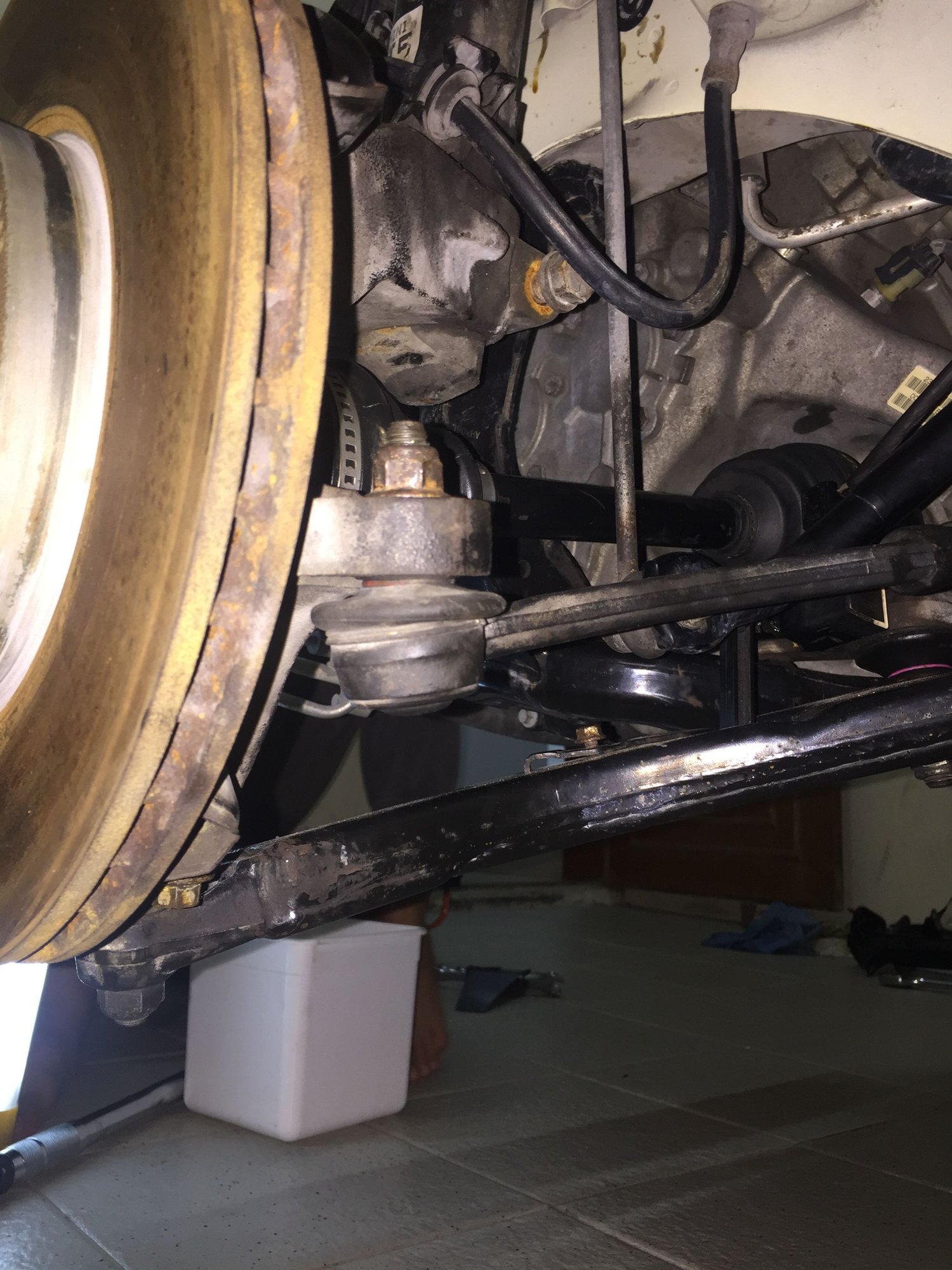

Ok so after much perspiration and a load of expletives, the Power Steering Pump is out and the gearbox refill plug is open. It took a hell of a lot to shift it and makes me wonder if its ever been opened.
On the positive side, I get to totally drain and clean up a very dirty pump and related pipes and subframe sections. So I can get on after work and put the pump back in and fill up the fluids and get it started. God willing ofcourse.
