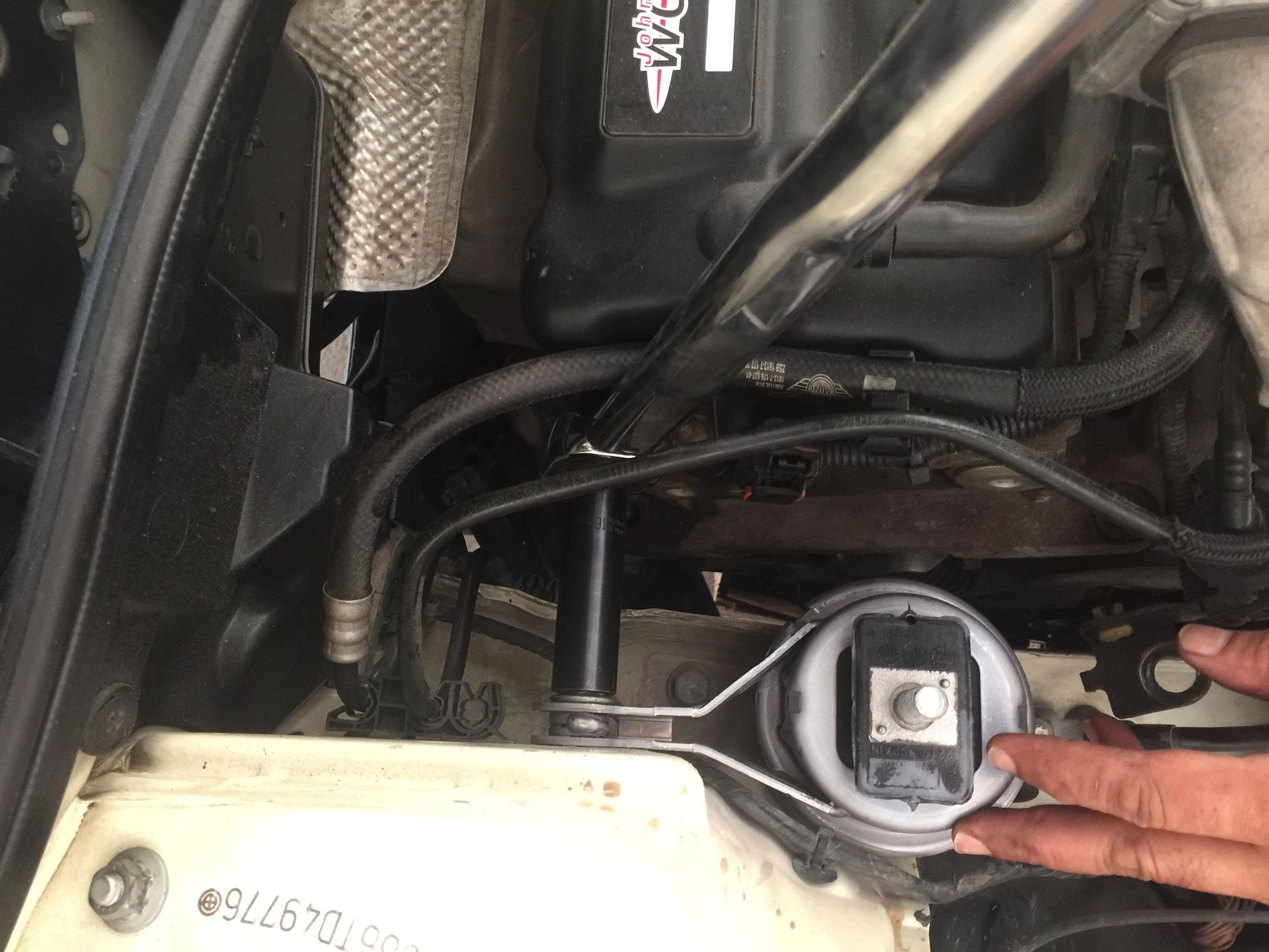

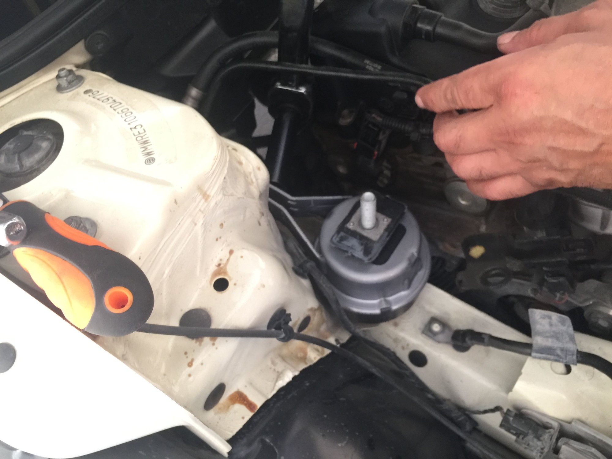

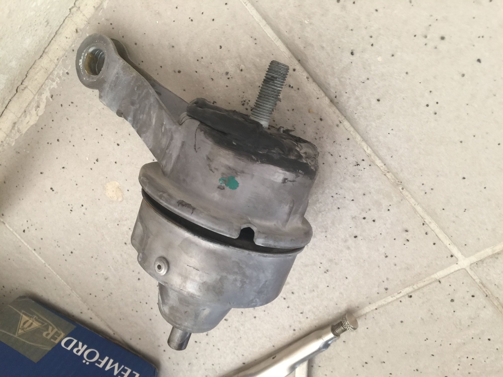

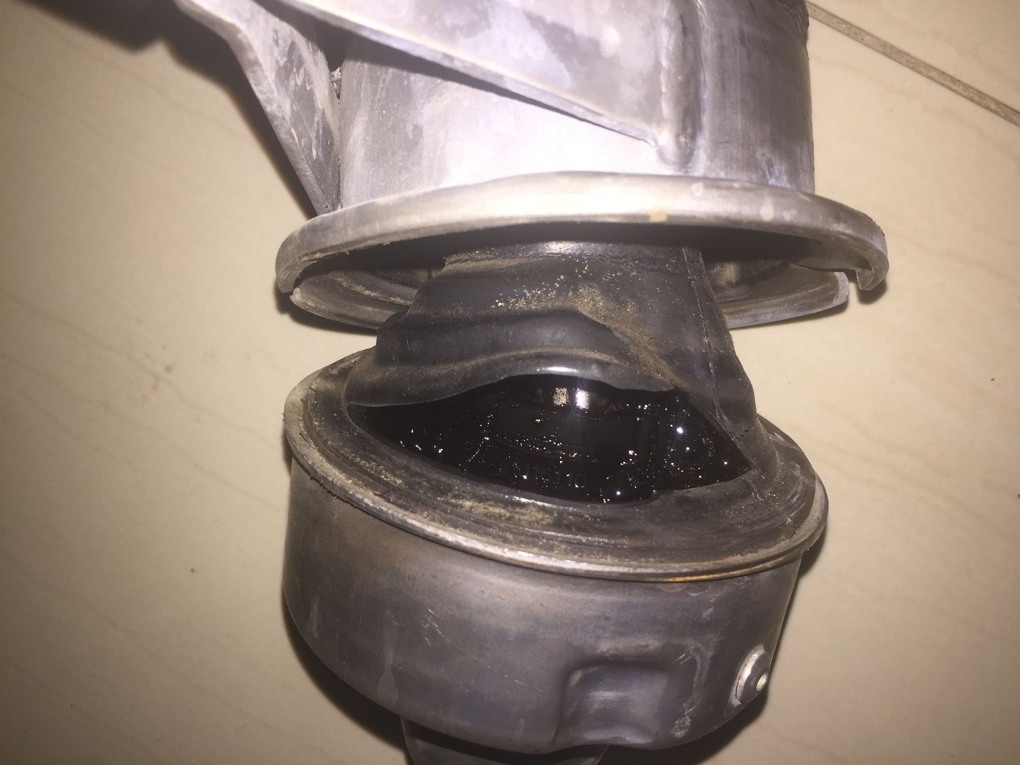

Quick update on hydraulic engine mount install - fairly straight forward I thought - only niggle was having to remove the bracket from the engine as I couldn't fit my long socket in the tight gap for the bolt that goes into the strut tower section. Was originally hoping I could just undo the nut on top of the mount, remove torx bolt from underneath, jack the engine up enough and slip the new mount straight in. Anyway no major drama - done in an hour. Only other slight niggle was having a 3/8" drive E12 torx socket but a 1/2' drive ratchet - I have a 1/2 to 3/8 adapter but I could feel it twisting under the torque - was worried it would snap. Its torqued to 40lb/ft and then a little bit more.
Some pics of new mount and the old one - dissection was irresistible !

I love that you work in a garage with a white tile floor.
Mine is “crumbling concrete”....
Nicely done!
A side note: I finally got around to having the shocks changed on our base Cooper, which has only 60k miles on it. I had my shop put in the Koni FSDs, and replace the upper shock supports, both front (bearing assembly) and rear (mount and bushings). I should have done this a long time ago, the change is that dramatic for the good. If you are ever looking to upgrade ride and handling, these (or their latest variation) come highly recommended.

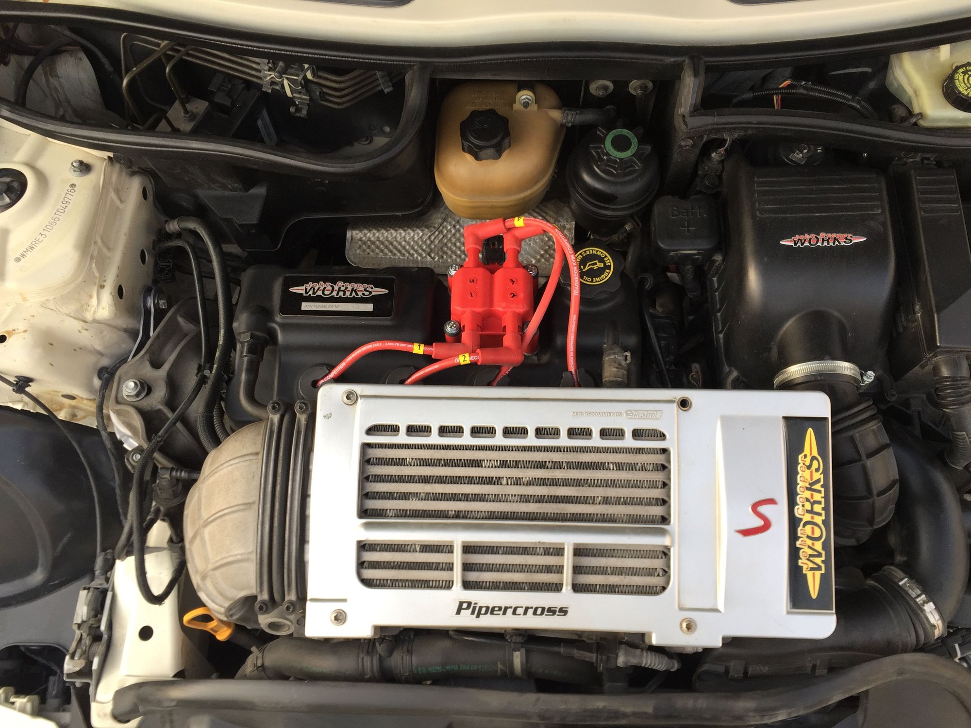

Anyway - fitted the new coil pack and HT leads last night - pics to follow.

Update - fitted the new MSD coil pack and Magnecor HT leads last night. Another relatively easy job - just almost forget to disconnect the battery. The Magnecor HT leads are an excellent fit and are slightly shorter than the OEM ones and hence do not get cooked from sitting on top of the engine all the time. The date on the old HT leads was 2005 and presumably the coil pack was the original one too. Initial observations are that the idle is much more stable - previously I had pretty bad intermittent misfire and occasionally very rough idle. It had randomly cut out on me a few times too. But after the install, all seems good, steady idle at about 800 rpm - no more jumpy idle. But it still takes a good few seconds to start from cold or hot. The old coil pack was corroded on cylinder 3 and 4 terminals- strange why only 2 are corroded and not all 4 - another Mini quirk ?
I might check the spark plug gap on the new Bosch plugs, just to be sure - but I'm pretty sure they come gapped from the factory.
So, Gentlemen, what is the current thinking on best spark plug gap ?
